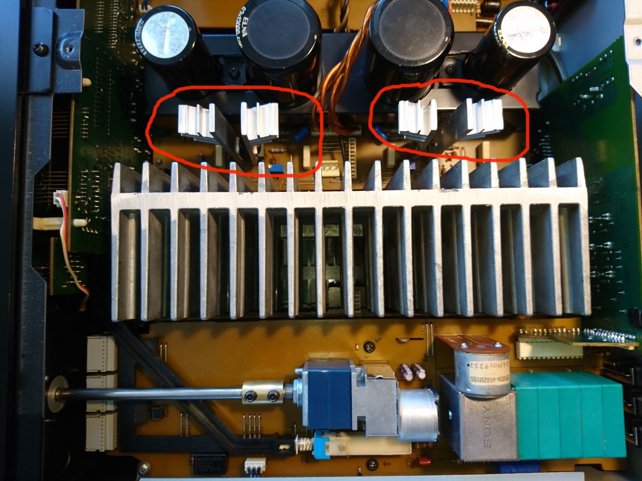

erratum: Both AM-U5 and AM-U7 open loop amplifiers had separate windings, rectifiers, filter caps and also higher voltage rails (regulated!) for the VAS. AM-U5 had +/- 50V for the VAS and AM-U7 had +/- 65V. Both enough for shocks when measuring. Unfortunately the low voltage phono stage did not get separate windings so its +/- voltage was derived from the VAS regulators. This was very often done at various brands but dropping +/- 65V to +/- 24 and even +/- 15V causes heat. The AM-U7 therefor had way hotter PSU transistors that died from the heat certainly when the upper cover was covered with stuff. No product is without imperfections, never take remarks by techs too serious as these usually see mainly defective stuff. It becomes interesting when there is a repeating pattern. The beautiful large volume controller WAS such a pattern.
