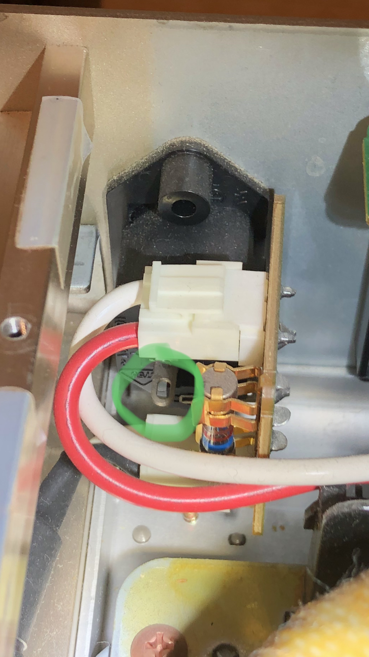

Great catch, many thanks! Sony is floating ground as well, seeing 3 prong plug I blindly assumed it was grounded, but you're right, it is floating as well. And it has double box symbol indicating it is floating in the backside as well. I checked for schematic error and the pin is really not connected, so schematic is correct.

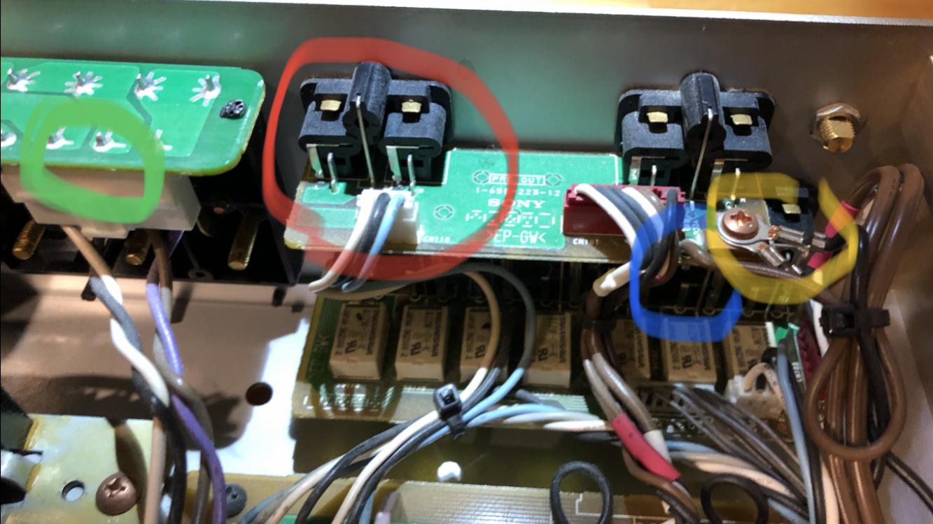

I also checked the grounding of pre out board and it seems to be solid (see markings in attached foto), all 0R resistance:
- pre out RCA ground shields (red mark) to speaker minus (green mark) - 0R
- pre out RCA ground shields (red mark) to pre out board grounding point (yellow mark) - 0R
- pre out board grounding point (yellow mark, black wires) to both main board connection points - 0R
- pre out board ground connection (blue marking, brown wire) to input board grounding point - 0R
As the grounding seems solid, the cause are probably transformer leakage currents between the amps.
