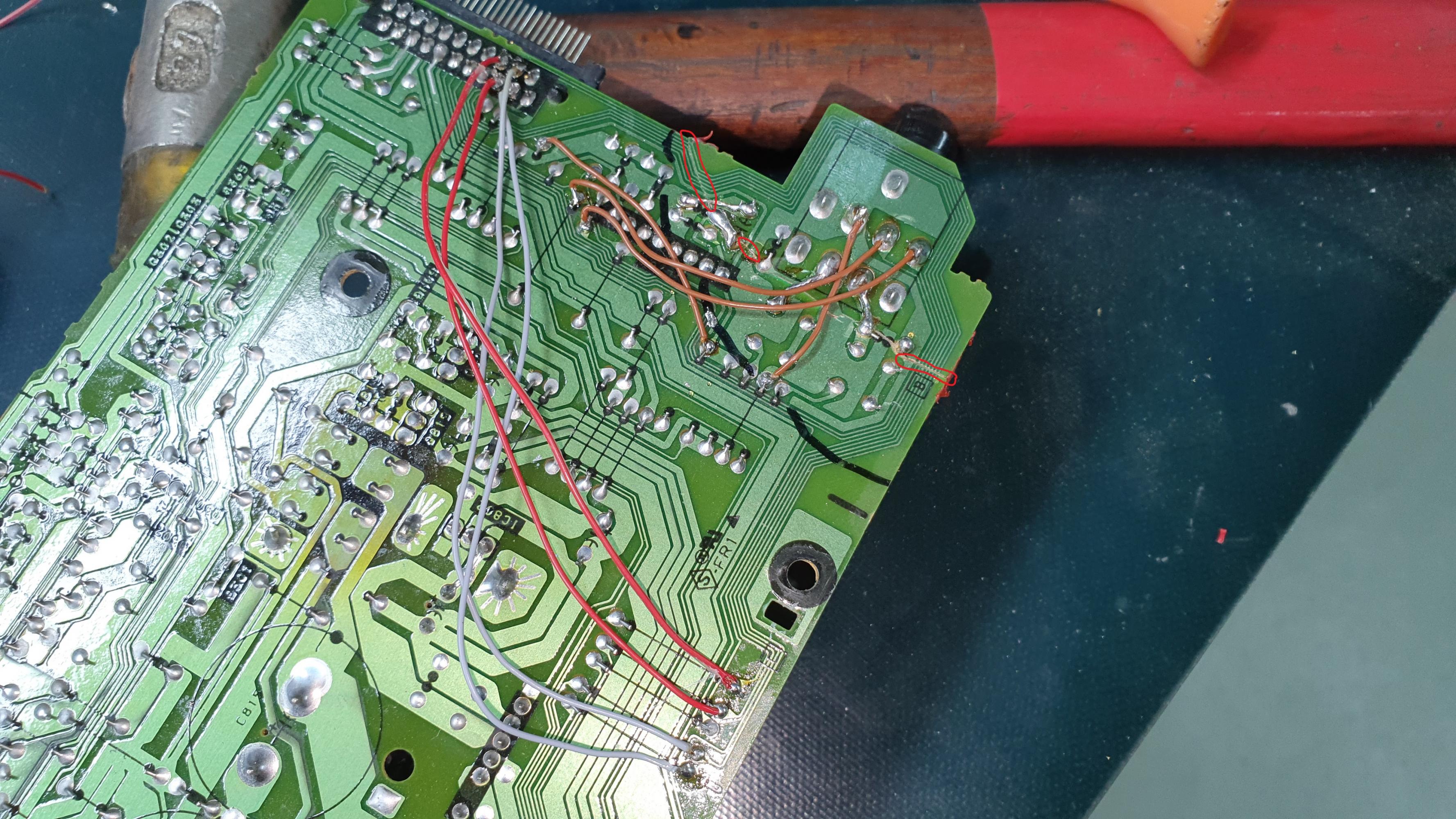

I tried to integrate the BT module today. I confirmed that AC OFF MUTE pin has +4.2 V when turned on and 0 V when on STANDBY. I connected the BT module to that "AC OFF MUTE" pin because I wanted it to turn off when I turn off the amplifier. Seems that this one is not intended to power up anything so the module didn't power up and the microcontroller got confused; the amplifier was on but it was not possible to use any controls. Then I've connected it to +5 V right after the stabilizer but the module introduced a lot of noise and the audio was distorted for some reason. I will have to plan this better so I gave up from the idea for now.
But the amplifier is not working again; the protection kicks in all the time. I tried to kick it with the screwdriver handle 😛. It seems that the relay contacts are definitely old, when I move the relay or kick it, the sound cuts off or it gets quieter or it gets very distorted. I also blame the relay for occasional distortion in high frequencies. But it didn't affect the protection coming on/off. Once the relay disconnects the speaker, I can kick it as much as I want, it will connect them again only if I turn down the volume, so it's not the relay.
I tried to move the boards on the transformer to see if there is some bad connection somewhere. At some point, both fuses on the secondary blew 🙄😡😀 I replaced them, tightened all the connections and tried again, no help; protection is still kicking in.
Then I got mad and started kicking the board everywhere and found something interesting; there's a part of the board near the protection circuit, where two resistors and two jumper wires are. When I push/kick them, the protection kicks in immediately. My first thought was that, since this is near the broken part of the board, I'm pushing the broken part and some connection is lose. But no, if I push the board anywhere else other than that resistors and jumpers, no reaction. So it has to be a bad connection or defect resistor. I will try to replace them tomorrow. This resistor is located in the OVERLOAD path to the protection IC.
I'm slowly getting tired of this amplifier. Today I decided to do some work on it. I've replaced many capacitors, practically all that I can find brand new at home. I've also re-soldered many connections on the board, especially near the part which is sensitive to pressure. I removed the relay from the board, removed the plastic casing, cleaned everything with isopropyl alcohol and then returned everything back. I've found two errors that I've made when I was overriding broken lines on PCB via wires and I've fixed that. I've cleaned the whole board with isopropyl. But the damn thing is still acting the same. No matter what I do, it always fails. Now I'm starting to thing that the uPC1237HA might be defective.
Now I took the board to house altogether with multimeter and I will try to look for more errors/missing connections on the broken part of the board.
Do you have any other idea maybe?

Yes I have...take a break🙂
In the future, never "fix" multiple problems at once...focus on the main one and only then on the next...step by step.
See if there are cracks thinner than the hairline on the pcb lines which can only be seen with a magnifier and a slight bending of the pcb.
After a long pause, during which I was finishing a project that I've started years ago (Raspberry Pi based network audio player running Volumio with 20x4 LCD, Arduino and IR remote), I've finally managed to fix this Sony. The PCB line which connects pin 2 of the protection IC and corresponding resistor and capacitor was broken. After I've fixed this one, now it works fine. I've also tested the PHONES output and it works fine as well. Final pictures:
I've also glued broken front plate:
And then, as stubborn as I am, I decided to proceed with my idea of adding a relay to cut the 26-0-26 AC outputs from transformer, to prevent all parts of the amplifier being powered on all the time (the microprocessor on stand-by just turns off the speaker output via the same relay as for protection, and the preamplifier). So I've found a +5V rail active only when microprocessor is not on stand by, I did some drilling and I've added the relay:
Unfortunately, seems that this 5V rail is not strong enough to power the relay. Not only the relay is not turning off, but the microprocessor gets also "stuck". Now I need to find some other +5V for this, or I will have to add a transistor to control the relay.
