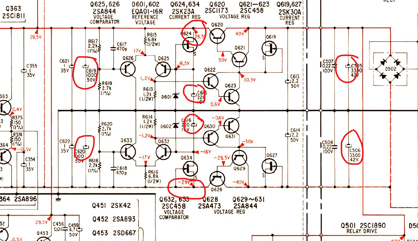

The preamp has seen some servicing, some caps have been changed, but not all. To me, it sounds like a failing old cap that is charging, but looking at the schematics, after the 5-6 second mute sequence from the moment you power it on, there are three small caps on the power supply board that charge and those caps have been replaced.

All that points to a PSU issue. You need to check these caps and also check the -/+29 volt rails are correct when the issue occurs. The phono stage has a similar PSU at lower voltage but your description suggests most likely the -/+ 29 volt reg is the area at fault.
Those caps were changed by the tech who serviced the preamp. He also checked the voltages. Unfortunately I do not have any tools available, I rely solely on the tech that did the repair, but since we're both stuck and can't seem to figure out what's wrong, I decided to ask maybe you guys have some other perspectives

Had the same issue with my E86, both 3300u caps replaced (it was the neg-one!) & solved. This main +/-30Vdc regulator supplies the md-phono, line and BBoost amps.
Check for the other regulator +/-9Vdc circuit for the MC amp (on the phono board) - if there a main cap is overaged the common transformer is drowning.
These regulator circuits are both on the main pcb, and are wired under the pcb aka ground floor - so check for solderings also... ->
