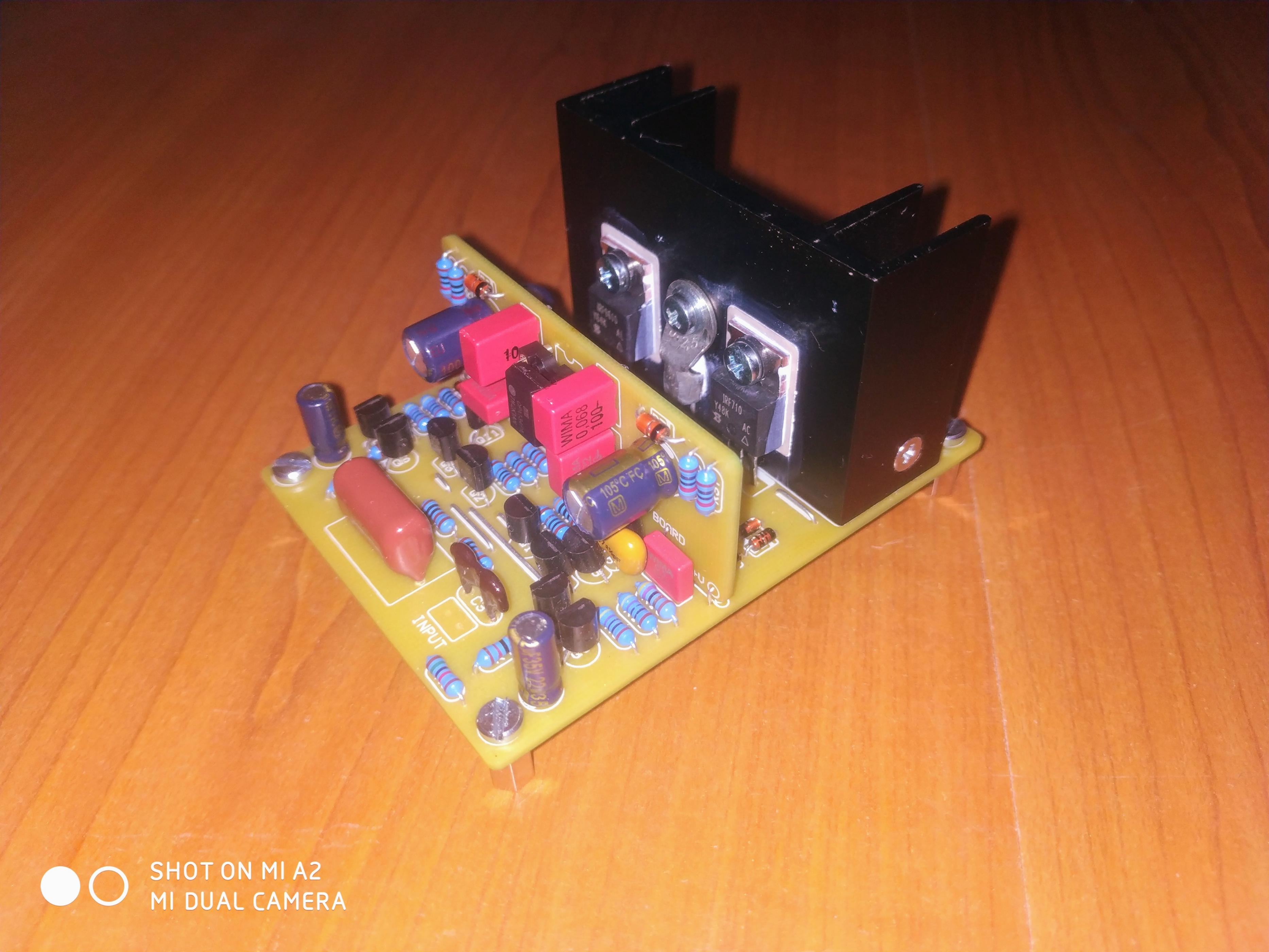

Victor, I want to assemble this power supply, and I have a couple more questions for you:
I don’t understand how stabilization of the voltage at the output of the power supply occurs. And what role does the TL431 with the BD140 transistor play? I am not familiar with the inclusion of TL431.
In the circuit of transistors Q1, Q2, Q3, which are connected in parallel, I also do not see voltage-stabilizing elements. I'm just trying to understand how critical this power supply is to the input voltage (AC 24V). In what range can the input AC voltage lie?
NPS1 is shunt power supply.
TL431 Shunt Regulator Circuits
NPS1 is very sensitive to the input voltage. For 22.5V DC output voltage, input voltage must be from 21 to 24V AC(depending to mains voltage) and try to keep voltage from emitter to collector(+V) Q1 in the range of 5 to 10V DC. CCS value is 65mA and is set with R11,R12,R13. If you multiply 65mA with 5V(emmitor-collector voltage Q1) you will get 325mW. Divide that with 3(3 transistors) and that is around 100mW for each transistor. If you have higher voltage difference, let's say 10V DC, then dissipation for each transistor(Q1,Q2,Q3) is around 200mW.
Thank you, Victor, for the information. Most likely this scheme will not suit me. I need a not complicated power supply, which will be enough to power this pre-amplifier. Of course, I will not design PSUs with LM78 ** / LM79 **, or 317/337, most likely I will look for a circuit similar to NPS2, but a little easier.

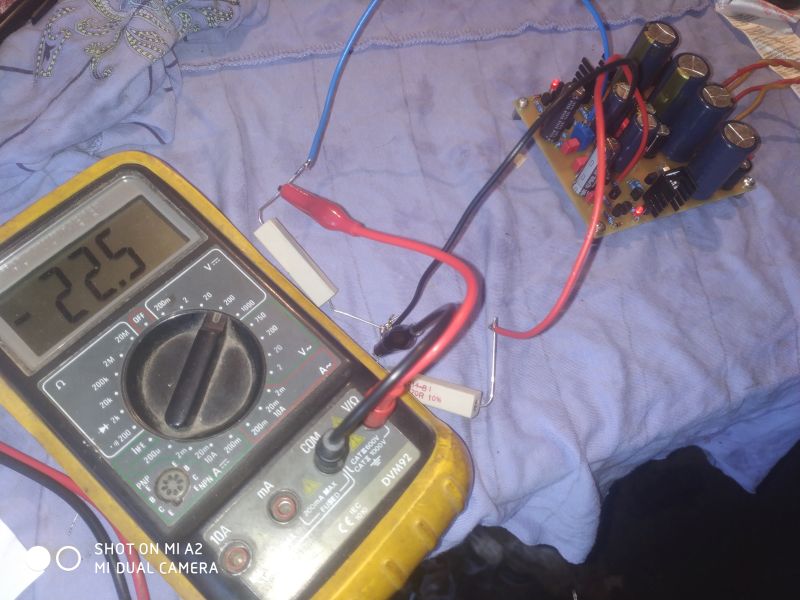

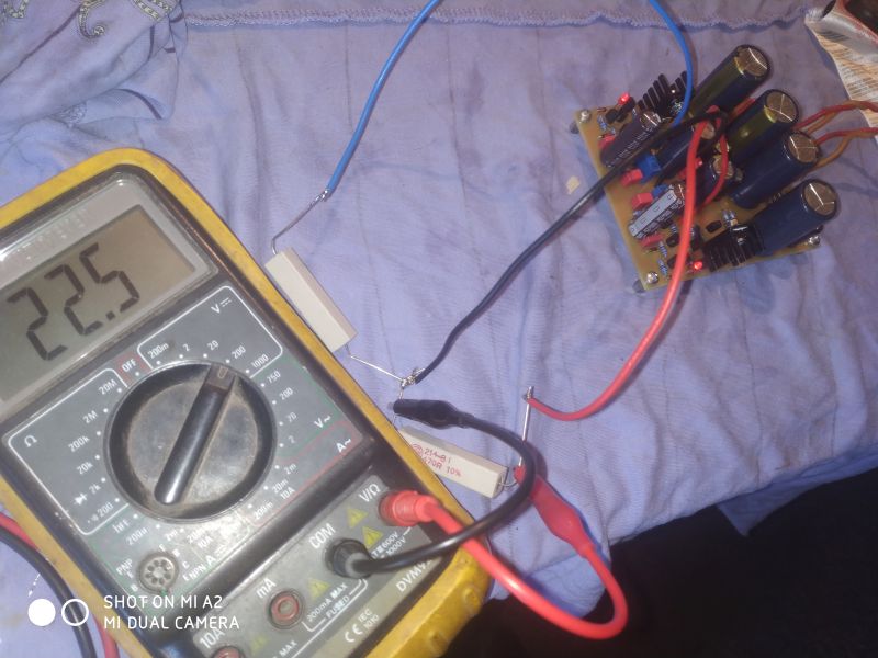

I am currently working on assembling power supply boards.

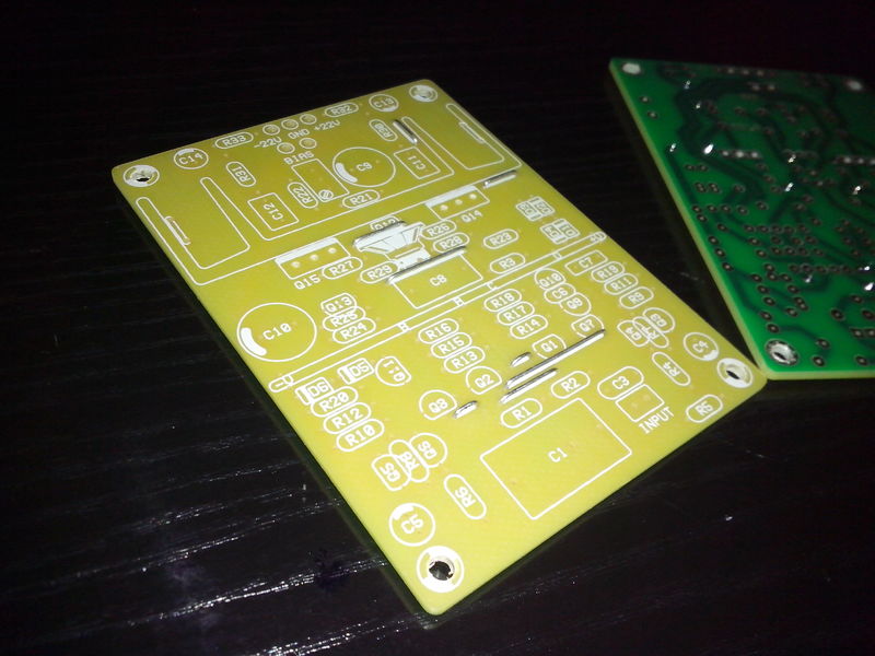

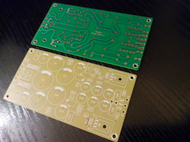

I have problem with conversion from protel to pdf file. Problem is only when I want to convert pcb file to pdf file, with schematic file I do not have problem.

Hello Victor. I am looking at the NPS2 power supply circuit. Please tell me what is the power of the constant resistors R3 ... R6, R7 ... R10 and R27, R28. I understand that the rest of the resistors can be set to 0.25W?
All resistors are 0.6W metal film
