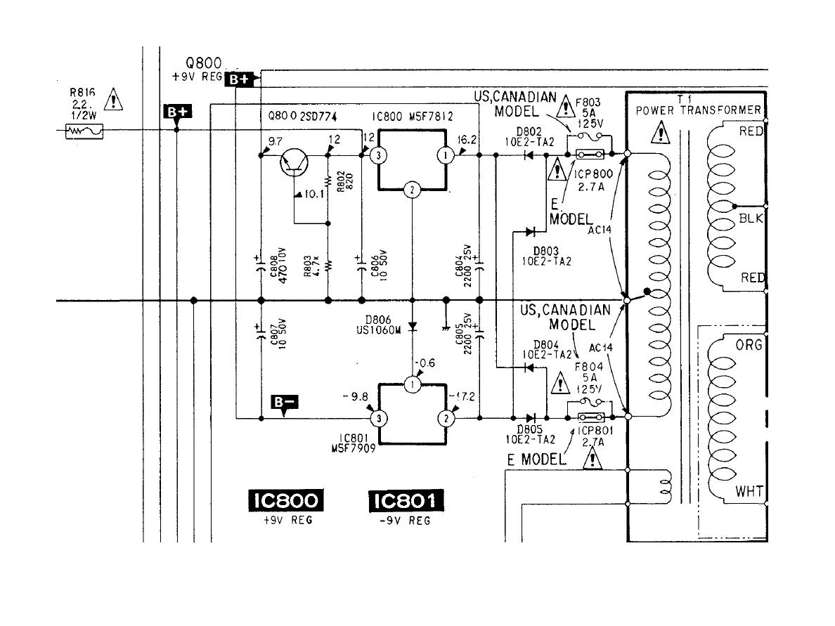

schematic of your amplifier has been a problem to locate ...i ve been checking though some other similar models of the same time and it seems that in the secondary power supply there is either a fuse or a fuse resistor if its a resistor it should be 4.7 R and coloured from left to right yellow -purple - and 2 stripes of gold or silver
check on this with reference to ground to see if voltage comes in and out of it .... in the closest schematic te above was named R406 and R407 for plus and minus...
there is a remote posibility that these are not transitors on the regulator area but are simple regulators in this case in the negative regulator and always with reference to ground you need to measure
pin 1:-0.6 volts
pin 2: -17.2 volts
and pin 3:-9.8 volts
most imprtand is to see that the input of the regulator has the -17.2 volts ...if not replace fuse 804 or a part that is named ICP 801 ...the above is a special type of fuse but you may as well replace it with any normal fuse rated from 2.5 to 3A

Mooly:
It is marked 7909. There is no short between any of its legs. The two resistors next to the 4 diodes read ~5.2Ohm each.
Sakis:
ICP801 is one of the two resistors measuring 5.2Ohms that Mooly had me measure... next to the four diodes.
7909 - IC801 reads:
Pin 1: +0.60v
Pin 2: -17.64V
Pin 3: -0.16V
It seems strange that pin 1 is POSITIVE 0.6v and not negative... Could this be the issue? Or maybe the 7907/IC801 is fried?

EDIT: Sorry I think I got my pin numbers reversed as far as 1 and 3 go.
I think Pin 1 is actually -0.03v or so and pin 3 is +0.74v after retesting. The striped side of D806 matches -.03v and the unstribed side reads 0v.
Seems the pin 1 voltage is low... should be -0.60v and its near 0v in this test, was -0.16v before.

replace the regulator 7909
(alternative check if any hot while operating which will be an indication of short circuit somewhere in the output of the regulator )
CHECK SOLDERING .... down under it could be that simple ....but other than that just replace the regulator ...

It isn't a concern that the voltage of pin 1 is -0.03v to -0.16v instead of -0.60v? Should I be replacing the same regulator on the +9V side for consistencies sake? Thanks!
By the way, IC800 on my board is numbered 7809 not 7812 as indicated by that schematic.
yeap ...the schematic is from another amplifier ...but similar
just replace the regulator ....and or check soldering

Just replace the reg -17 volts in and nothing out = duff
Any marked 7909 type will be OK... however it's not the most common value around so if you struggle to find one locally get a 7905 and a small wattage 4.7 volt zener and you can "make" a 7909 by adding the zener to the ground connection replacing the diode already there. Make sure it's a 79 not 78 when you buy.
Now if it were me I might look to replace the caps that feed those regs, that's the electroylitics near the regs C804 and C805. Wonder if it runs a bit hot around there.

well in all these repair years ( over 30 ) never had to replace a regulator in all my life ...may be one or two ...i am pretty sure that from two the one should be on a tv and not an amplifier
i am pretty sure that this might be a soldering issue but this is for the OP to find .... at least an 7909 cost next to nothing so trying will not be costly ...

BTW Sakis, I resoldered the 7909 since it was cracking at the bottom... probably from me moving it so much to get a read. Same result though, no good. Will let you guys know what happens.

Sakis, regulators can fail... I had a defective 78M24 in a Marantz PM-35 amp that I got non-working from Freecycle... other than some cracked solder joints it was the only fault. It would sometimes work too, which was strange, but it ran really hot. The replacement 7824 that I fitted however runs cool - strange!
While I am waiting for the 7909 to come in, I was thinking about replacing those two caps that feed the reg's C804/C805... They read 1000uF and 25V. Should I replace them with any aluminum cap of the same value, or should I be looking for something special. I noticed there are some 10000hr vs 2000hr caps etc... I'd probably look to get the longer life, but besides that?

before replacing and that will be short of un upgrade thing.... it will be wise to check if any of these caps had drifted from original value ( can be easilly done with a capacitor meter even the ones with 15 USD that will not be acurate but at least provide an indication of the situation )
the point is that capacitor failures are epidemic meaning if one is drifted or leacky expect more if not all ....
