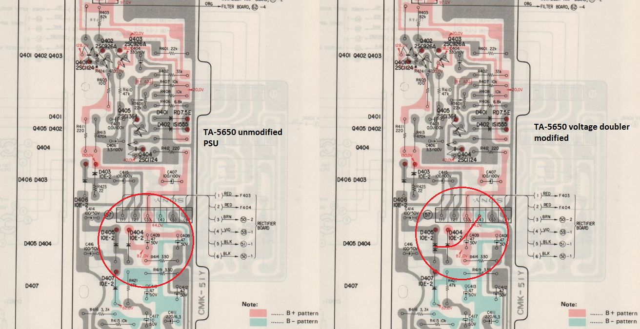

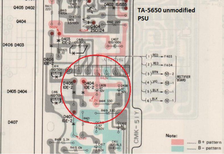

In the process of restoring a TA-5650, I've read about unsymmetrical loads causing the power supply to fall on its face in the ta-4650 and apparently the 5650 has the same design flaw. I have yet to fully finish mine and test this to see if its an issue on mine but i figure i should do the mod as a preventative anyway as i want this unit to be as reliable as possible. I can find info on the mod for the 4650 but not the 5650. I've created a modified version of the schematic to show where i think the extra diode needs to go.
This will unbalance the + - 82V rails and upset the drivers. The reason they fail is the two pump capacitors go high ESR. No other reason.
If your 'mod' was a Sony 'mod', I would have picked it up in the training sessions.
Thanks for response, glad i seeked more information, i didn't create this mod it was one that has been discussed a lot in other forums. Quote from another forum regarding a 4650, the diode mod apparently was designed to rectify this, there was some mention of the same thing in the 5650 but no one went into more detail. If all it is though is the pump capacitors the whole unit has been recapped so that will no longer be an issue for me anyway.

"The +/- 75 Volt changes slowly to +83V/ -67 Volt."
You will still have this problem because without the VFETs fitted the driver stage has to source current to the output, including the ripple compensation networks and feedback. Without the diode mod the whole driver voltage generator is essentially floating between the main power supply rails so very little current imbalance will upset the driver rail balance. When the VFETs are fitted, only a very small fraction of this remains as most is sourced by the VFETs from the main power rails, but a small imbalance still remains.
The real problems here is that if anything overloads the bias supply, it collapses (also reverse polarizing some caps in the charge pump) and this is shared amongst the channels. Even hard clipping can do this and in fact a failure on one channel may easily result in the other failing too. Diodes from +44 to +85 and -85 to -44V should also be fitted to secure the best performance of the charge pump.

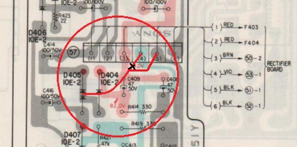

@ilimzn after reading post by both you and Joshvi i regard both of you as knowing a lot about these amps. Would it be possible for you post a modified version of the schematic to show where you recommend extra diode placement?. I'm mostly self taught with electronics and we are starting to go a little past what i know here and a vfet amplifier is not something I'd like to trust my own knowledge 100% on.
A very tired me after work didn't even notice i connected thst to -v, thanks for correcting it! anymore mods thats should be added to psu to make it more stable or is this about it?
The mod with two diodes is also a good idea.But the juntion of the diodes has to go to ground not -V !

Yes ,the junction goes to ground not -V
Awesome, i shall implement the mod soon then hopefully i can get this thing up and running once the vfet i need arrives. I've also got to work out whats going on with the source to gate voltages without the vfets installed. When tested with the bias set to max they would only reach around 5v. I haven't gone any further into testing yet, that was just a brief test after i finished recapping etc.
