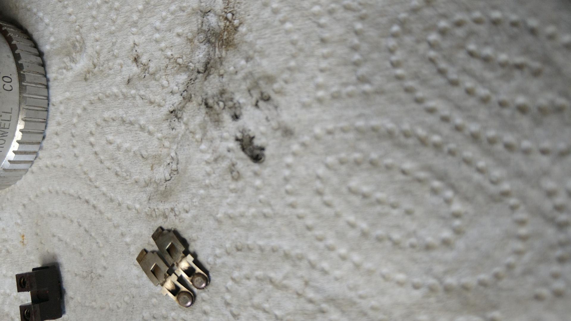

FIXED!
Hi Guys,

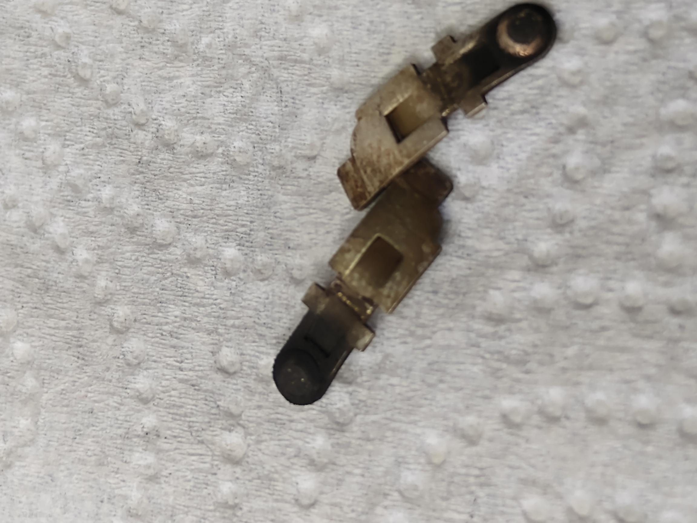

Well... often problems are more simple than we can guess... The issue of popping speakers in the Sony TA-4650 / 5650 is solved! Carefully opening and cleaning the very dirty contacts inside the power switcht solved the issue!
Putting the power switch back together is quite a challenge. There are two bent contact bridges and two tini springs and plasic pieces that switch the bridges... Don't drop them!!
If I do a next one this weekend, I can post some more pics from inside the power switch. I will be looking for a replacement switch, but they will probably be hard to find.
Most important: The trick works!

I put all of the parts, including al of the tiny parts, in a cup with kitchen degreaser, rince them in a tea strainer and let them dry on white kitchen paper. And use interdental tooth brushes for cleaning the parts.

I have done several powerswitches now and they all are very dirty. some of the contacts are really worn out. To see if the wearing causes the left over minimal popping, I have ordered some replacements to see if this makes the popping go away completely.
If anyone has any advice on matching replacements... please let me know. The ones I found will probably not fit very well in the amplifier.

Put small -10 to 12 mm 275 volt MOVs across line and neutral on the load side of the switch.
Improves contact life greatly.
