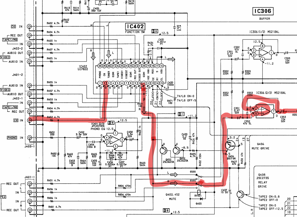

Thanks. I can't be 100% sure it's not a poor joint still but poking and tapping everything on the main board didn't seem to change the behaviour although I can't really tap the tone board when the front cover is on. Swapping is a great idea, it's fairly easy for me to use jumpers to swap the L and R when the signal comes back from the volume board which would isolate it to the power amp if nothing changed. Just a quick question as I am looking at the diagram here. Is what they're calling "buffer" the op amp? I'm trying to educate myself more on how amps work. After this, the signal heads to volume board -> tone board -> volume board -> main board and into the power amp circuit.
IC 402 = LC7822 is your input selector swithc.

Yes I suspect it's in the power amp too. I don't believe there are any pots anywhere in the circuit besides the volume, tone and balance knobs. Here's the power amp, excuse my highlighting but do correct me if I haven't drawn the correct (simplified) signal path.
There isn't really a simplified path with an amp like this, it all operates as a whole and the audio signal within the amp can look unrecognisable at some points. The path to the right of the input stage is really the negative feedback path. The voltage gain is the value R762 divided by R761 plus 1 so it comes in at (30000/220)+1 which is 137. So if you apply 100mv peak input you would see 13.7 vol;ts peak at the output.

Just waiting for you to get your scope, to hear if you have signal "OUT" to both channels from IC402 (LC7822) 😉
I don't think it will come for another week. I'll go throw it up on my main system to see if it acts up.
It did start acting up this morning while leaving it on the fm tuner and tuned to a station. I went upstairs and it was sitting in protect mode so I brought it back down and plugged it in to crappy speakers and it started popping. Volume knob does not affect the popping loudness. I took out the connector board between the volume board and main board and switched the L and R out from volume board and the popping was still in the right channel so it must be in the power amp. Can't wait for that scope to come.
