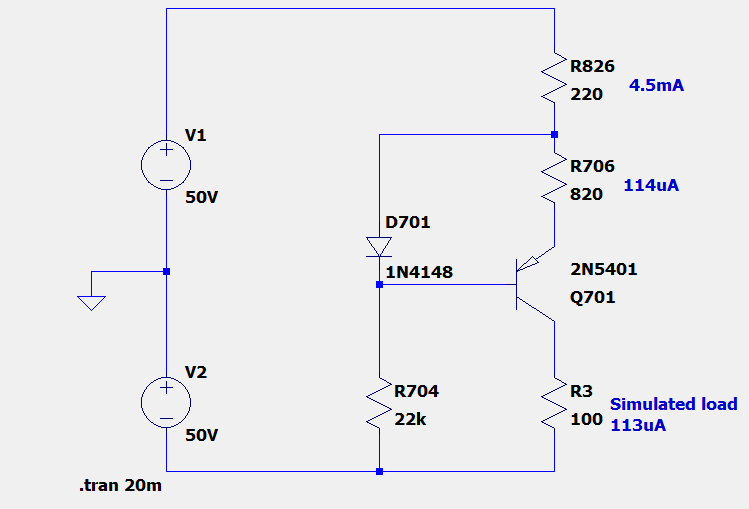

You definitely have a short or overcurrent situation somewhere. D701 and R826, along with Q701 form a constant current generator that's driving your long-tailed pair input amplifier. This is the most delicate part of any amplifier and errors here will have big downstream effects. Did you measure the indicated voltages (48V, 49.5V and 50V)? They need to be very close to spec! This is a prime example why you can't just villy-nilly replace components. The original diode was probably carefully selected to provide the correct current through the LTP. And I can assure you that this diode has NOTHING to do with hum. Understand what role a component has in a circuit and THEN think about whether you should replace it. If you have the original diode, I urge you to put it back! Also, put back the original Q701, since it must be matched to D701.The dim bulb tester stays dark, so I don’t suspect a short.

Also, this indicates that something is SEVERELY wrong, as in a component is oriented the wrong way or something equally catastrophic. Here's a simulation of your original modification with a single 1N4148. I replaced your LTP with a load resistor. It's not going to affect anything, since it's a constant current circuit. The current through an LTP in an audio amplifier is typically of the order of 100-300uA. The current through R826 is that current, plus whatever current flows through the diode. R826 and R704 must drop 100V, minus the diode drop, so let's call it 99.4V. So 99.4/22220=4.47mA. Add the current through the current generator and we land at about 4.5mA, which matches the simulation.
- The 220Ω resistor at R826 burned out, and a new one overheats quickly.
But you said you were able to make the resistor smoke with a single 1N4148. Assuming standard 1/4W resistors, let's calculate how much current that would require: P=I*I*R, So I=sqrt(P/R)=33.7mA. That's 7 times the current you're supposed to have! And I don't think a 1/4W resistor really smokes at 1/4W, so your current is probably 10x too high! And adding another 1N4148 should INCREASE the current, not decrease it. So something is very wrong here. Go through every part of the LTP and its current generator and you might find ONE of the probably many issues you have. Measure the voltage drop across R826. If it's anything other than 4.5e-3*220=1V, you have a big problem in this part. Measured against ground you should see about 49V there.
(BTW, I don't agree with the schematic that you should see 48V at the emitter of Q701. There must be a BE drop there, so you should see 48.6-ish volts)
I used a generic 2N5401 in place of the transistor you used since I didn’t have a SPICE model. It’s shouldn’t make a big enough difference in this particular case.
With two 1N4148 in series you should have more current. But it’s past my bedtime now, so I’ll calculate it for you tomorrow. 😀
And there’s (at least) one error in my post: LTP tail currents are usually more like 500uA-1mA. So a single 1N4148 might have caused the amplifier to misbehave, but it should NOT have caused R826 to smoke. It would actually cause it to draw a little bit less current.
Bedtime got delayed. 😀With two 1N4148 you should have about 850uA through the LTP. You would then have about 5.3mA through R826, so it should drop 1.2V.With two 1N4148 in series you should have more current. But it’s past my bedtime now, so I’ll calculate it for you tomorrow. 😀
