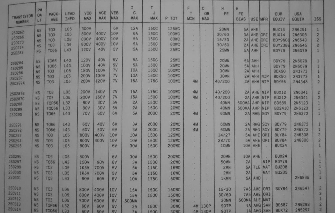

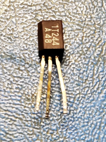

I managed to damaged Q802. The search for a replacement is starting. I know the gig by now...

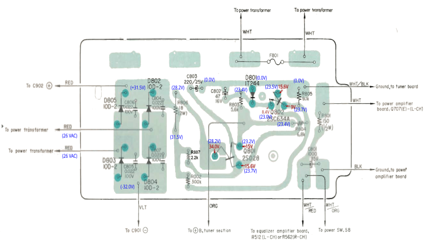

There is something I quite don't understand:
Mooly said:
We add R807, the 2.2k. That turns Q801 on fully and we get the same voltage on the emitter as on the collector.
The output of bridge rectifier gives me 31.5 V. This voltage then goes through R807, the 2.2 K. The voltage is now 23.3 V. Using the formula v=ri, I should rather have 31.5 - (2200 ohm*0.00096mA=2.1V)=29.4. Current seems to be 4 time higher in this part of the circuit because the drop is 31.5 - 8.2 =23.3V.
In reality, I need a drop of 15.9V. I'm wondering how this amp ever got this value when it came out of the factory!
Here is an improved schematic view to help the discussion:

These are text book generic circuits. TIP41C (I know its a different package) or similar for Q801 and any suitably rated small signal for Q801 such as a BC546, 2N5551 etc. Watch the pinouts though.
It doesn't matter what the bridge voltage is 25 volts, 35 volts, 50 volts. The regulated output will not change.
That's not really correct 🙂 the voltage is applied to the resistor. The load current (everything powered off the 15 volt rail) draws current and that causes a volt drop across the 18 ohm. The current transistor can supply (from Collector to Emitter) is determined to some extent by the available base current. Although the 2.2k turns the transistor on there isn;t enough current gain in the transistor and not enough base current (via the 2.2k) to deliver unlimited current.
So what happens is is the load draws current. That causes the voltage on the collector to fall because of R18. The transistor may or may not appear as fully conducting at that point. That depends on the gain of the transistor. The base voltage will always be around 0.6 volts higher than the emitter.
So we could have +32 volts on the bridge. The emitter could be at 12 volts because the load is drawing 1.1 amps. That 1.1 amps is dropping 1.1*18 = 19.8 volts across the 18 ohm. The transistor is fully on (lets assume) because the 2k2 is supplying 12.6/2200 = 5.7 milliamps into the base. The 12.6 volts is the emitter volt plus 0.6v.
We therefore have 32 volts bridge, 12 volts on the emitter and 12.6 volts on the base. The 2k2 drops 19.4 volts and the 18 ohm drops 20 volts. The transistor has virtually no voltage dropped across C and E because it is fully on.
In practice the base current may not turn the transistor fully on and so some voltage would be lost across C and E. That depends on the transistor and its gain.
Q802 in the full circuit conducts just enough to maintain the set 15.9 volts no matter what the bridge voltage and no matter what the load.

The transistors should be easily replaceable with generic parts, the only issue being a different package outline.
If the TO66 packaged Q801 is mounted without an insulating kit (meaning the case which is the collector is in direct contact with the heatsink) then you can just screw a flatpak type like a TIP41 onto the heatsink, two wires to base and emitter and its good to go. The metal tab of the flatpak is the collector. If it is insulated then you would need an insulating kit (mica washer and insulating bush) for the flatpak.

I found a small transistor for Q2 (BC549B) which is under spec but given the current and voltage the simulator gives me, I think it is fine.
