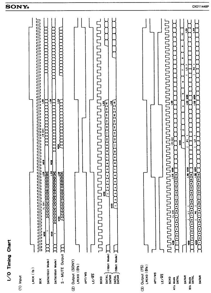

Simple inverse:
PlasticIsGood,
look closely the timing chart ,
in the DATA L row of I2S 8fs mode , it is annotated L1 R1 L3 above the chart.
and DATA R have R0 L2 R2 annotation.
it means the DATA L contains odd number of samples of 8fs signal and DATA R contains even.
one DAC of CDP-507ESD feeds the DATAL and WS/APT (and BCK),
the DAC outputs L1 and R1 at the next BCK from negative edge of WS/APT.
another DAC feeds DATAR and LE/\WS, then outputs L2 and R2 at the next BCK from negative edge of LE/\WS.
this is just the mechanism you presumed.
