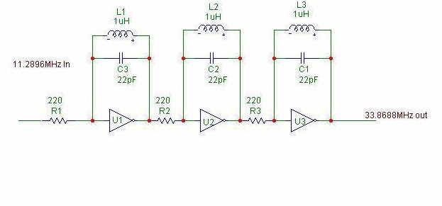

I recently acquired a sony scd-xb770 sacd player and am planning to install a new clock. The master clock is located on the audio board and runs at 11.2896MHz and clocks the 3 multibit delta sigma dacs directly (CXD9658N) and then is multiplied by 3 to 33.8688MHz for the DSD decoder IC (CXD2752R) The multiplier uses a 74LVU04A with a cap (22pF) and inductor (1uH) parallel resonant circuit connected directly across the input and output of each of 3 inverters, the inverters are then connected in series through small resistors. Obviously these filters must be tuned to the 3rd harmonic of the master clock. Does this circuit achieve a good lock to the master clock? I am a little sceptical actually.
What I am wondering is just how jitter prone is this clock multiplier circuit and given that I am not going to be using the dacs on the audio board much once I tap the dsd stream would it make more sense to divide a 33.8688MHz master clock down for the dacs?
Also does anyone have any information on the CXD2752R or the CXD9658N? Data sheets or/and crosses to non-proprietary part numbers?
See the schematic below:

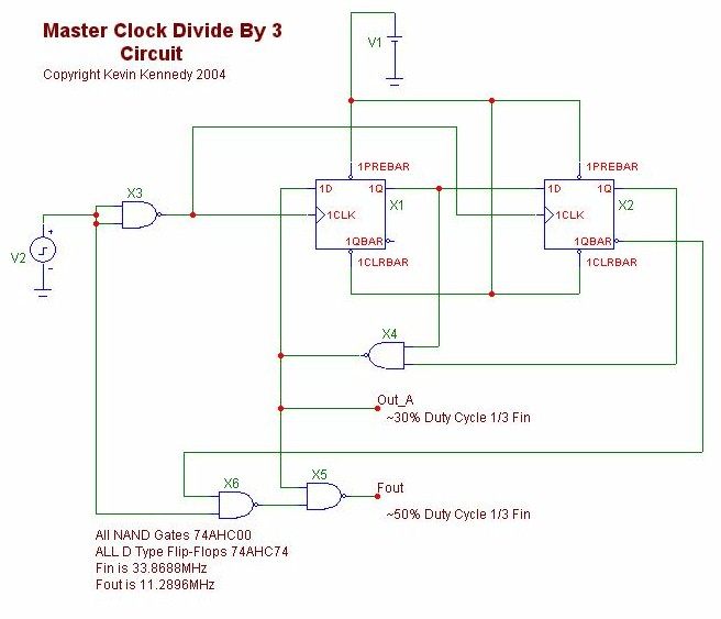

Personally I would go for a low jitter 33.8688 MHz clock and divide by three with two D-type flip-flops. Horowitz page 513.

I will use a two stage synchronous counter use an AND gate and AND the Q outputs. I initially thought to use JK type flip-flops, but noted that the 74HC74 D type clocks on the rising edge of the clock. Also what about the duty cycle of the divided clock?

Came up with d type implementation. Short of unexpected gate delays I should be able to get 50% duty cycle clock if that matters, otherwise edges are in right place on alternative output.
Circuit has been heavily simulated, does not seem to be particularly sensitive to clock speed within the allowed limits of the devices used. Note I have not yet built.. Will design pcb using smd passives and soic package logic.

VHC logic is giving less glare in digital circuits than AC or HC logic. The 50% duty cycle is probably not necessary as the player would also work with the 30%.

Hi Kevin,

Thanks for the tips, I will look into the vhc logic family. I thought it was probably the case that the clock inputs are edge triggered. One more thought: is there any reason why I couldn't just have two separate XO with the required frequencies and not use the divider at all? Cost wise for me this would probably be a wash...

Hi Kevin,
Yes edge triggered.
I am afraid the two clocks must be synchronized.
Hi Elso,
I thought this might be the case so I will proceed with my divider as planned, and I will use the newer VHC series logic in my design..

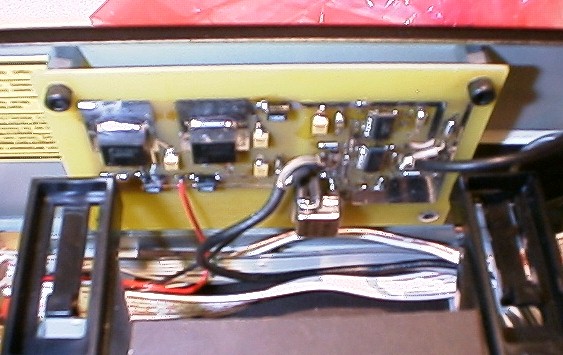

Yesterday I installed the board I made and connected the 11.2896MHz output to the dacs and 33.8688MHz master clock to the main board dsd decoder and some other related ics.
I used the output directly from the divider which has a 30% duty cycle - my scheme for 50% did not work well due the short propagation delays throught the VHC logic I used in the design. I fortunately made this option defeatable and provided two output phases of the 11.2896MHz clock relative to the 33.8688MHz clock instead.
The pcb is installed behind the tray and I carefully removed the power supply pcb and tapped into the raw 7.2VDC unregulated supply directly at C904 to power the two fairchild FAN series regulators on the pcb. I took the ground from this point as well.
On the audio pcb I removed the 11.2896MHz crystal, the 100 ohm resistor R325 and C303 and connected the clock to the side of the crystal going to IC304 pin 1.. I used a 50 ohm shielded cable grounded at the clock board only to inject the signal into the audio board.
I tested the unit with just these changes and there seemed to be a definite reduction in grain on CD and SACD alike.
Now for the scary part - I carefully removed L803, and C852 which are on the top side of the main board, by the DSD decoder IC and R858 on the bottom side of the pcb. I injected the 33.8688MHz clock into the IC 811 pin 5 side of L803. I used a shielded 50 ohm cable here as well.
I know many here have said NOT to use a shielded cable, but frankly 12cm of unshielded wire with 33MHz and 11MHz @ 3.3Vpp near the audio circuitry does not fill me with enthusiasm.. I tried both and frankly heard no difference.
I wanted to make sure these changes were fully reversible so I removed only the parts required to make things work... There are a number of components I will eventually remove in the old clock muliplier circuit on the main board in order to reduce potential interference issues in IC811.
In terms of sound I can say there is much less grain and the bass does sound a little more defined.. This was as DIY modifications go, quite expensive, and I have not yet convinced myself that this was money well spent... (Overall cost about $150.00)
I had a lot of fun doing it, although I will say hacking around on those static and short sensitive pcb's left me feeling very anxious! This model is not sold here and replacement parts would be difficult to get.
The audio/dsd side of things needs lots of attention as well, and that will be my next focus..
Finally I may experiment with better electrolytics (OSCONS) in the power supply of the clock pcb as these are currently all tantalum smd types chosen for low impedance and relatively low cost.
