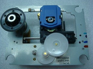

new pickup ready
I bought the new pickup today,i will try to replace it myself,cost 20 usd

i have replace the pickup,the result is still remain.when the disk is insert to the player,press sacd button,it display "TOC reading",and the disk never play.the situation is as same as the old pickup,is that to say the root cause is not the pickup but the other parts?

Um, the KHM230AAA transport unit generally costs a whole lot more than 20USD, by several factors. There are a couple ebay sellers that sell just the laser for about 90usd, and the complete transport unit can be had from other places for nearly 10X what you paid.
I was all set to email you about where you got the unit for 20 USD. But since it didn't solve the issue, and the unit was dirt cheap, maybe it's not the best.
