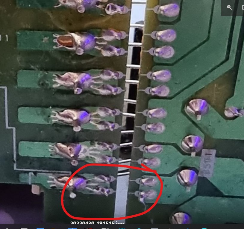

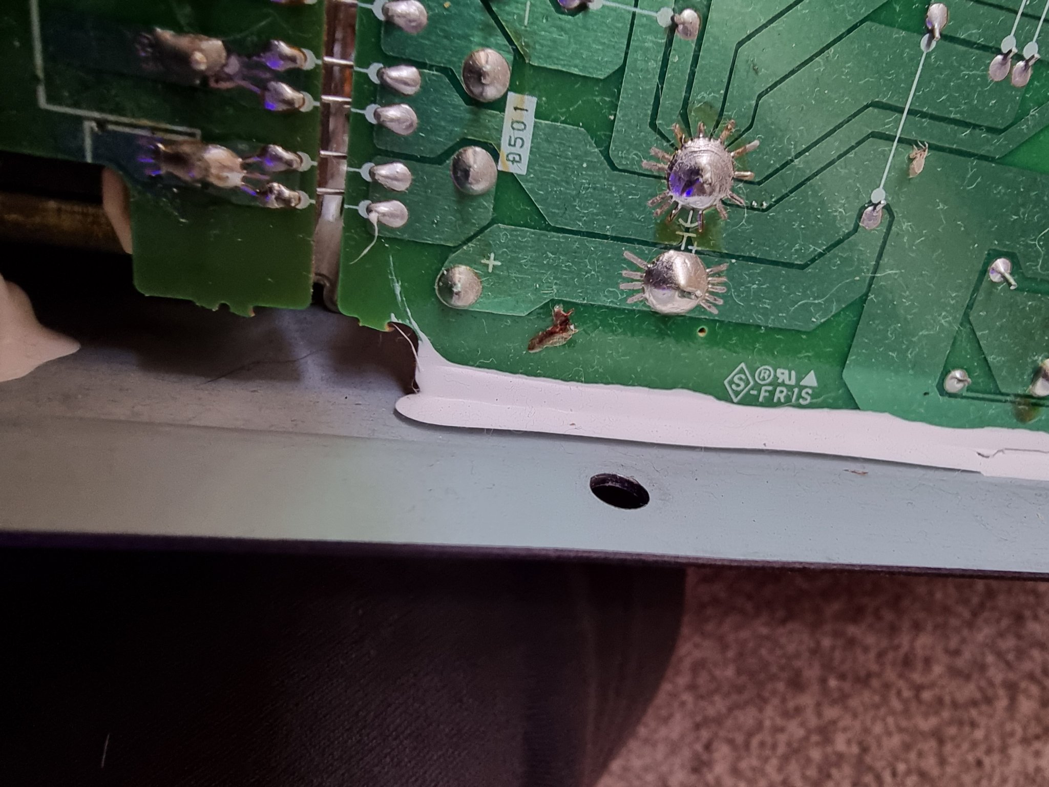

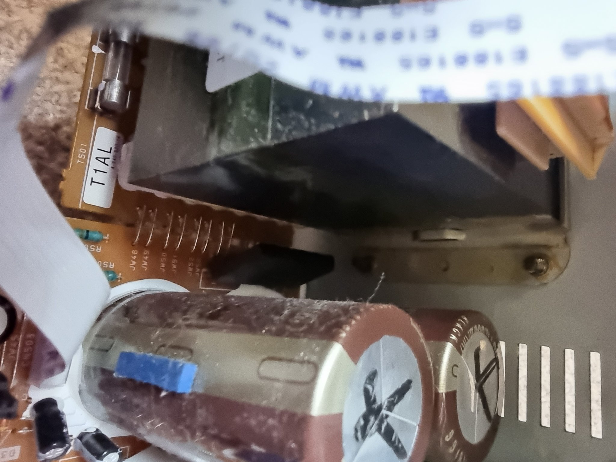

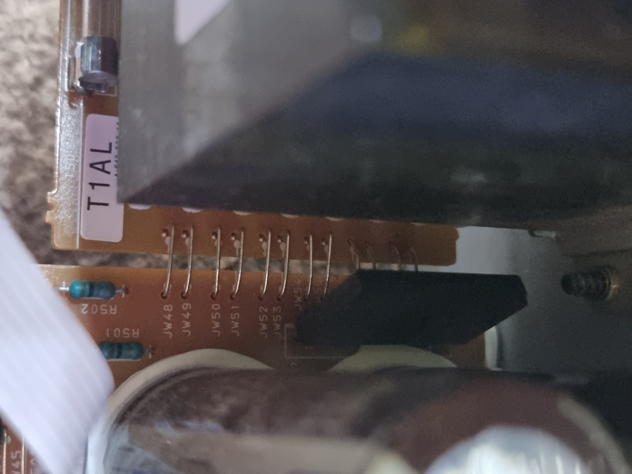

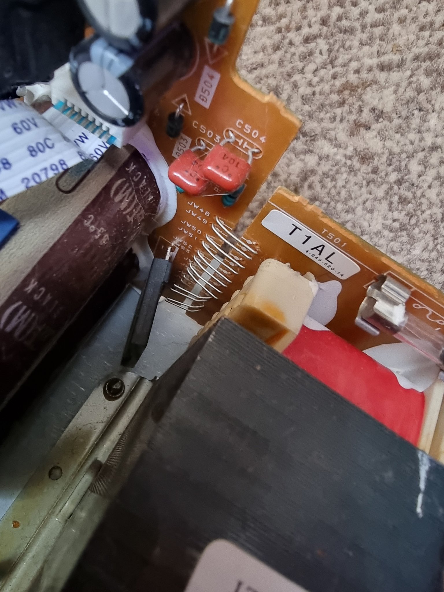

Hi, just wanted a bit of advice for this sub. It arrived with the amp plate hanging off the rear, so I put it back together the best I could, before that had to take everything to pieces as the metal plate was severely deformed.
What I'm stumped on is,btge PSU has those pins on them in the picture, do they need to be touching the circuit board right next to it? As it has tiny lil solder points on the next board are they meant to be not touching? Don't want to plug it in just incase.
Any help would be great.

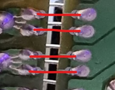

Its hard to make out in the images. The first picture actually does look strange now I look closer but the other views look different.
These do look not to be connected:

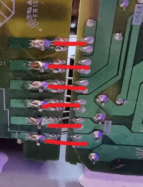

Electrically I would assume they should be like this:
They just link across, one pair of links for each pad to pad connection. I can't see it being anything different to that tbh.
Each pad connects to the one opposite like this. There are two links per pad to increase mechanical strength and increase current capacity.
