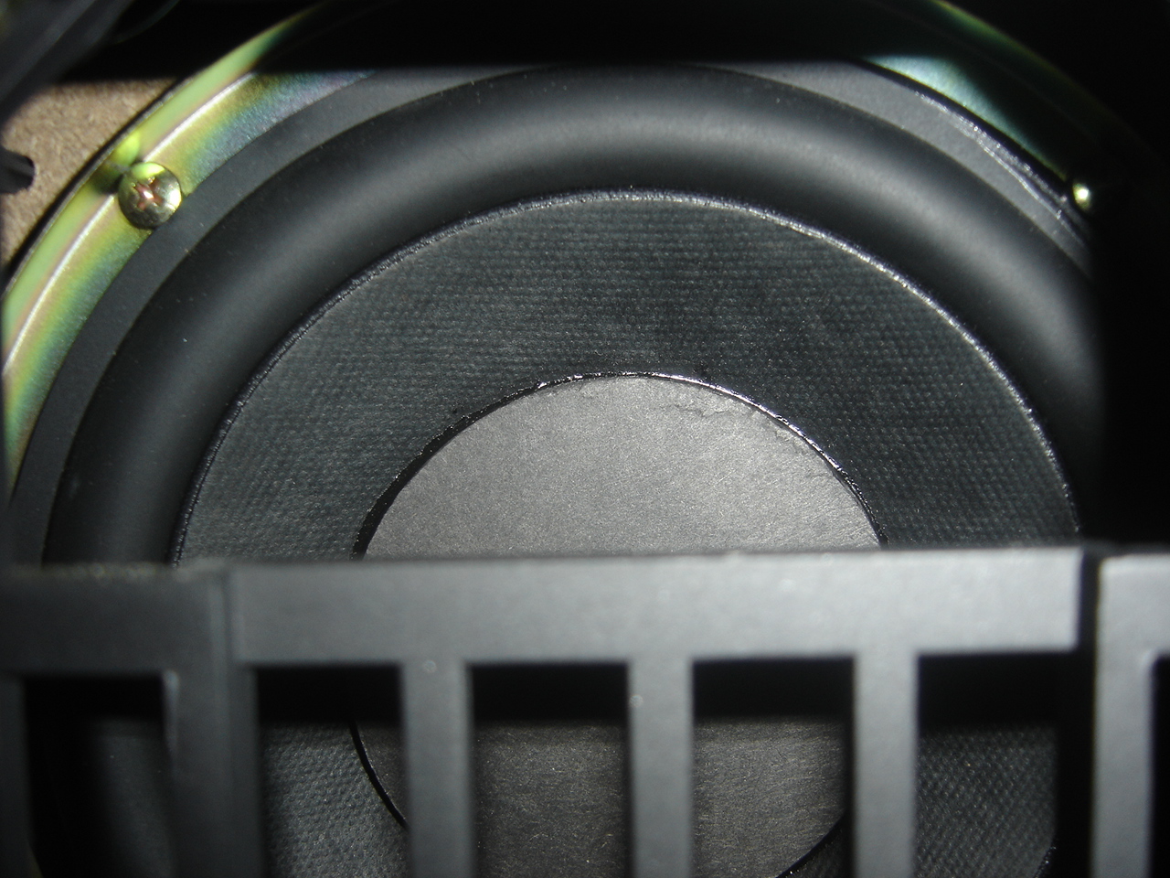

Purchased one at a Flea Market for 15 Bucks.
Pics can be found below in the links.

It's got an amp, and some interesting controls. I wouldn't say you've been robbed, but your money may well ave been better spent.
I've always been curious about those little, low and rumbly subs - what sort of driver do they use?
its Not a Bad Sub,its a good Value to me...the Bass Peaks somewhere around 40 and isnt Signifigant Below 33...it sounds good.
The Driver is a 6.5" Paper Cone with a Rubber Surround,Flat Dustcap,its Bigger than it looks in the Photos and Quite Heavy.
The Enclosure is Ported...which sony Refers to as "Acoustically Loaded"
the Port Moves alot of Air around 40 Hz,Below the Tuning Frequency the Woofer Unloads abit below 33 Hz.
