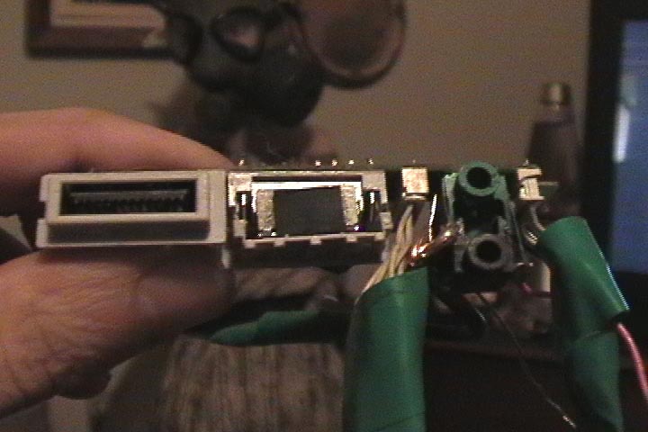

ok I've tried every wire there is still no pitcher just sound
Now to run a wire for video from phono jack do I remove every thing or just the cover where the jacks are all help is needed
thanks Guys
Blackie😕
I didnt have to remove my jacks at all.
The connections were actually exposed on the outside of the inputs.
I just soldered directly onto there.
The pictures are really crummy, but you can see that the jacks are still in place.

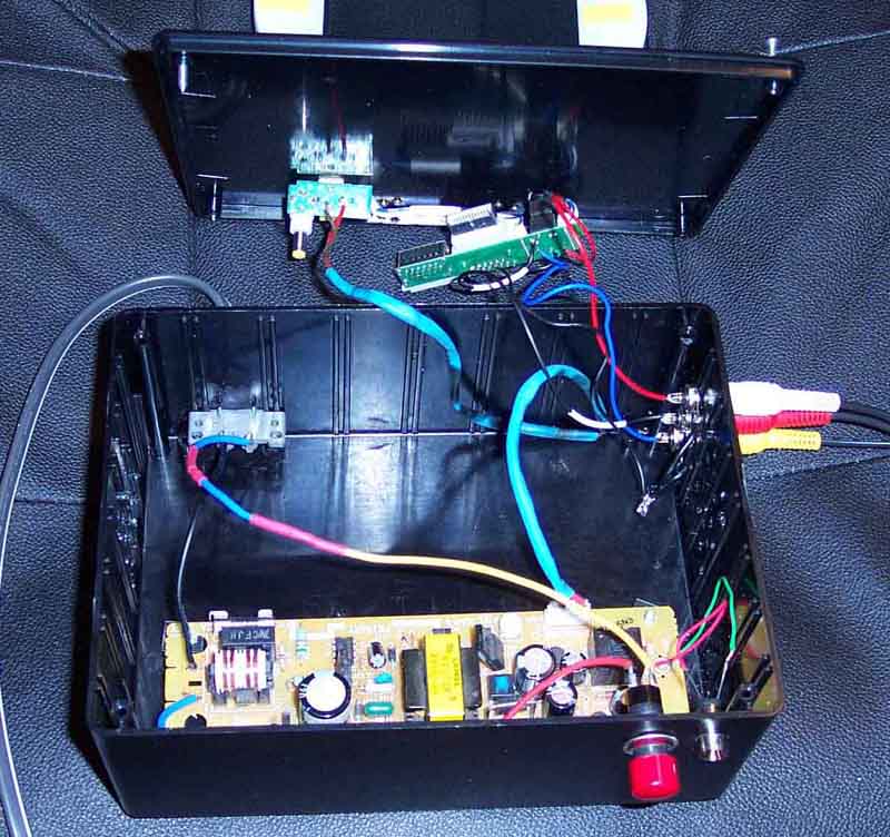

Hey there.
I had the same issue. No power supply. What I did was pull one from a junk playstation (Grey one) and mod it into a box. I also connected RCS jacks to the Mini AV input so it would be easier to connect a multitude of game systems to it.
This is my first post, so please be gentle. :whazzat:
Liteyear98 said:
Hey there.
:whazzat:
I meant RCA (Not RCS) jacks in the previous post. I also attached a picture before, but I think it might have been too big. I have reattached it.
