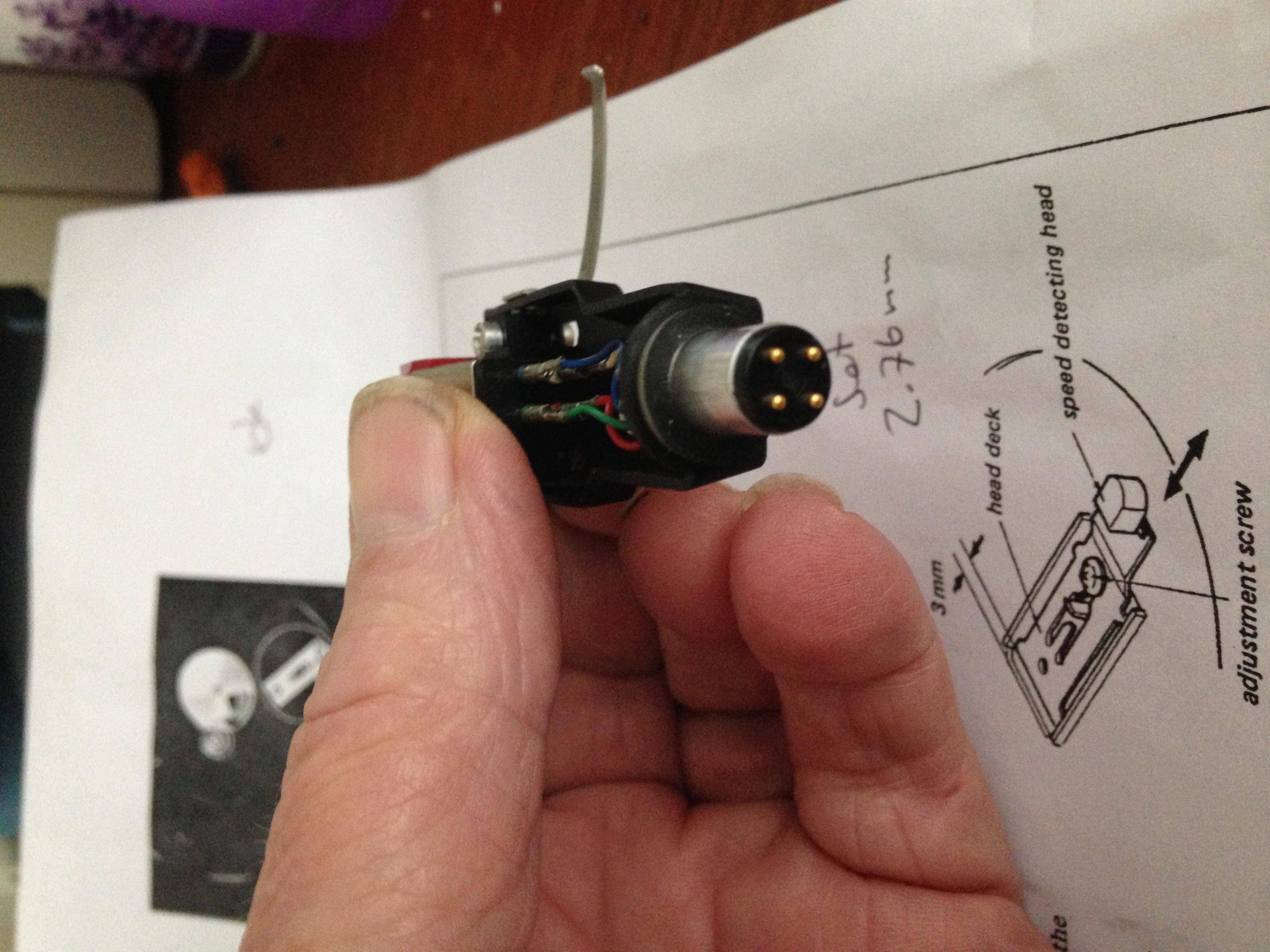

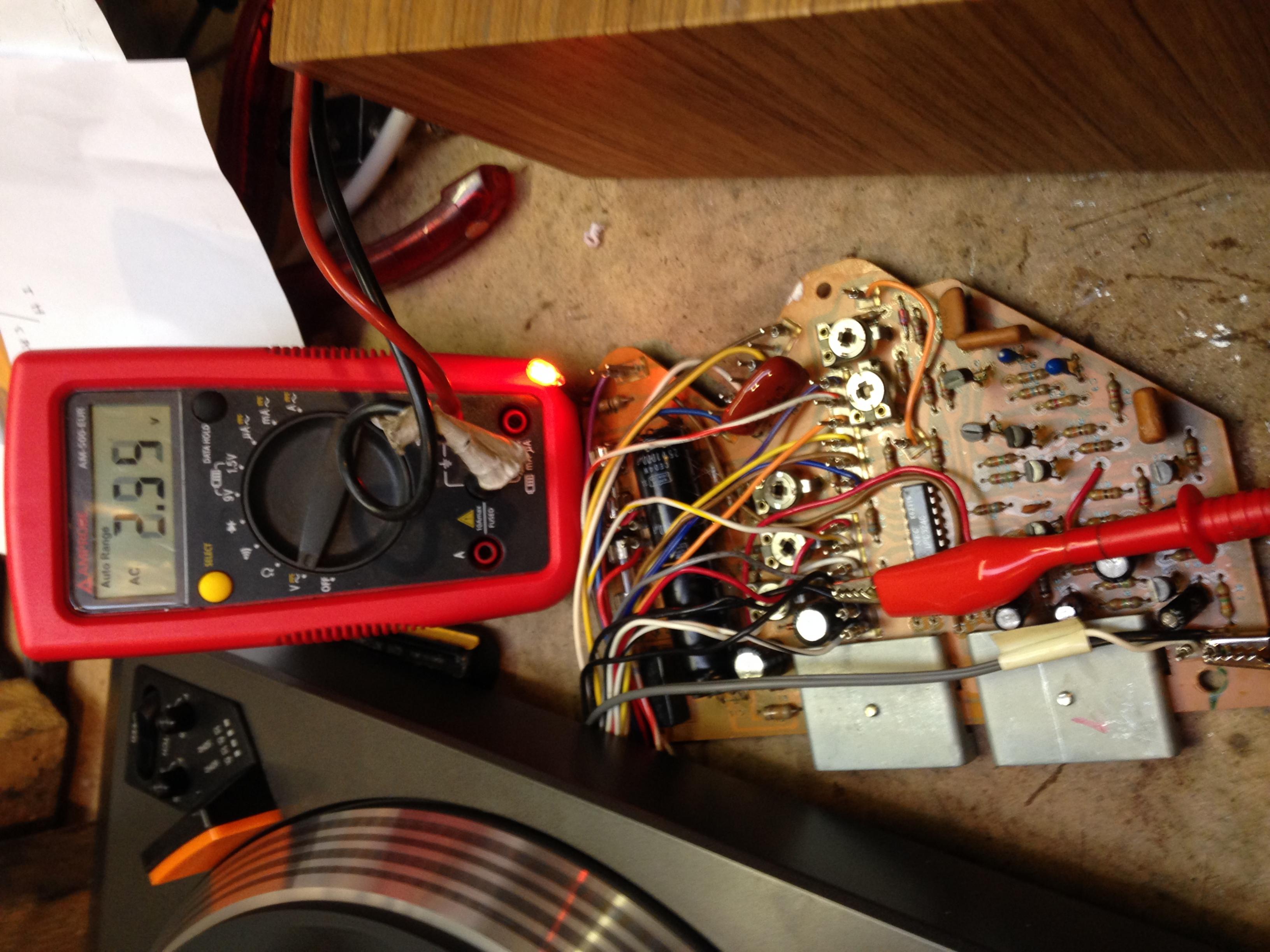

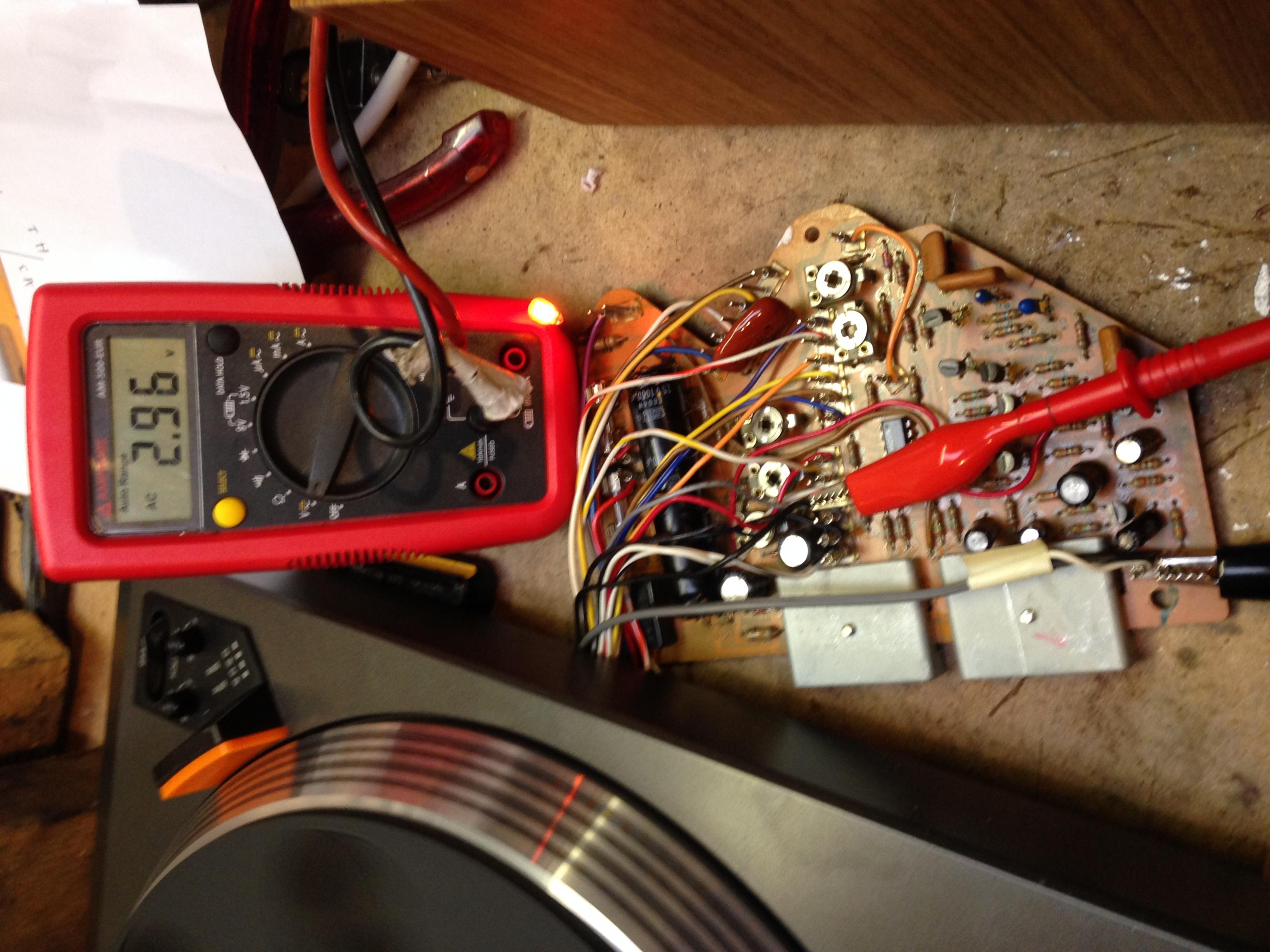

Hi Duncan
It seems to be starting now ok, I adjusted the " Speed detecting Head" as per page 8 of the manual ok, cleaned some contacts etc .
But am having problems with setting the values for "All" the measurements on page 11 of the manual, the voltmeter readings are just fluctuating ie "Motor Gain Adjustment" Setting RV2 and RV3 the meter is reading from OL to 3.26 , 2.56,1.96 it just keeps fluctuating up and down those readings.
For the "Offset Adjustment" RV4 and RV5 it is fluctuating between 1.076,0.966,1.167 etc .

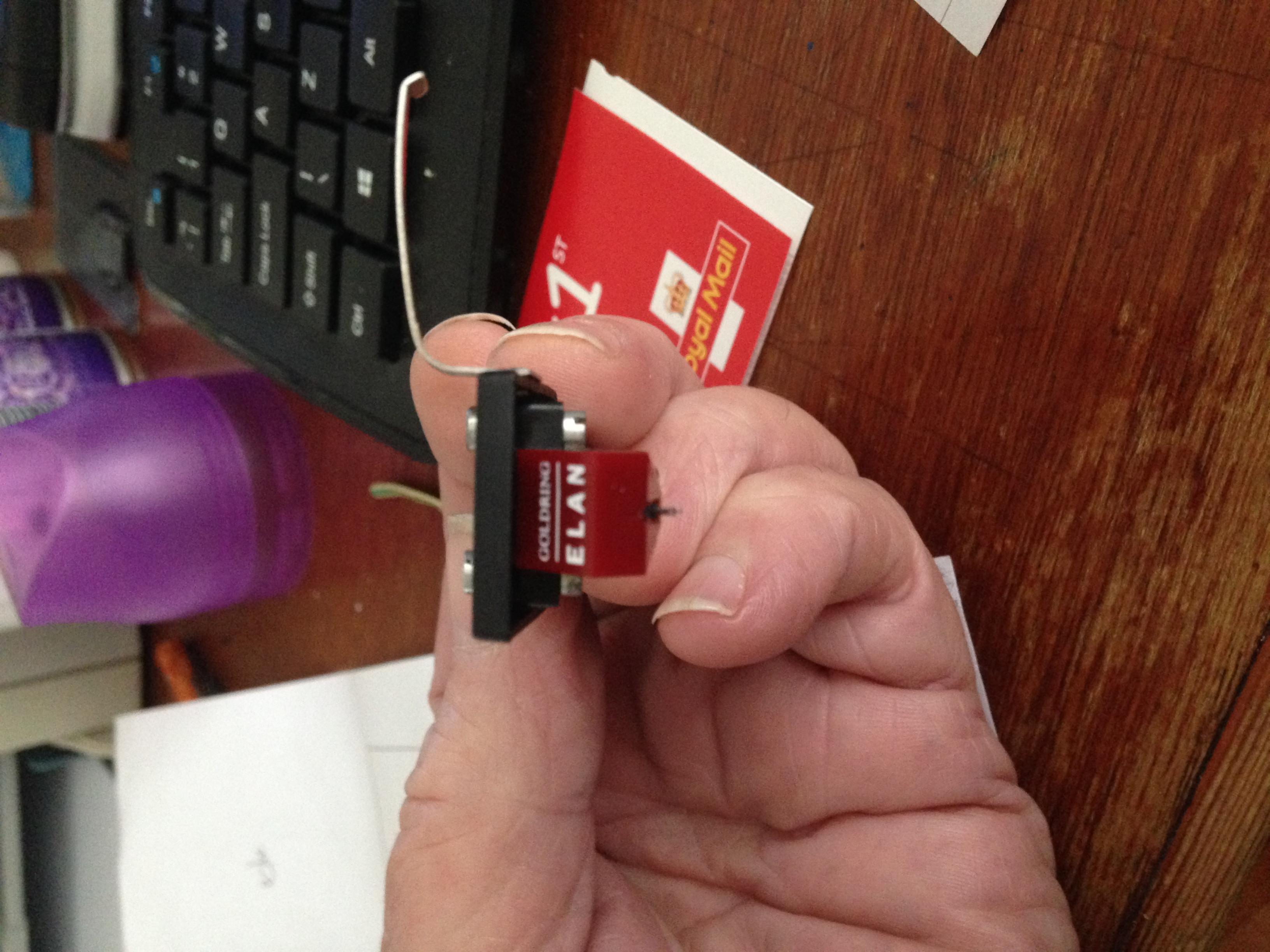

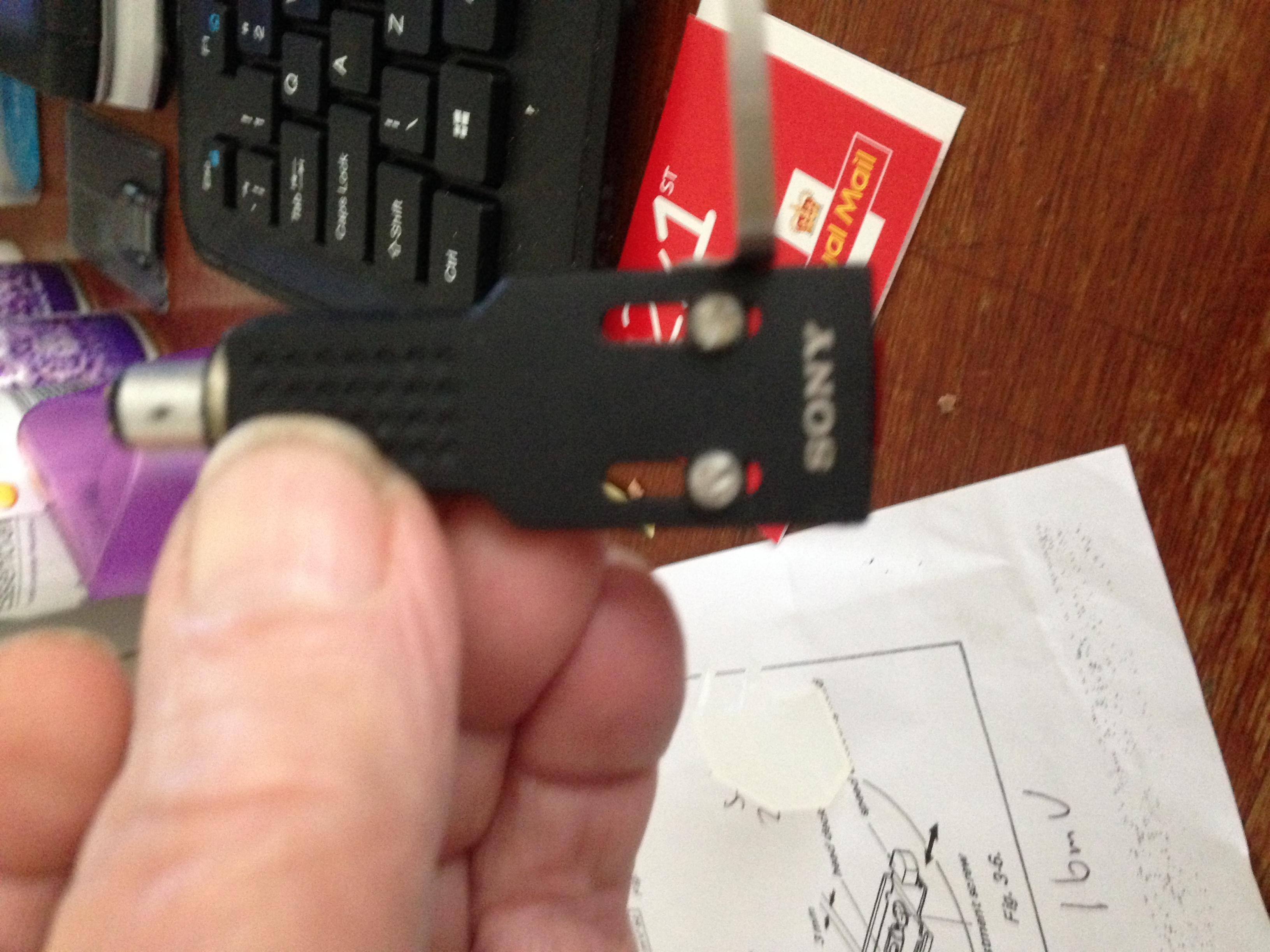

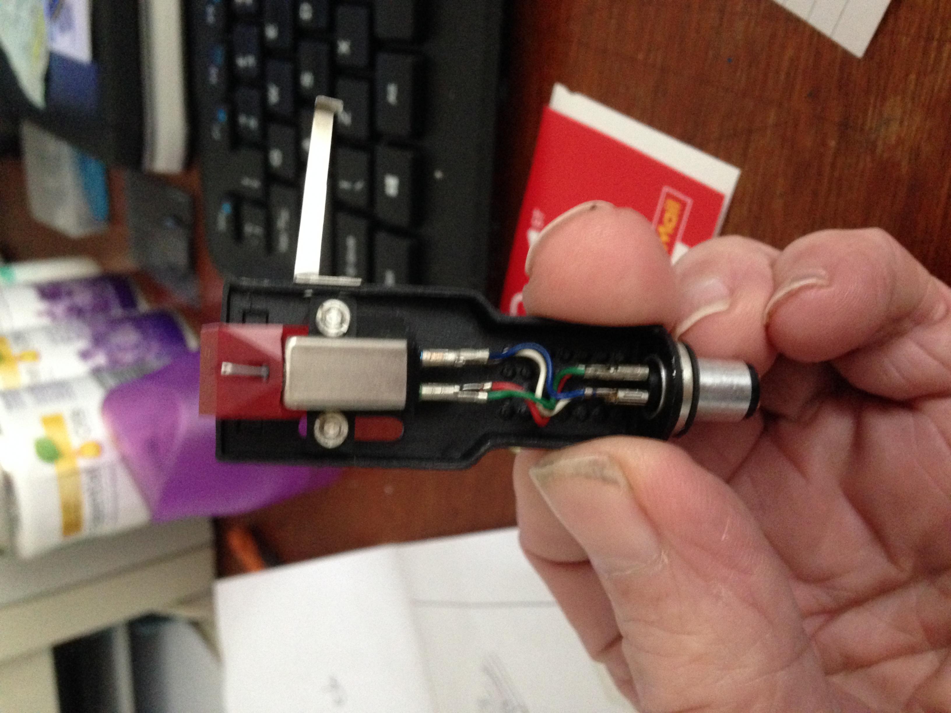

Turntable sound problem,
Hi
Not sure what type the cartridge is, will attach pics .
Spike

That's a magnetic, MM cartridge.
Labeled under several brand names, it's an ok cartridge for people that aren't too fussy.
The company owning the brand (s) is now under a spot of bother and "indi products" is now supplying the Goldring range which used to be a UK owned /manufactured brand for lower end cartridges which I would class as "mediocre " .
I suspect the company mentioned has a connection to India.

Hi Duncan
Has I have just put on here , the sound is now ok , still have the problem with the RV settings though has mentioned earlier (post #8 to you ) any thoughts on that, just that to sort then I will be a happy man ! .
