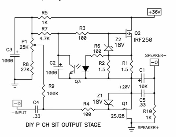

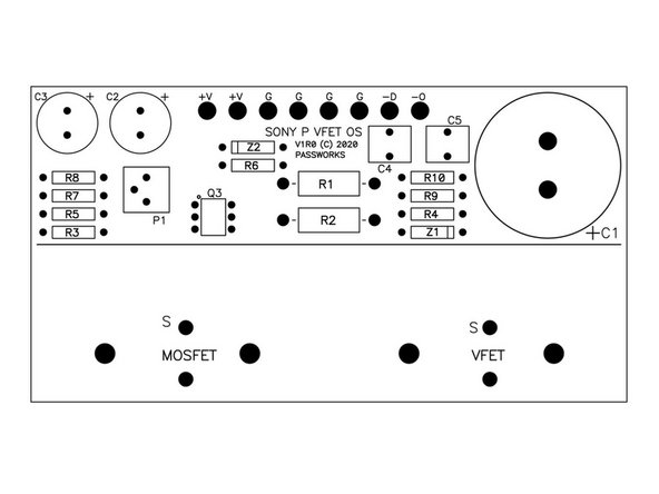

I'm working on the DIY Sony P V FET OS2 P CH output stage. I,m missing the R8 resistor at 27K does this resistor have any special characteristics

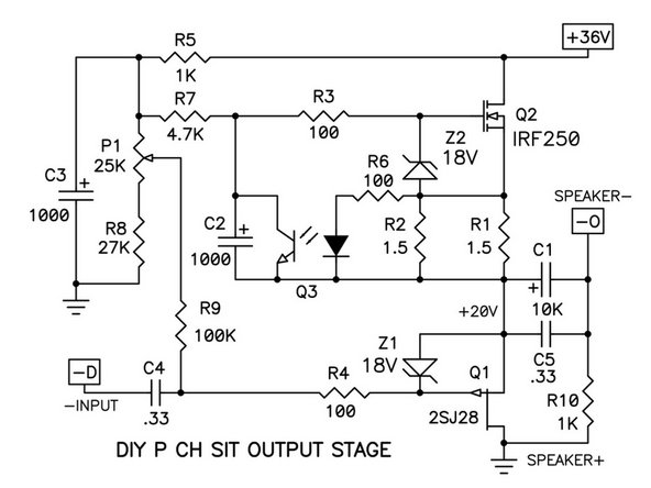

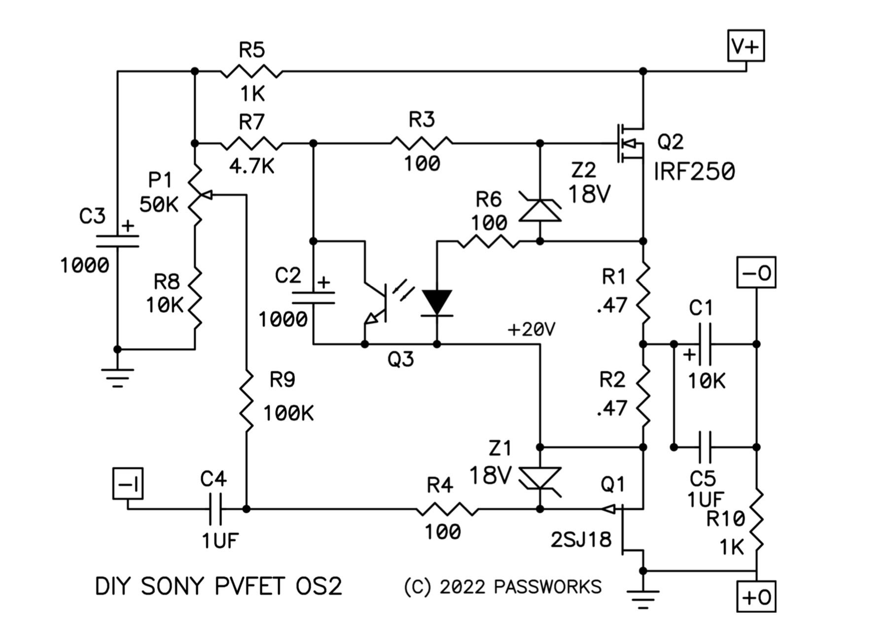

Still building the Sony P vet OS board. On the schematic R9 is marked as 100k, The resistor I have left measures 10K Ohms. Is R 10 a typo at 1K Ohms or was the wrong resistor included? also the R 1,2 resistors included are .84 Ohms the schematic shows 1.5 Ohms are they good to use?
