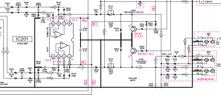

The attachment is a picture of the players analog output. Any comment on that. Should I replace some parts when I replace the OPAmp with LCaudio module.
Any help is greatly appreciated !
Edit: My preamp is passive 10 kohms. Any problems to be expected?

Check the DC offset on the IC output, you might also be able to get away with bypassing (short) the 100 uf electrolytic output coupling caps C212 & C214. Cheap electros aren't usually considered 'sonically optimum' devices.
How is the dc offset measured?
Those caps are Nichicon Fine Gold caps. they should pretty ok, but I'm considering changing them to Black Gate caps. I don't dare to remove the caps completely

I would like to get rid of those nasty muting transistors. I tried to search for a thread with instructions how to change the transistors to ralays but I didn't find any.
Any good links to internet pages with instructions how to do this thing??

Are there some capacitors left in the output that should be removed?

DIAR: You could try to first simply remove the muting transistors, if you notice any problems caused, then you can later add relays. If there arent any problems, just do without them 😀
My dvd963sa has been playing with new op-amps (ad8066 as I/V and ad8620 as output stage) and without muting transistors for about 3 weeks now, and no problems has accured. The only time I notice any distorition caused by no muting transistors, is if I turn off the dvd player before the preamp..

I suppose I can try to remove the transistors and try how the player likes it. My power amp and my preamp are always on. The player shuts itself if it isn't played for a while (15 min?)...
