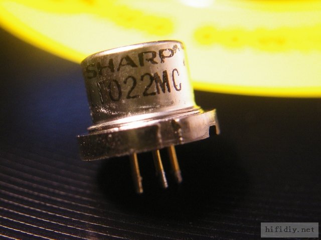

Sony KSS213C
by reading the datasheet of SONY KSS-213Q/C about
http://www.datasheetarchive.com/datasheet-pdf/040/DSA00105113.html (KSM-213QCS)
http://www.datasheetarchive.com/datasheet-pdf/040/DSA00105111.html (KSM-213-CDM)
and Samsung CMS-B33SG6/CMS-B35BG6 about
www.haluyatech.com/down/sgnec/CMS-B35BG6-20040303.pdf and
www.haluyatech.com/down/sgnec/CMS-B33SG6(20030210).pdf
more exactly I discover different laser diodes listed on the datasheets (look also to the attachement, if the links don't goes open):
1) SONY SLD104U
no datasheet - only for the successors -
SLD104U datasheet, SLD104U datasheets, SLD104U datenblatt, SLD104U manual, SLD104U data sheets, SLD104U pdf - ALLDATASHEET.COM
2) SONY SLD-104AGL
no datasheet to find
3) ROHM RLD-78MA
http://www.datasheetcatalog.org/datasheet/rohm/rld-78ma.pdf
ROHM Begins Industry's First Full-Scale Mass Production of CD Laser Diode in Plastic Package with Metal Shell.
4) Sharp LT022MS
LT022MS datasheet and Application Note, Data Sheet, Circuit, PDF, Pinout | Datasheet Archive
This makes me a little confused, because the outline of the last both is normal issue (M-260) and that one of first both from SONY is very special and only to find by SONY laser diodes (M259-Outline).
For me now there are the follow questions:
1) Wich type provides the highest life expectancy ?
2) Are there an influence to the kind of the internal management for the light beam between this two different outlines of diodes?
Sony's M-259 outline means an angle of 30 degrees against the reference plane (see datasheet)
Thank you very much for any advices.

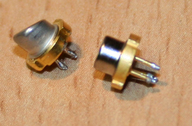

Now I have found any informations of the very special outline of SONY's SLD laser diodes for compact disc players:
The light beam exit (front of the M-259 housing) is angled (30 degrees) so that the exit window (anti-reflection coated) is mounted at the same angle to prevent any remaining reflections from the window's surfaces - as small as the are - from feeding back into the laser diode's envelope or interfering with the detected signal. The output of these edge emitting laser diodes is polarized. This angle is the so called "Brewster Angle"
Brewster Window - read more about this there:
Sam's Laser FAQ - Diode Lasers
scroll down to this headline
"Examples of Common Laser Diodes"
and about
Sam's Laser FAQ - Items of Interest
http://www.ryutu.inpit.go.jp/chart/H13/dennki08/fdennki08.pdf (history of Sony Laser, Japan language)
But now I understand even less, how can it be, that different laser diodes
be used in the same laser-unit.
