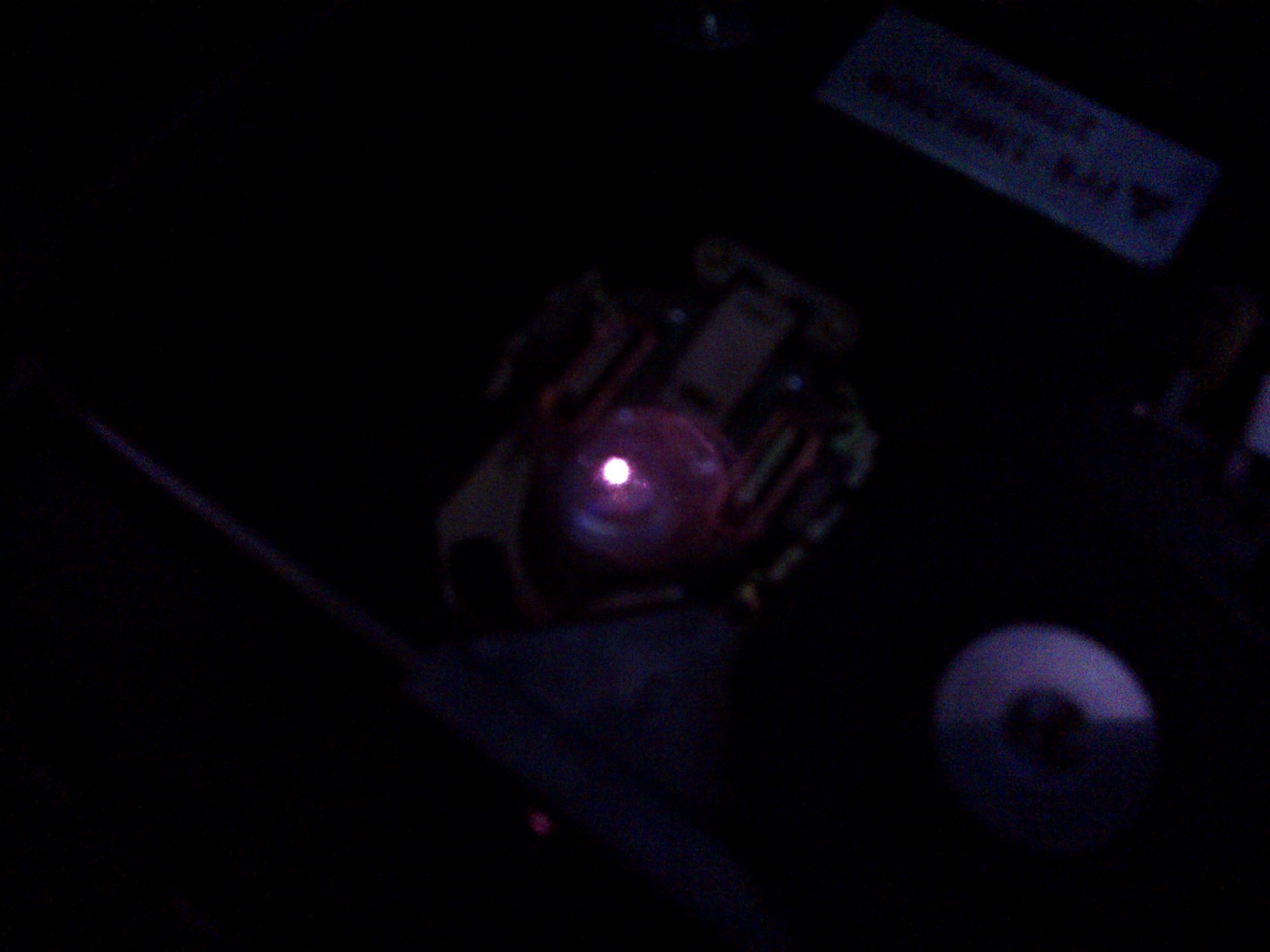

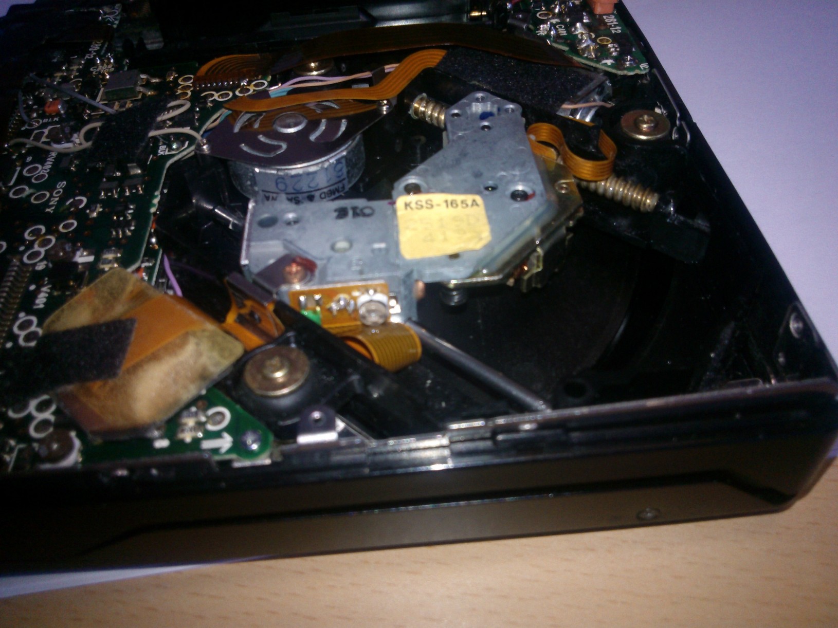

My discman SONY D 250 bought in the 80's has some trouble : CD is turning, optical block is moving , lense is gowing up and down but after few seconds CD stops. I think the system cannot focus because the laser beam is too weak.

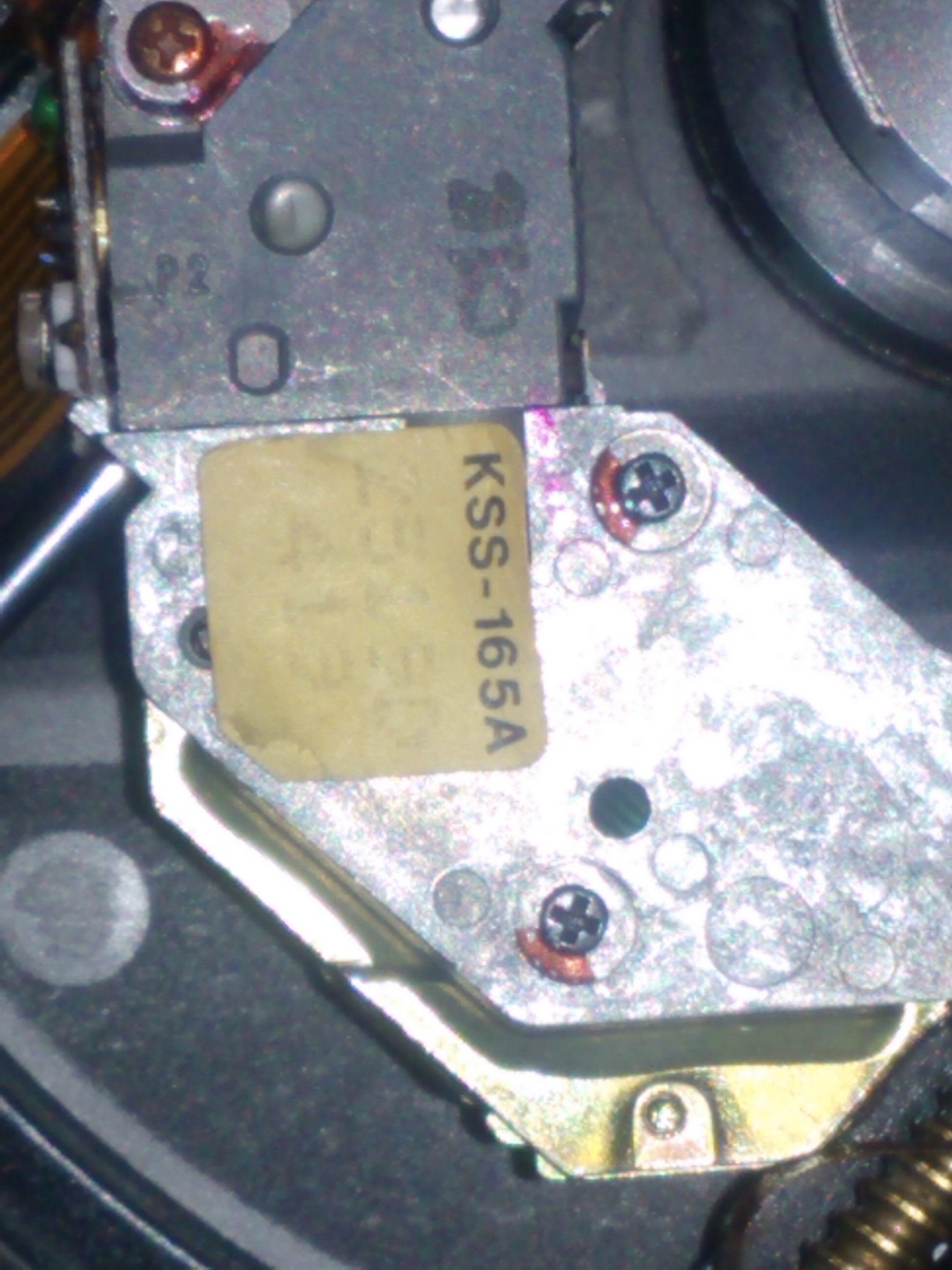

Tjhe optical block is a KSS-165A.

The last three digits of the pickup serial number show the correct (original) current. Is it 419 ? That would be 41.9 milliamps and is checked by measuring the volt drop across a resistor in the laser power circuit on the main PCB and calculating the current. If it is higher than stated by 10% or more then the laser has deteriorated.
Yes it is 419. I checked the current - as stipulated in the service manual - and I found 41.7 mA which is inside the tolerance (41.9 +/- 10 percent). Therefore the laser diode seems to be OK but - compared to another CD player - the laser beam is very weak.

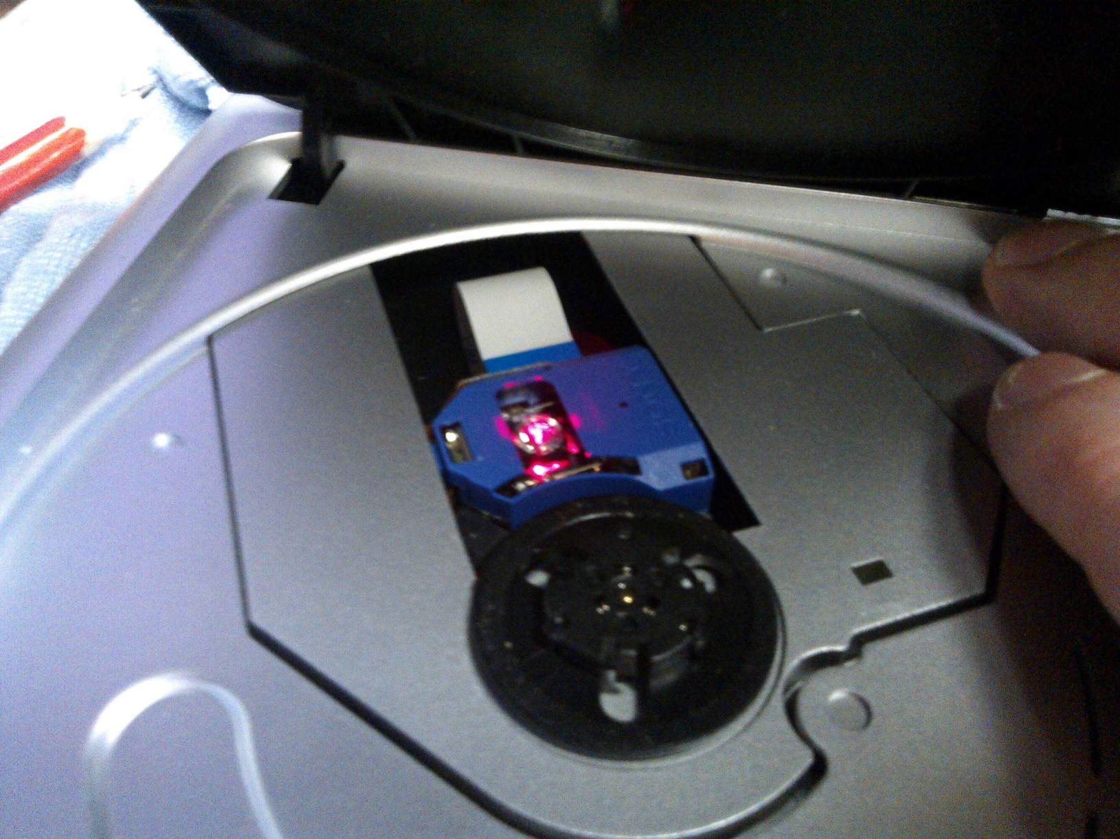

On the picture the laser beam of a DVD/CDplayer is clearly defined. But the laser beam of my discman D-250 is practically unvisible. If the laser is OK what could be the reason of the weakness of the beam ?

That reading is spot on. The visible light from these lasers is very dim, most of the emission is in the near infra red. That's why you can't "see" it. If you could then it would be very bright indeed. One reason you shouldn't look to closely at close range.
That doesn't help your problem though... all it does is show the actual laser diode is OK. If it had been duff it would have been case closed 🙂
So as it stands there could still be problems with the pickup as a whole.
Next step (as you mention it does spin a disc at the start) would be to look at the RF signal for amplitude and quality.

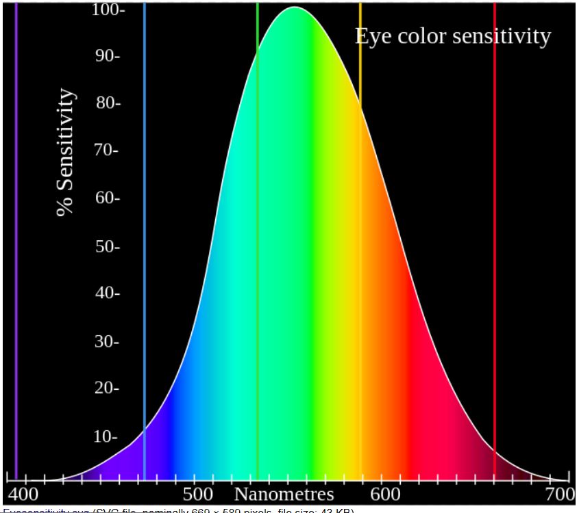

Its in my last post 🙂 Its because the wavelength of the laser light is 780nm on early CD players and around 650nm on ordinary DVD players. Look at this chart which shows the response of the eye. The CD player at 780nm is off scale and should really be invisible to the eye... and it almost is. You just see a tiny dull red pinprick glow.
