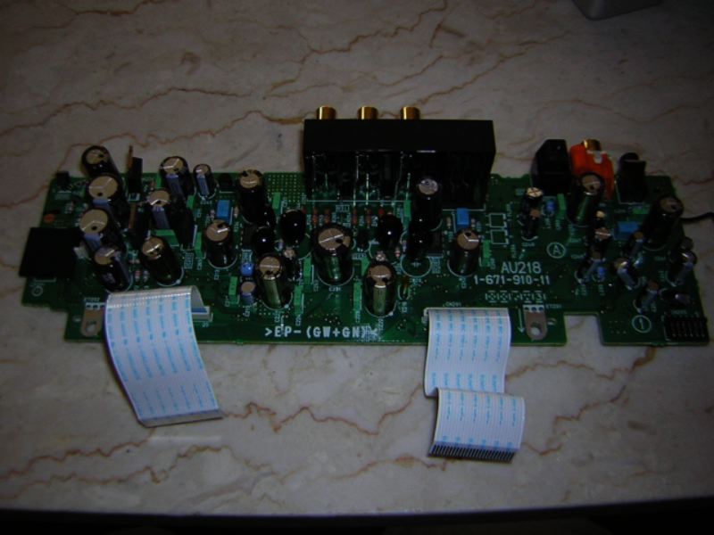

right so the dvp-s7000: here is the audio board:
Digital Filter cxd8505/Current Pulse DAC cxa8055:
+5V/-7V regulators for CP DAC and opamp analog out, use zener diode as reference, dual opamp, and 2sc2275, 2sa985 transistors:
+5V reg for digital filter:
opamp I/V and buffer and carbon film resistors..sony has a thing for carbon film resistors don't they!
(they also have a thing for not decoupling opamp power pins..at least right close to pins..opamps are ~3 inches from reg output cap on ~4-5mm power leads.
the error amps in regs are not decoupled either, save by 1000uF caps at board entry..distance can be seen in top photo in post..the one error amp is about 4inch from those 1000uFcaps..)

I changed 2 error amps in regulators from NJM4580 to OPA2132 and OPA2134, mainly because I bought those opamps a time ago and haven't used them. I decoupled opamp closest to 1000uF caps with TDK C0G FK 0.1uF ceramic across power pins; that blue little cap is perfect size for this (electrolytic in photo is part of filter for diode voltage reference, not opamp decoupling) :
the opamp furthest from 1000uF filter caps I decoupled with a 4.7uF 50V Black Gate N non-polar across pins. It's only 25 degrees with window open and fans blowing when soldering..although possible it just would have been too time consuming to decouple straight from power pins to load GND..much easier this way..though if I remember not quite as effective? I know I read that somewhere but cannot remember why and don't know enough to reason out why on own.

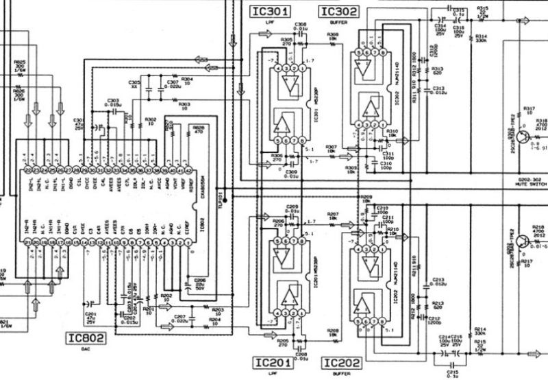

oh, and here is schematic for regs:

To start I kept all values in analog out as sony schematic below.. I used c0g caps for opamp feedback.. I'm wondering how sound would be different if I had used Wima FKP2 film and foil caps for feedback..
