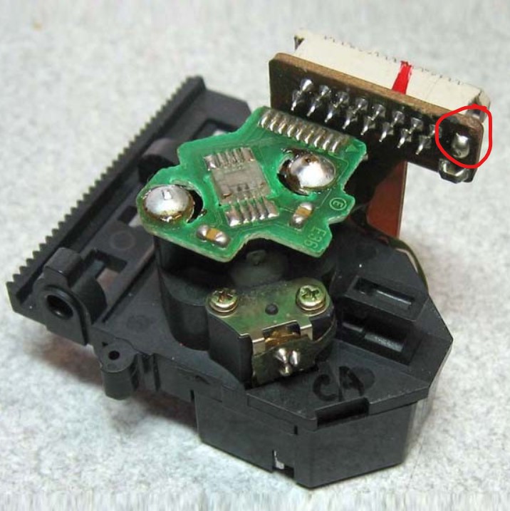

One thing to be aware of (and I'm not familiar with the KSS213R) is that many but not all of the KSS pickups have a 'shorting link' fitted to protect the laser diode from static during transit and fitting.
It is typically a blob of solder between two pads and need to be removed before the pickup will work. I don't know if that applies to this one.
A picture shows what might be a possible such link.

I do remember reading something about the need to remove a solder blob from somewhere. When I get the new KSS-213R pick-up I can compare the old one to the new one to find out if I need to remove any solder. Your picture is super helpful so I have more of an idea where to look.

On the new one, remove the solder blob only after connecting the ribbon cable if there is one. My KSS-240 didn't have it.
