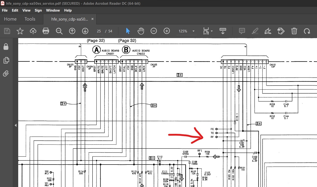

please can you also look at this info and teach me where it says to hook my scope up to,
i have both a digital single channel scope and a rather large dual channel scope,
then i guess i will need to know what setting to use on said scope,
is there any chance of you being so kind?
mike
Page 22 shows how to measure the RF but I would suggest in the first instance you just ground the scope to the chassis and simply probe the RF test point.

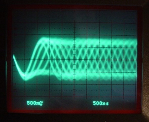

The RF can be found here:
This is from the web. You are looking for around 1.2 to 1.5 volts peak to peak. The diamond shape in the signal should be clearly distinguishable and free of noise and jitter.

i have found the test points rf and vc, it would seem i am to solder tails on to these to hook up scope, so i am going aheadI would begin by looking at the RF (eye pattern) with the scope while it actually plays. Look at the overall visual quality and amplitude checking for noise and jitter. Also check ALL rails and use the scope for that as well, a DVM tells little about problems with ripple noise.

You need to be very aware that VC could be a virtual ground point (I haven't studied the circuit but that would be typical) and so grounding that via the scope (if that is mains grounded) could cause a short to be applied to that point and possible cause damage.
If you measure any DC voltage on VC then it is NOT a ground point and you must not use that unless you are familiar with how to do so safely. It's much easier to measure from ground. The only downside is you may see a little more noise but it gets you 95% of the way there usually.

ok ,im getting nothing like the pic ,the wave form is nice and sloping in pic,im getting lots of ups and downs ramdomly. do i need a special cd?You need to be very aware that VC could be a virtual ground point (I haven't studied the circuit but that would be typical) and so grounding that via the scope (if that is mains grounded) could cause a short to be applied to that point and possible cause damage.
Any decent commercial music disc is fine but you should never use CDR or RW for tests. The RF always looks the same regardless of content.
If you are using a divider probe (X10 probe) then a good initial setting would be 50mv/div, if using a standard probe (X1) then 0.5v/div. Divider probes are preferred because they have much lower capacitive loading but the RF test point is low impedance and so either should be OK.
my scope is set at 20mv ac
some thing must be up with it as its just one single line being very wiggley ,im guessing this is what it looks like when things are bad?
at the moment its playing very well ,but when it skips back you can here the laser fall out of focus (the laser makes a click sound and the then the disc reads again and continues playing from a few secs back on the cdsome thing must be up with it as its just one single line being very wiggley ,im guessing this is what it looks like when things are bad?
When it is playing the RF will be at least something like it should be. So use that as a baseline. It should and will look at least somewhat like in the image I posted. If the amplitude drops below around 0.9 volts peak to peak then the player gives up and will not play.
If it is playing correctly and the RF looks wildly different to in that image then something is wrong with the measurement technique.

If its playing OK then the RF must be basically correct. There is little room for it not being if the thing is playing. Something has to be amiss with the measurement in some way. The amplitude will be at least 0.9 volts peak to peak if its playing.
So much depends on the scope settings as well. You need internal trigger with NO HF reject selected and you need the time base wound out enough to resolve the detail. The scope should trigger easily on the RF signal. An analogue scope needs to have at least a 10Mhz bandwidth.
i have got the signal now,it is blury as my focus button is giving trouble ,repairing it now,only take a min moreIf its playing OK then the RF must be basically correct. There is little room for it not being if the thing is playing. Something has to be amiss with the measurement in some way. The amplitude will be at least 0.9 volts peak to peak if its playing.

That was a very good scope back in the day and way better than most modern digital ones for resolving detail.
The RF should not be excessively fuzzy. One possible cause is using chassis ground (as I mentioned earlier) rather than the VC point but it is a much easier option. If you can measure on the scope a lot of noise between chassis and VC then that is the answer.
The RF signal is a direct signal from the disc itself and so any problem with disc rotation will show in the RF. The signal is only stable and clear while the servo's are locked.
The focus servo (lens up and down) always has to be correct. Any focus problems will show as a lower amplitude signal.
The tracking servo (lens moving in horizontal axis) brings it all into sharp focus.
When you jump tracks on the CD such as going from beginning to end of the CD then the tracking servo is partially disabled (tracking gain is lowered). What you see on the scope during that time is a blurred RF signal. If that is the sort of effect you see happen when playing a CD (when it fails) then it suggests a tracking issue.

do you think i should not hook the scope on the two test points listed in the service manual? if i did would that tell me if the wave form is cleaner at its source,, or is it two dangerous for me to try? i do understand that i am not very good at using this machine, so if you say dont i wont,
