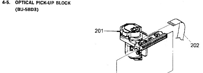

It tends to skip and/or get stuck at the end of cd's with many tracks (16+).

Replace the flat cable (pos. 202 on your drawing)
/Hugo

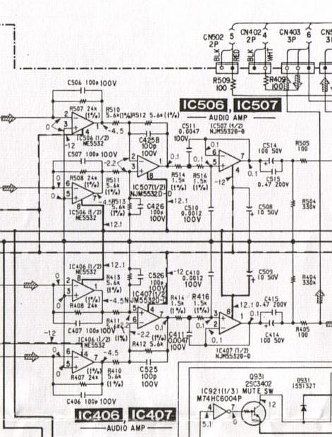

The only thing I've modded on the Sonys is to change the final output opamps to OPA2134 or AD825 and changed the output coupling caps to Black Gate NX.
An example is the CDP-X55ES (see schematic) and only changed IC407, IC507 to AD825, changed C414, C514 to 47uF BG NX and removed the by-pass caps C415, C515. Didn't have to do any more than that as was an ample improvement. Any other opamp tried in IC406, IC506 degraded the sound so the original 5532DD remains.

Hi there, tracking problems seem to have almost disappeared after thorough greasing. It is a fact that the cd disc perimeter does seem do "tremble" slightly while rotating. Should I change the motor? could greasing the motor axis help?
anyway as it looks as if the problem is gone I was planning on doing some modding to get me started as an electronics diyer.
I am posting here various photos as well as a schematic i have found in order to make it for you easier to make suggestions.

Would changing all those caps help me get back the focus?

and what about the values of the replacing capacitors? should they have the exact same value of capacitance and/or voltage?
How about PSU? it would be a good idea to make a new one I reckon. Any suggestions/designs?
