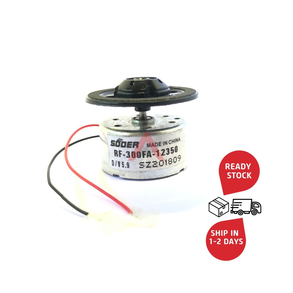

Skipping at the beginning of the disc can be down to a faulty spindle motor.
Perhaps tipping the player at an angle stops the shaft of the motor from wobbling in a worn bearing.
Try wiggling the motor shaft from side to side to check for any worrying wobble.
Oiling a worn bearing (if it can be reached) can give temporary relief. Eventually the spindle motor will require replacement, which I believe is no simple task.
