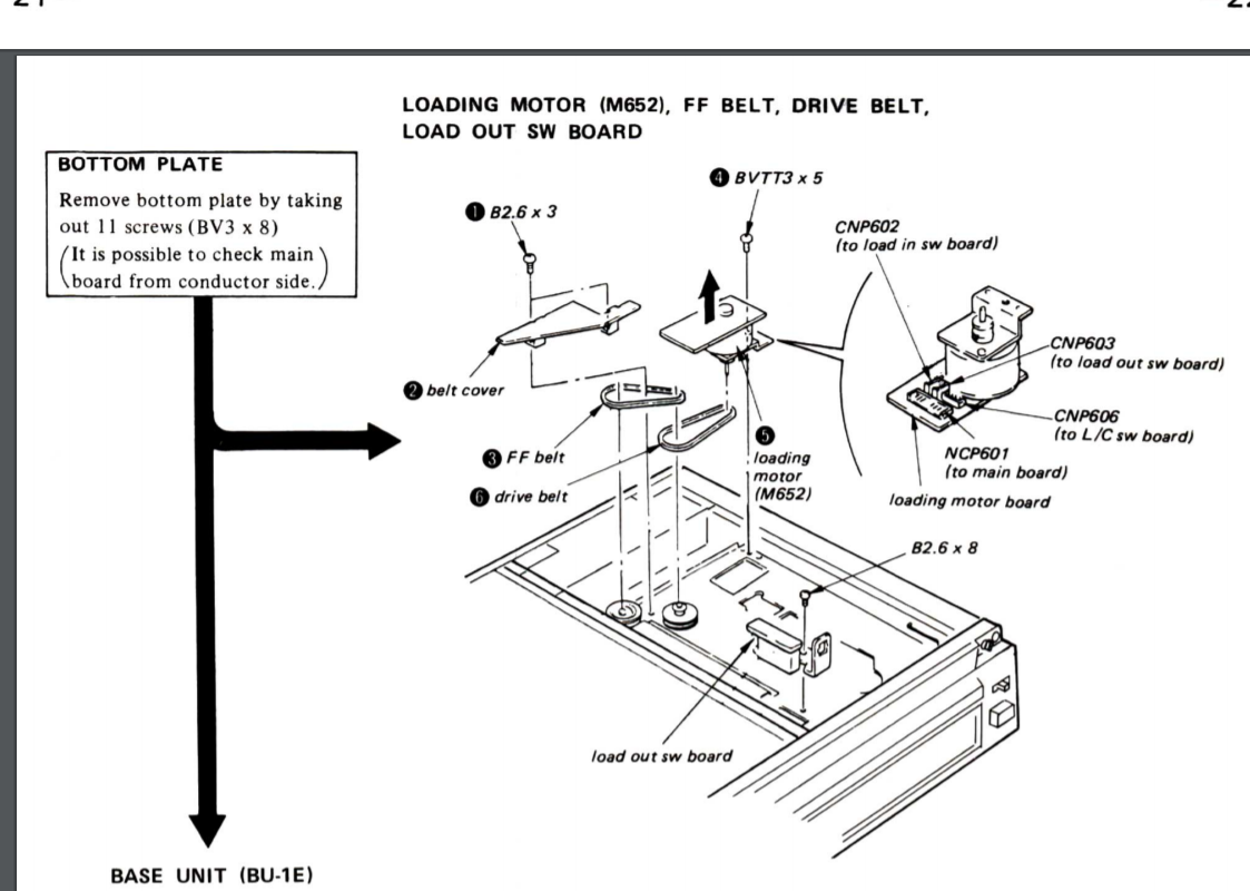

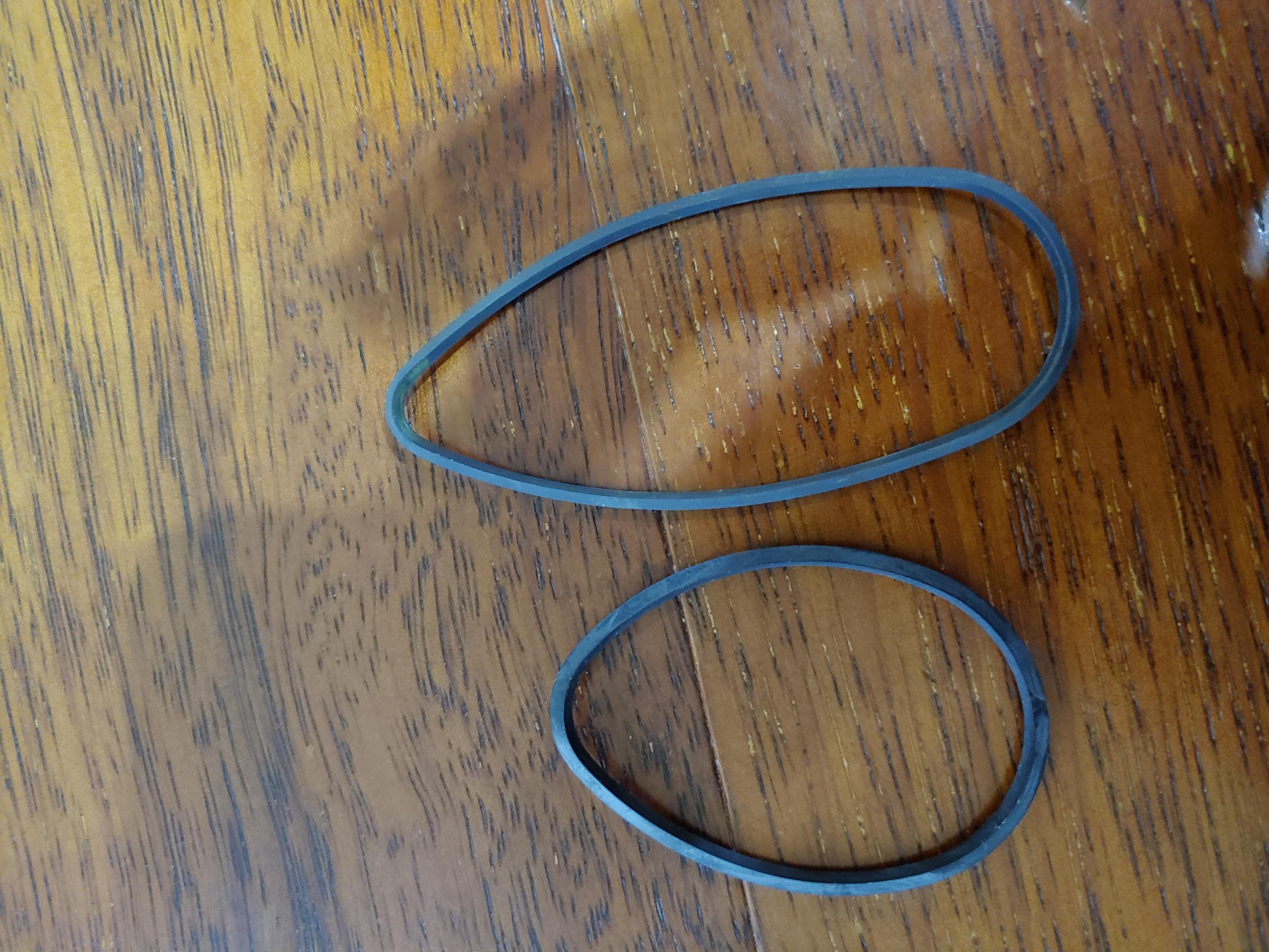

I just picked up a Sony CDP-333ESD from Japan the the thing is brand new literally unused in the original box it was listed "tray does not open" so i though ok i will just replace the belts end it will be fine , but i did just that the old belt was no good installed two new belts. .
And the tray still don't slide out , what is does is when i press the eject it unchacking but the tray wont slide out and than chacks back after a few second.
All the motors are working .
Original belts was very stretched sitting at one spot for a long time.
what can be the problem something needs to be reset??

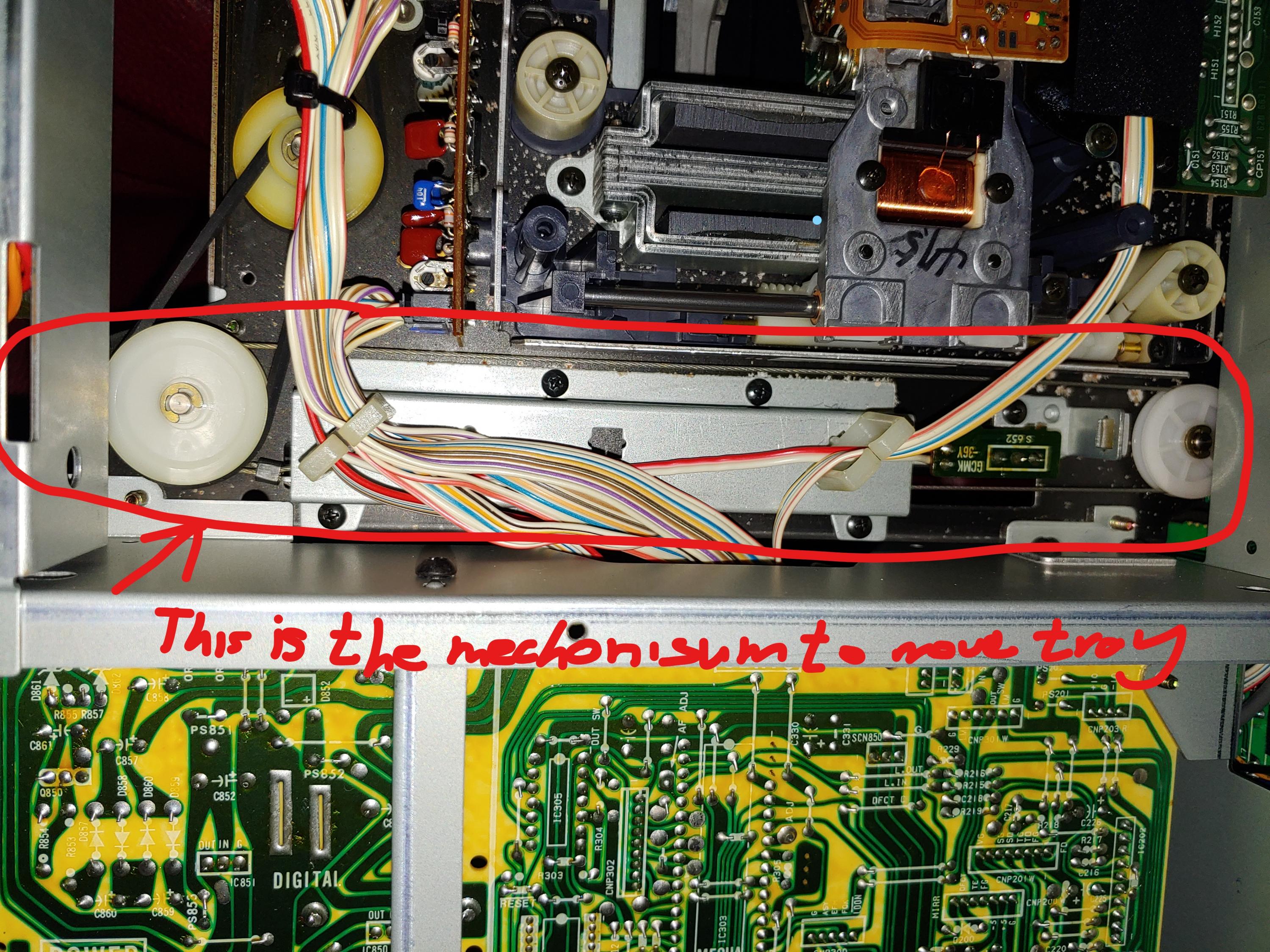

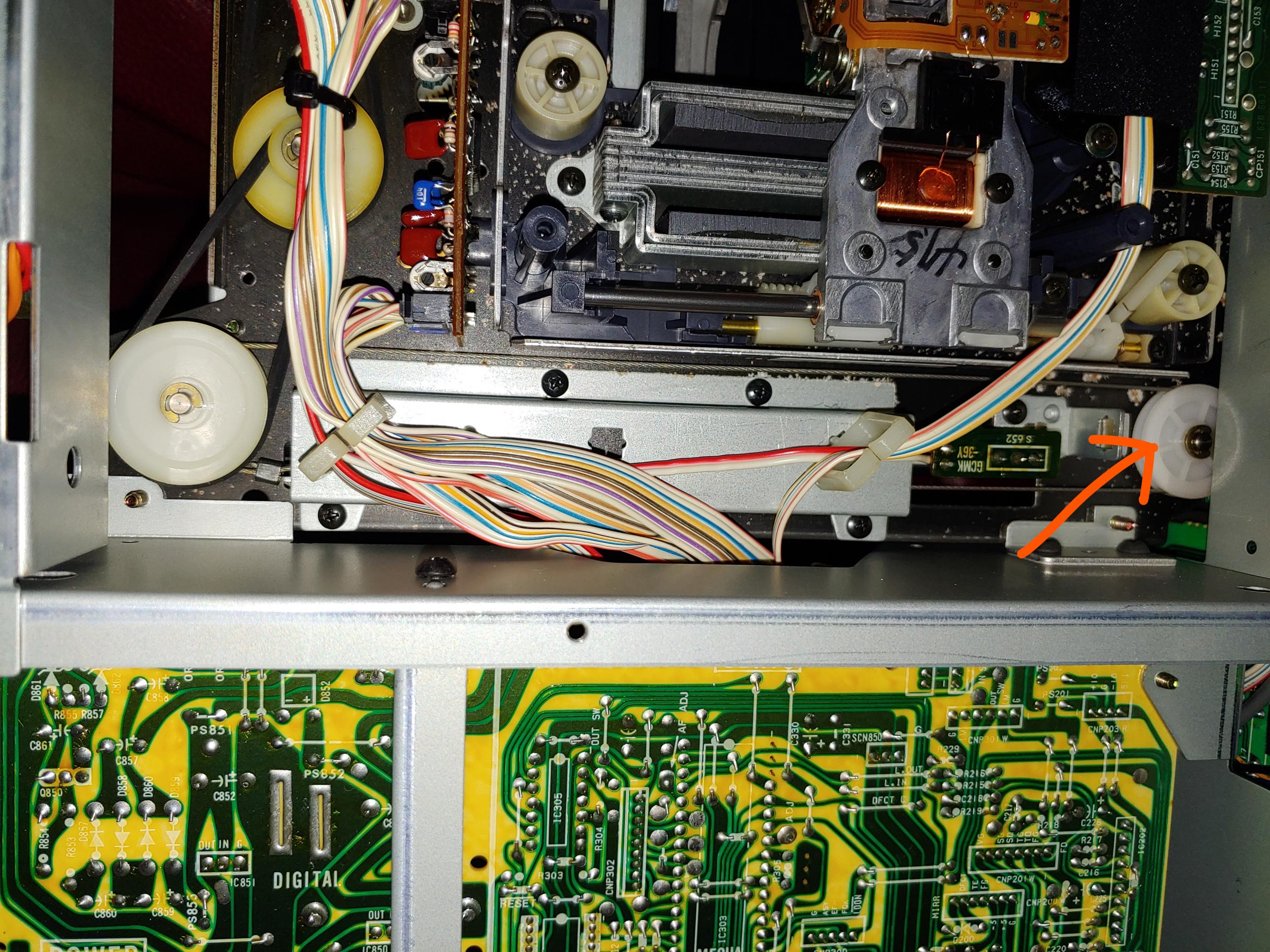

On the 6th picture that pulley is responsible to move the tray it connected to the steel cable and what is does is kind of try to spin but it does not if i remove the belt i can spin that by hand and its opens the tray .
I do have the service manual.

seems like the pulley is hesitating to turn it tries but than nothing happens

Here is some update the pulley in the picture was not turning so i lubricated it with a little sewing machine oil and now its moving freely , the tray is still struggling to open but it is starting now, i am not sure if i should lubricate the loading motor i will check it for free spinning....
