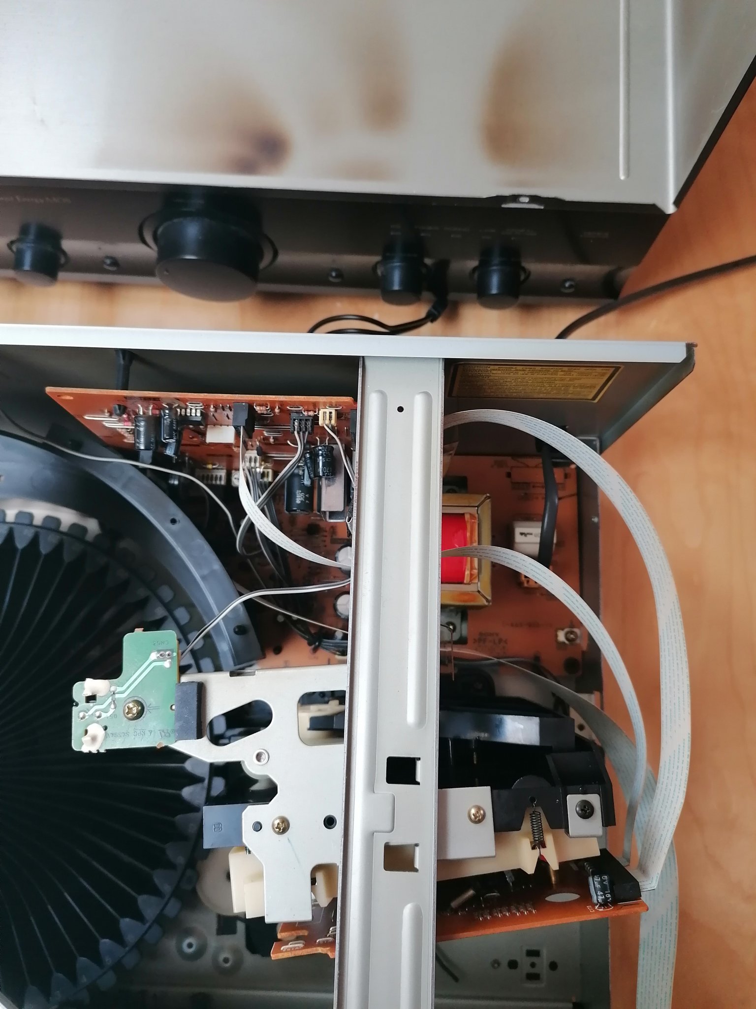

Just put the power on and inserted one cd , its spin's around 30 seconds with clicking sounds and the the display saying no disc.
Is this another problem or becomes the problem more serious?
Is this a sign the laser did not read cd's anymore?
I see on the inside of the top cover burn marks , all from the start when I opened the first time .
See picture:

Problems often change and manifest themselves in different ways while you are troubleshooting.
Not reading the disc as you describe may be down to a faulty spindle motor. Attempt to clean the brushes and commutator as instructed above. I would eliminate all possible mechanical causes before suspecting the laser.
Regarding the "burn marks", I can't really comment on those from this distance. However, I suggest you examine the electrical components underneath those areas for any signs of overheating.
