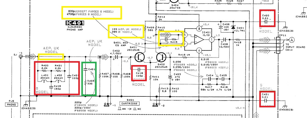

attached are the scematics of two of the sections that are different between AEP and G models.

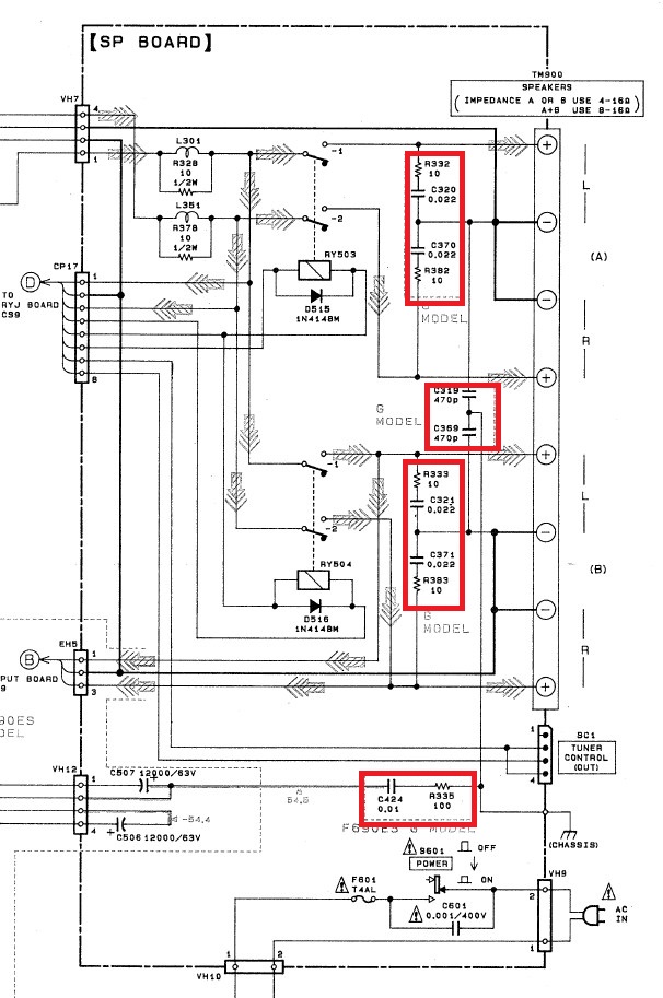

One is the speaker output board. additional components are marked in red. I suppose removing these is straightforward and wil not impact the rest of the circuitry. Will it impact sound though?
the other is the phono pre-amp section. modification there would be a little more imvolved: sections in red are additional to the G version, so these would have to be removed, and replaced by the bridge (blue section) and section in green. yellow sections are differet components (values).
again, will this affect audio?

Most of the extra components are devoted to tying the chassis to ground at RF (or vice versa), these are generally harmless IMHO as at audio frequencies both sides are at the same potential anyway. I'm a bit surprised that only the G model would have a Zobel network at the output.... ah, that's a second one. Hmm, that's a 10R 1/2W + 22n 50 V film whereas the primary one is 15R||15R 1/2 W each + 2x 47 nF 50 V in series. A single 50 V rated cap in an amp with nominal +/-54.5 V rails? That's a bit concerning. I would look out for a similar 100 V rated part instead.
In the phono input, the LCLC input filter definitely is the right way to do it, input capacitance even ends up a bit lower than the standard model - though whether 200 pF always is low enough remains debatable (there are some cartridges like many ATs that recommend 100-200 pF, and the tonearm wiring + cabling tends to weight in at >100 pF alone). EPC-270 should be one of Technics' largely cap-load-invariant cartridges though, fairly nice cart. I would have to simulate the difference with a simulated cartridge source impedance. MM cartridge loading is a tricky subject that IMHO accounts for a lot of the differences between different competent phonopres.
Interesting, they're crossing over the phono input stage much earlier in the G model but final gain isn't as low. To make up for lost GBW at audio frequencies, they've bootstrapped the input instead, which happens to keep some RF away from the undegenerated input stage as well. Not entirely sure what to make of this.
There is an additional 100p input cap at the input (C102/152), but that's neither unduly high nor would something like that be expected to be unduly nonlinear. Interesting, it's a polyester cap in the F590ES (didn't know they even made these that small), and a polypropylene in the F690ES. A polypro is nothing to worry about.

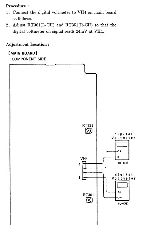

And yes, you can do the adjustment like this. Make sure the amp is warmed up.
