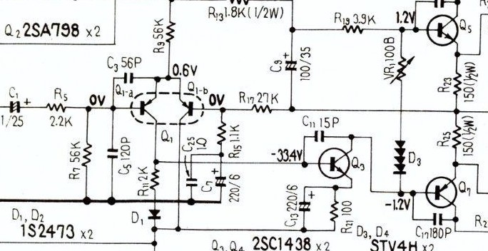

check to see if the input diff pair is either 2SC945 (npn) or 2SA733 (pnp) transistors. sony used a lot of these, and many of the transistors of these two types had a habit of getting noisy like this. in particular, i've replaced a lot of 2SC945's over the years. in fact, at one time i kept a large quantity of 2SC1318 transistors in my parts bin as a replacement part. for whatever reasons, the C1318 didn't have the reliability problems that the C945 did. the complement to the 2SC1318 is 2SA720. these devices were the japanese equivalents of the "universal" transistors such as 2N2222/2905, 2N3904/3906, etc...
I faced same problem in my receiver-amp (Pioneer SX-750) .
These input transistors packed in one case with 5 pins. (2SA798) I think
their emiters unified so can I replace with two pnp equivalent ones?
and also can you advice to me european equivalents like begining with B.... something?
Thank you very much your kind helping in advance
