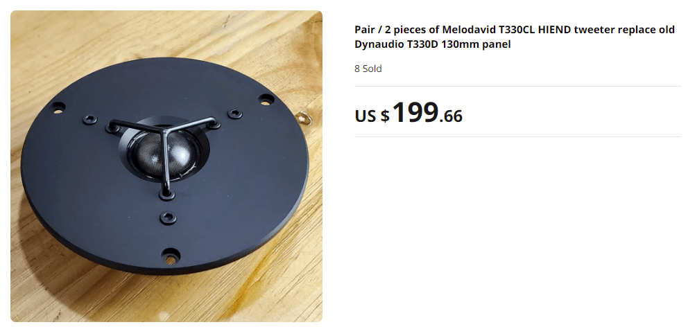

Guys the china esotar tweeter arrived ( not the dome but the melo davis or david louis type)… well my take on this is that… it sounds great BUT i havent plug end game amps on it tho. Just a good denon 800 and it sounds absolutely the same. Im just waiting for a high end amp to simply test these
well to be honest ur right but since my 1 tweeter got busted then ill try the coil that i ordered (i mean the china 1) if its not the same well… why not. If all seems doomed. Ill go for the original 1000$ tweeter tho. Just wanna try all.

A bit more seriously, if it is this, can you tell me out of curiosity how much it weighs compared to an original one?
I tried listening both esotar t330 (old not broken one) and the melo david t330 using a denon 800pma amp. The music is quite the same. (Remember i tried rewiring or attaching coil with the broken t330, upon listening to u can really tell that its different) compared to the melodavid (well this one is brand new) its quite the same sound.
BUT i havnt listened to it using audio research and maybe ill try mcintosh hi end amps and get back to you.
But fot the denon. Or low end amps its quite good.

I will check the weight my busted tweeter is still in the tech. bUT its quite heavy almost the same as the original. But havnt measured it exactly but yeah. It really is heavy.I agree to try everything you have, since you ordered everything you could! 😳

It seems like a good sign. 😉its quite heavy almost the same as the original.

Guys just an update… my broken tweeter the original t330… was fix… they rewind it… sounds great. But need to try it with good ampli first. BUT for me the china tweeters are better tho. Or its just my ears.
