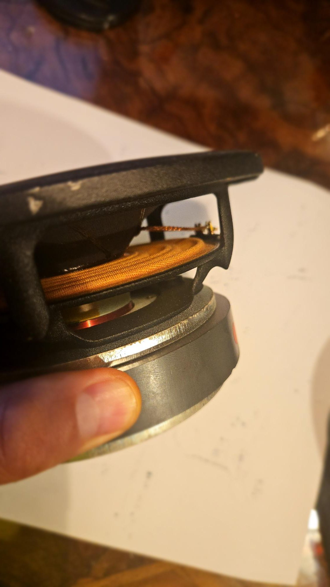

Indeed the two Scan Speak drivers have different VC heights (see below)
Not sure I can measure the VC height without dismantling the whole driver. Here is a picture of the coils (any useful?).
The 15M/4531K00 (Voice coil height 11 mm) is sold as a "MIDRANGE", while the 15W/4531G00 (Voice coil height 17.5 mm) is sold as a "MIDWOOFER".
jsut like I told. just moove cone outwards and you will see ending of VCNot sure I can measure the VC height without dismantling the whole driver.

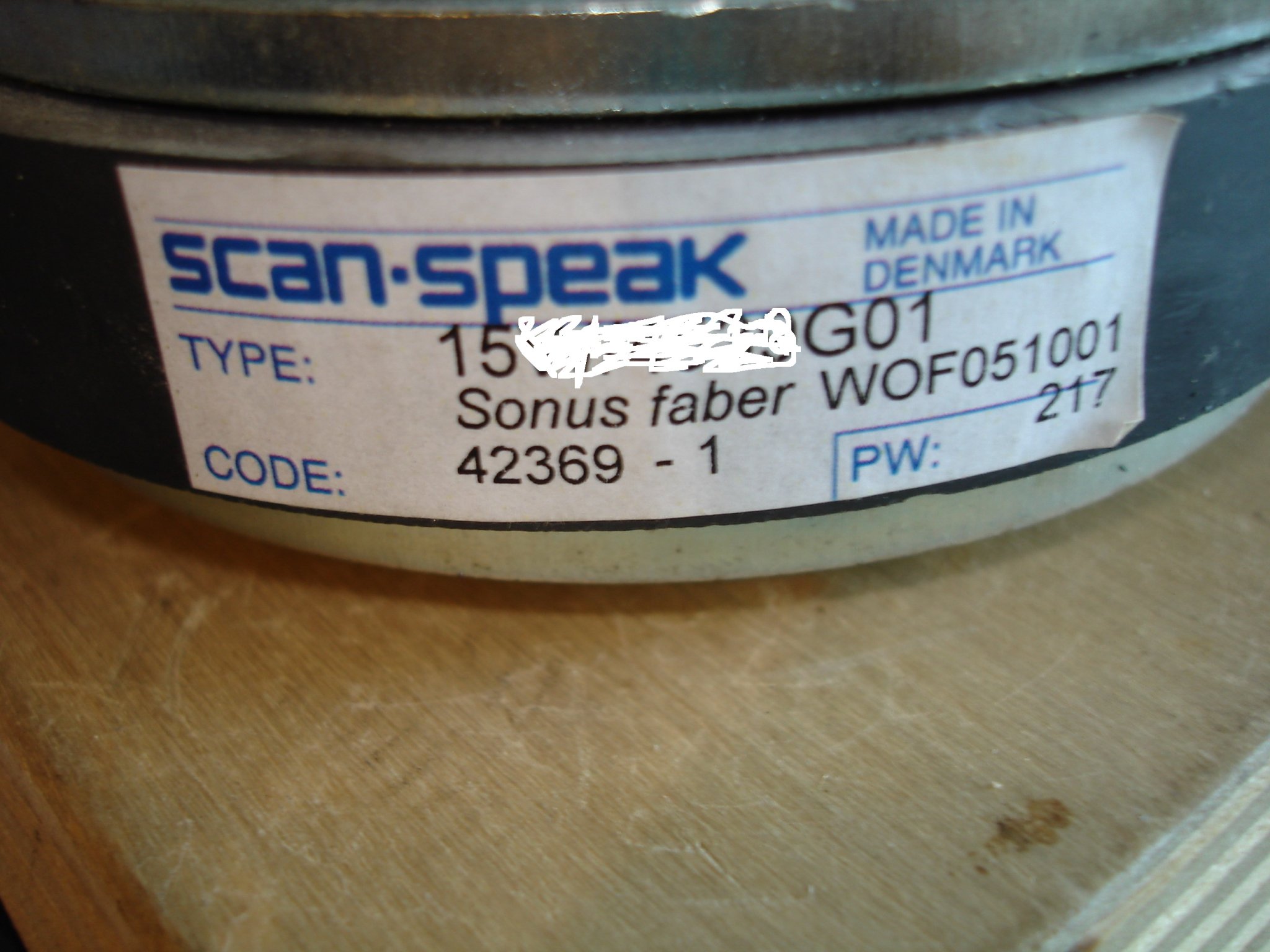

Cremona M uses SEAS units at midrange and woofer vs Sacn Speak on Cremona MK1

M series Cremona uses OEM scan speak midranges. I made few photos. Please stop spread false facts and mislead forum members.

Thanks. I tried to measure it pushing the cone. Not easy to measure it exactly since the difference in VC height is only 5mm and access is restricted. However, from what I can see, my (original) Cremona Midrange seems based on the short VC (i.e. 15M/4531K00), which is 11mm, the long one (17.5mm) might be the Midwoofer.

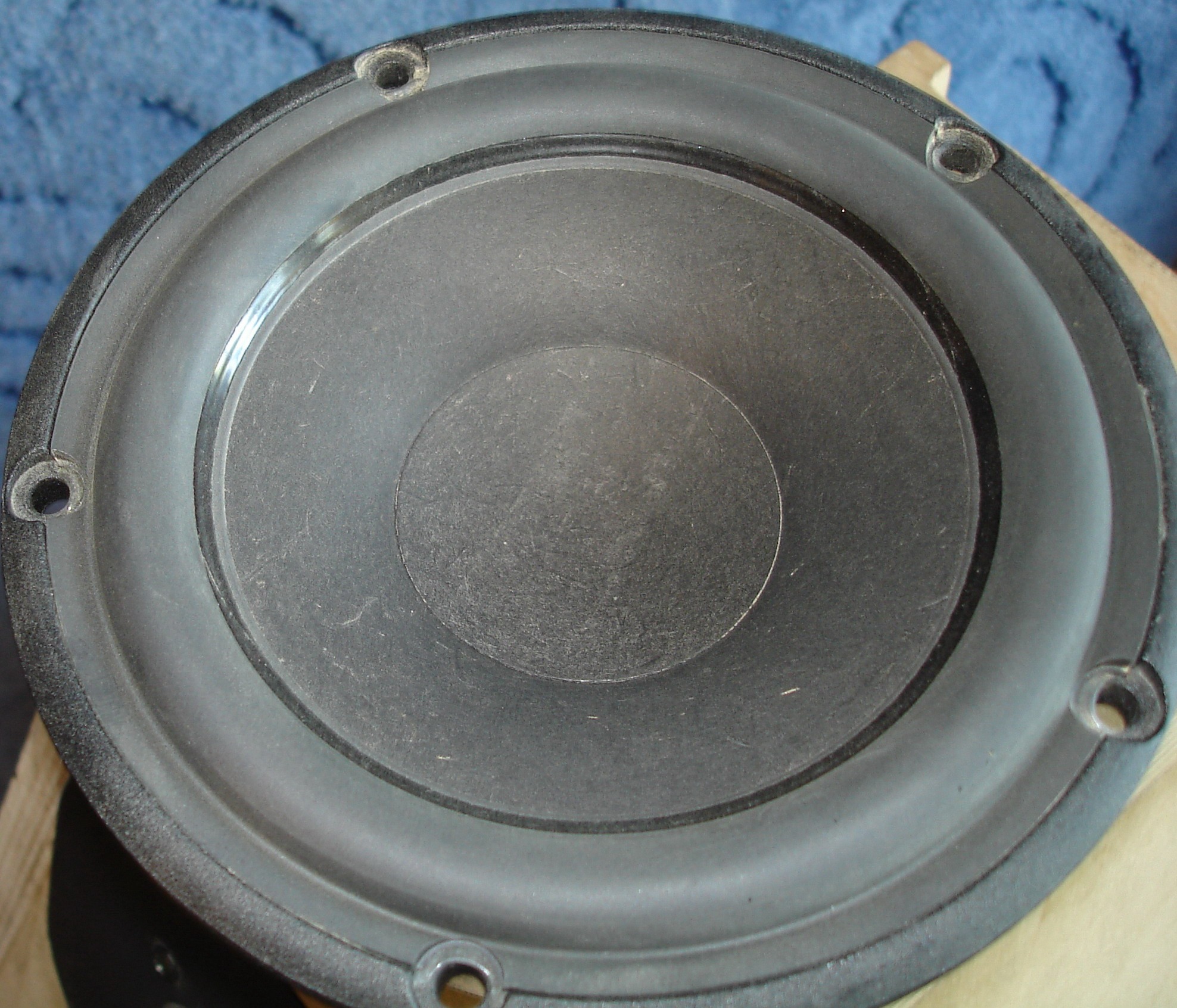

Does anybody know if there has been any real customization done by SF on this driver (they really look identical!) or SF focused mainly on the the design of the cross-over? Thanks.
(Most) of the cremona drivers have diferent cone- more fibers than scan speak versons (in M version they went to even more fibers and changed dustcap design) It does measure a bit diferently in 3-5khz , but also sound diferent. custom driver also had lower QMS. there also was slight crossover revision during production. Whether is a big concern on old speaker repair another question. Some other manufacturers had even more extensive modificatons- system Audio for example used red pulp and aluminium voice former. Hope this helps.

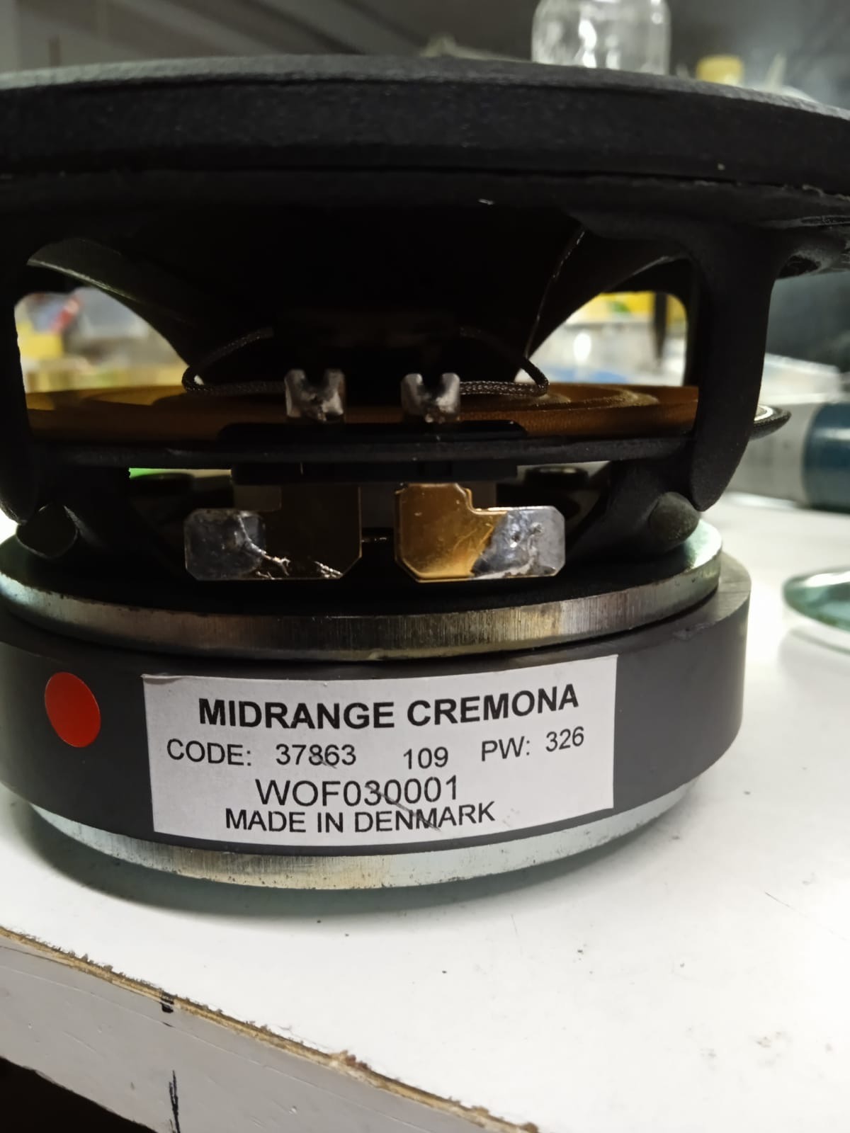

I own a pair of Sonus Faber Cremona (not M) and I was forced to disassemble one of the midranges as it stopped working. It says "made in Denmark" but the maker is not specified. Sorry I did not take a picture.Its s not first time i see member raelman telling completley false facts. On top of that he was quite unpleaseantly insistable in PM over and over again.

I proceeded and purchased an off-the-shelf ScanSpeak MIDRANGE driver (15M/4531K00) and installed it. It works perfectly well. I do not hear/see any difference from the original. They look the same to me (great news for anybody who needs to do maintenance).

I have 3 bass woofers and 1 Midrange from my cremona (non M) that have burned out. They are all scan speak. The French importer confirmed modifications without giving me any details.
The woofers have the reference wof 030002 AND the scan speak identifier 18w/8531G03.
The Midrange has the reference wof 030001 but no scan speak reference.
In France I haven't found anyone to redo the coils. The price of e new Sonus Faber bass woofers is 580 euros each. For those who are interested I have a used wof 030002 that is functional. If anyone can I would like to have my other repaired which have the coil out of order.
