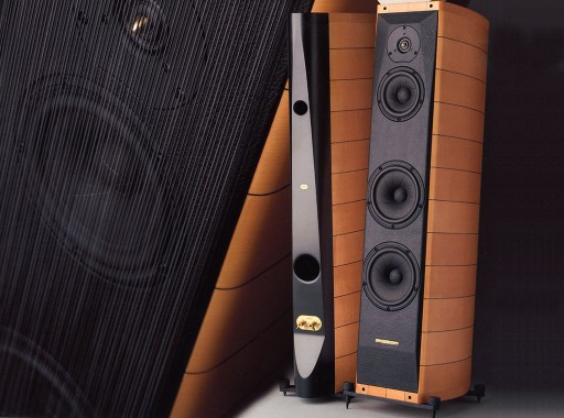

Can anyone tell me the best way to cut MFD to make this little Sonus Faber Cremona babies?
Or should I use solid wood?
(These pictures are the Amati)

Well Mateus, as for the ARIEL, I really like the final aspect of them. We were talking about it when the phone call went down...
I've thinked of making the Ariels, but I prefer the look of the Sonus Faber. Do you agree?

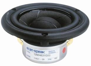

I've also know where to find Scan-Speak drivers here in Portugal!
A lot of Euros, BTW :bawling: :bawling:

In Portugal, the Cremona costs 7.400€ :eek:
The Scan-Speak drivers give a total of about 700€.
So, if I can get my goal, that is making the clones, I'll spend about a total of 1.000€.

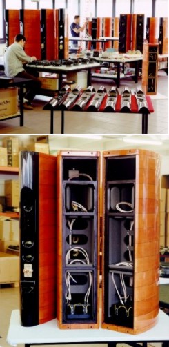

Now, about makng the speakers:
I'll made a inner box in MDF and a outer finnishment in solid wood!
That's it!
Suggestions?

another way is rob's way. http://www.diyaudio.com/forums/showthread.php?postid=68056#post68056
there are many ways to skin this cat...
1. use solid wood horizontal strips (6" wide 18" long) and bend it usng steam
2. use solid wood vertical and dove tail them into a curve (Peter Daniel has pics on this type of construction) I think.
SF uses one of these 2. i dont know which.
3. Rob's way link above
4. my way someone else provided the link already my wood wastage was less than 2%. mixed 3 densities MDF, Ply, and fiberglass.
