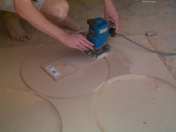

I made my own circle jig from an 8: x 18" piece of 1/4 plywood bolted to the base of my router. Like the jasper jig, I drive a nail through the ply to serve as a center point. Sometimes takes a few tries to get the diameter correct, so test on scrap before your good stuff.
With a 1/4" straight bit I wouldn't try to cut more than 1/8" per pass in oak, you'll bog down the router and risk scorching the wood.
I used the same method as BobEllis. One tip I have is make the plugs very tight, then round the inside edge with a curved router bit, this will make it easier the push in when the material has been folded over the edges.
