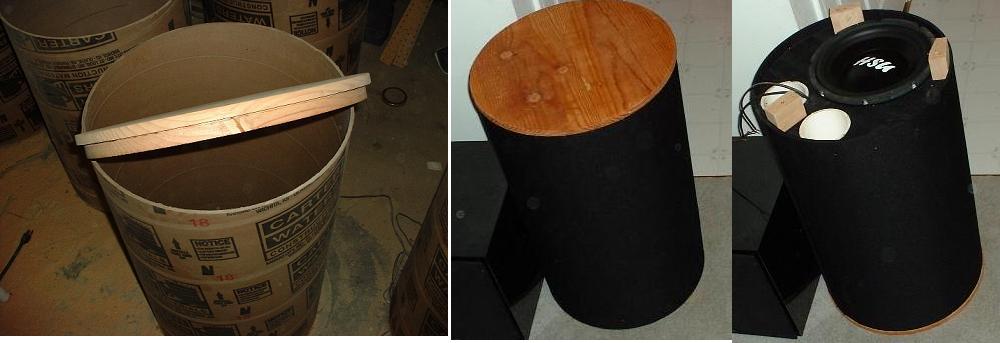

A sonotube build will amount to a ported box. (Or a less than perfect transmission line.) So it's not going to be anything special just by virtue of using sonotube.
Most of the sonotube builds I've seen were large and low tuned EBS type designs in which ability to play low notes trumps ability to play loud. From my expert profiling above you can see that I've guessed that you might prefer loud to low, please correct me if I'm wrong. Low and loud are at odds with each other in this game, pick one or the other or a bit of both. But not a lot of both, not with a single 12 and 300 watts.
If you want loud, do it the same way the car audio guys do it. Pick a decent (or better than decent) high q driver, put it in an undersized box and tune it too high. Tuning = lowest room mode for max expletives from your friends when showing it off. Stick it in the room corner, preferably in the basement with all solid concrete walls and give it all the power you've got.
Or if you want it low, build it large and tune it low. But a single 12 with 300 watts and a low tuning won't impress anyone unless you have a ridiculous amount of room gain.

How about a bit of 'how to build a sonotube' info, instead...
Plenty of good 12" drivers that will work in these cabinets. I won't go into driver selection unless requested. 4 cu.ft. and 25-28hz tuning is about the best compromise between loud and low for these guys. That means a pair of about 20" or so long ports. The 'tuning' that svs, hsu, etc and others in the sonotube builds have done is plug a port to drop tune. That way you can have the best of both worlds, more spl when needed, and lower when needed.
The biggest problem with sonotube is its light weight. It's bad when you have to sit a person on top to keep them from dancing around. Build 2 -- one front center wall, rear center wall, or front/rear diagonal corners works best.
