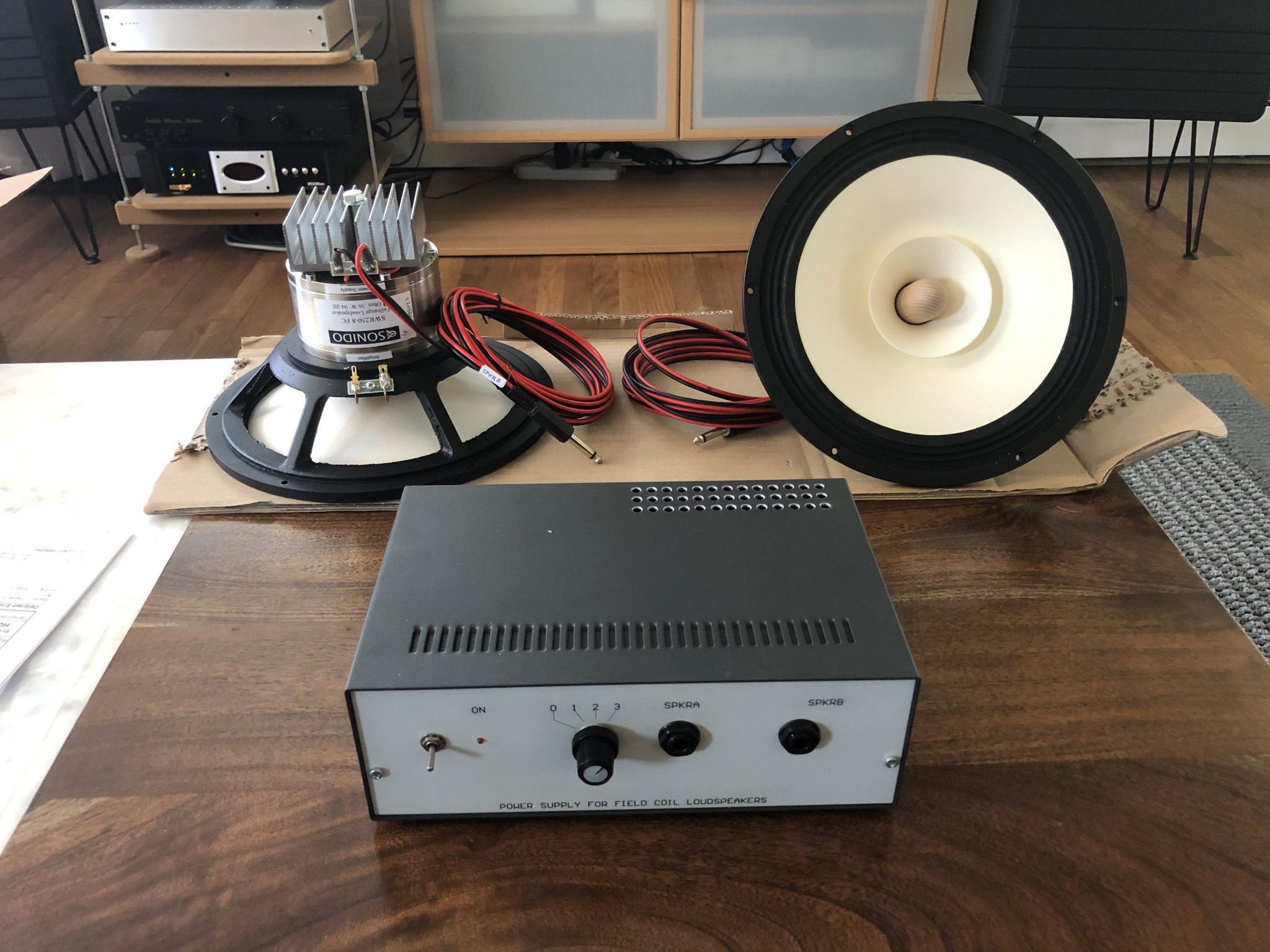

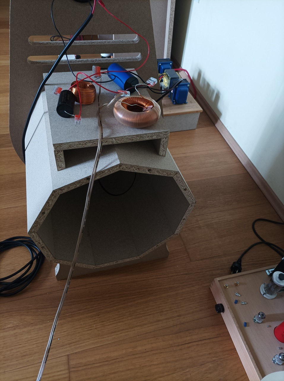

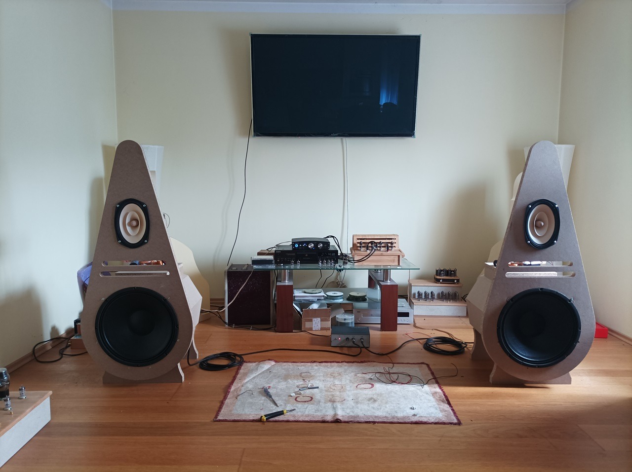

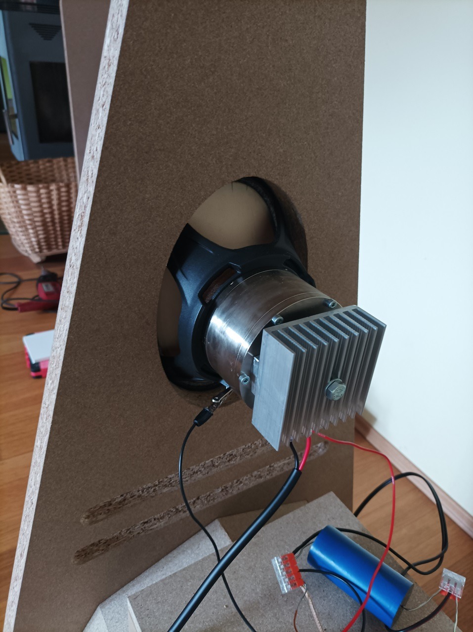

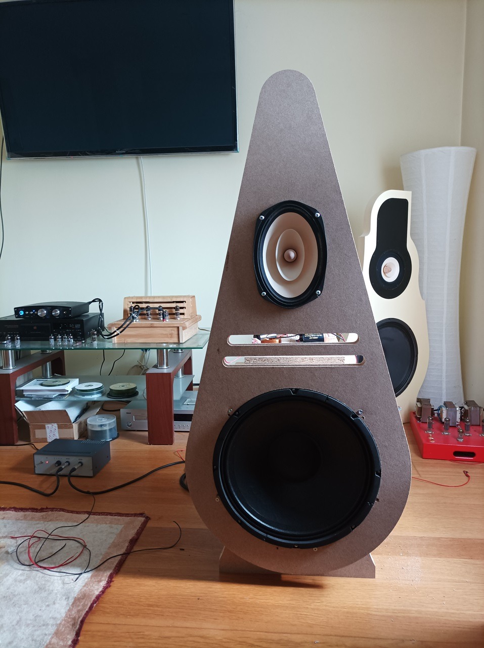

After too long I finally got around to making new speakers.
The project is still a test for now. Hence the use of materials. Crossover is still 1.0 version for now. The units are still new.
I used the SB 15OB350 for the bass and the Sonido FC SWR 096 for the FR.
The sound is very good right from the start. Maybe I caught the frequency cut quite well.
A few more pictures:

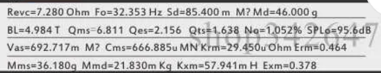

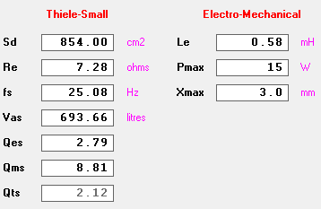

Re specs, I've 'interpreted' some of Lii's specs and made some assumptions based on actual measured specs of other models (Le, Xmax), which historically had pretty far apart responses, but these actually work out once you ignore all the extra 'doodling', though its 95.6 dB SPL is quite optimistic as is the usual case. 🙁

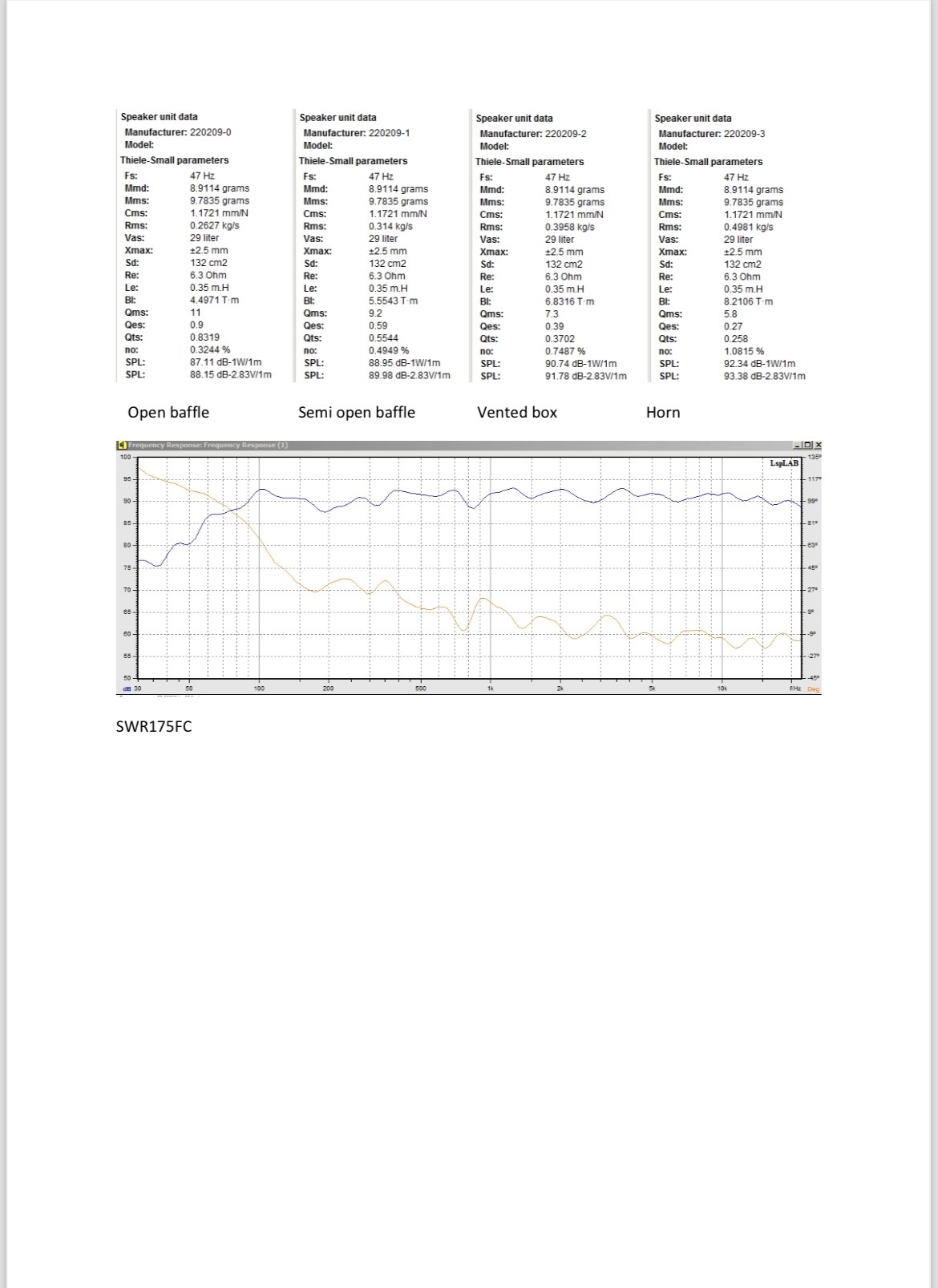

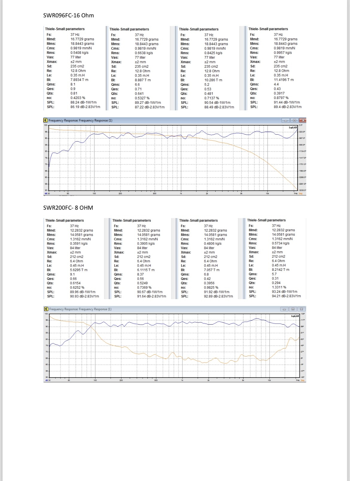

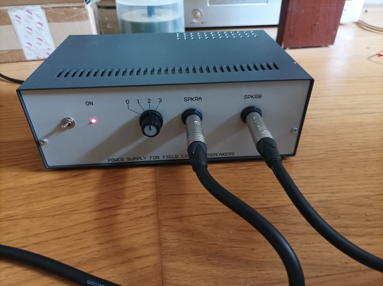

Whats the commonly observed sensitivity rating of a speaker like this? I haven't owned any field coil drivers before, but heard a few of them at various shows. There's a sense of immediacy in the lower mids I haven't heard with most other permanent magnet type motor drivers. Is it feasible to design / build a higher power and output field coil speaker for PA type designs?
I attached some examples of driver measurements that were previously posted by Istvan of Sonido. It appears that the amount of current run through the electro-magnet can affect sensitivity.

Can't imagine a Qts under 0.2 being practical for a horn loaded cone driver. The low end response would be slim to none.
Lowest Qts I've seen was 0.12 on a custom 12" midbass with an EBP of 720. The upper pole plate thickness was. 0.625" with a 0.750" VC height, with 20 x 1.5" dia x 2" tall N52 neo slugs. Testing the impulse response with a 6V battery sounded like a deadblow hammer hitting a plywood wall.

I listen to the speakers for a couple of hours a day. I also test different crossovers.
For now, just hearsay. I changed the caps on the Sonido SWR96 for better ones.
Then I test a combination of top quality and high class. I also tested without crossover on Sonido SWR 96A.
And I finally went back to the original crossover, with the original test material, because it sounds the best.
Next week I will do more measurements with the microphone.

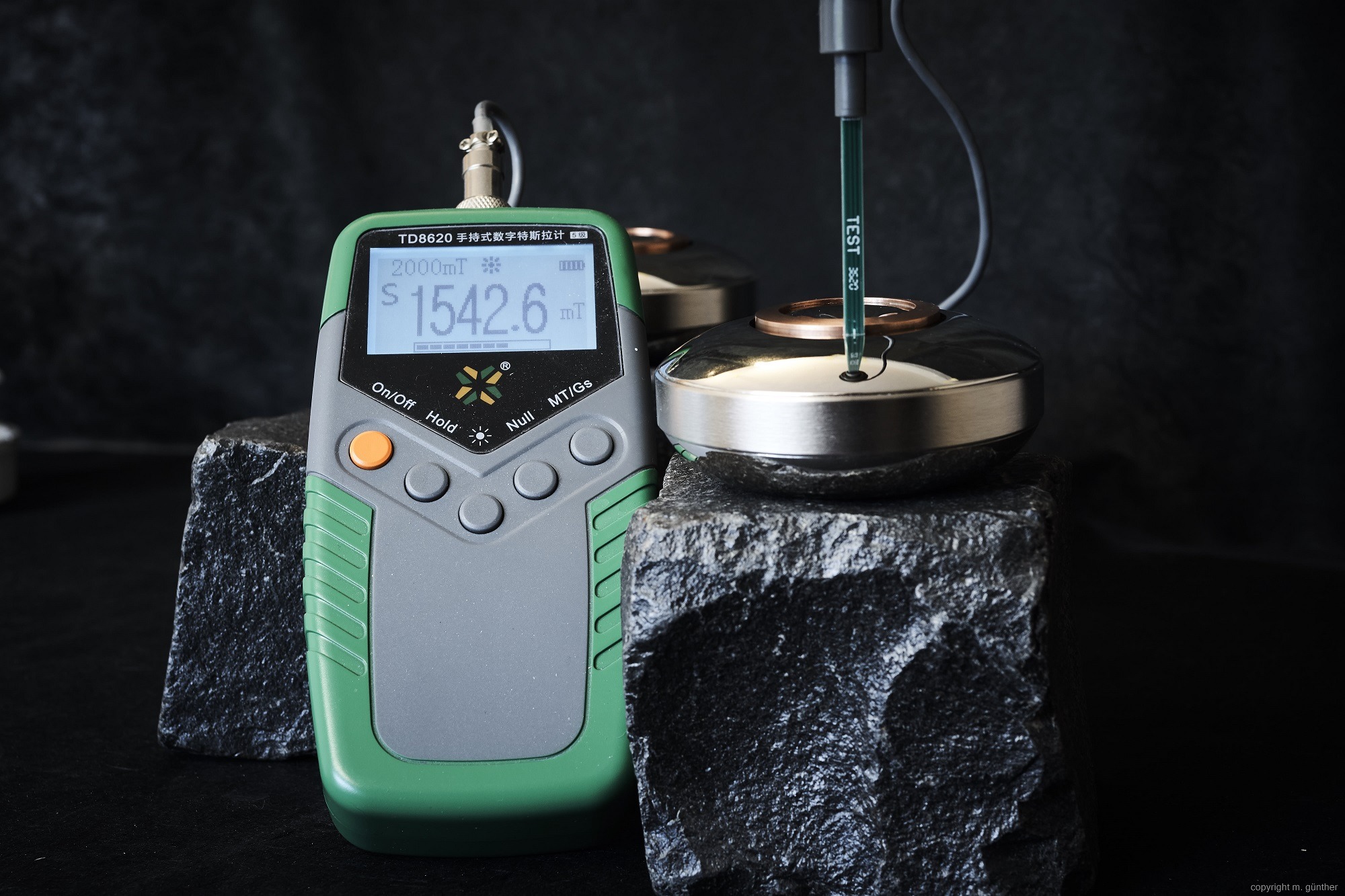

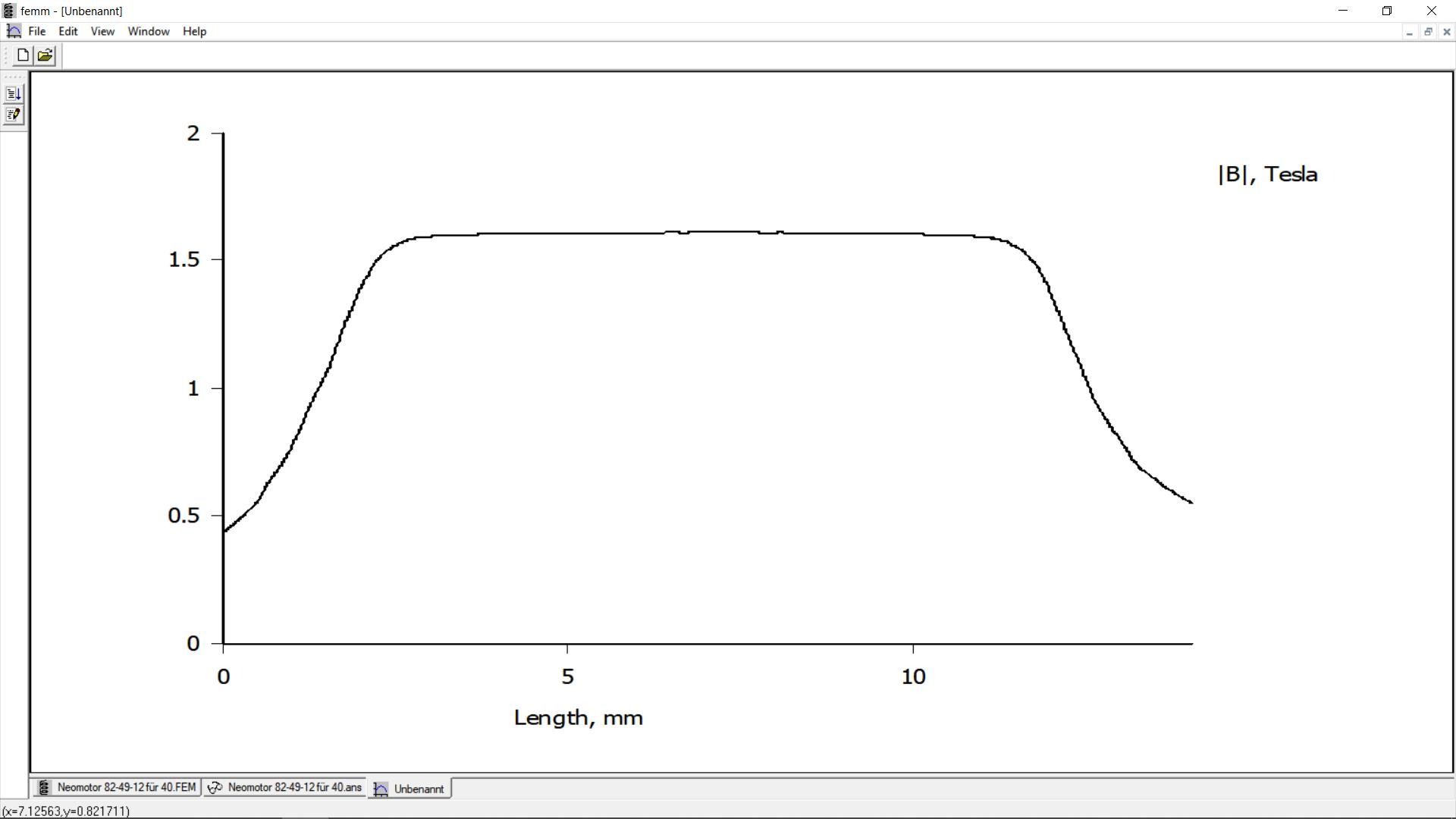

Please don´t misunderstand - no offence intended, but I would love to see a driver with 2,1 T in the airgap - measured, not just claimed.
The trouble is that low carbon steels saturate around 2 T, depending on carbon content. Very expensive (and difficult to machine) Pure Iron saturates at 2,18 T, even more expensive Permendur saturates at 2,35 T.
If you manage to saturate the steel inside and outside of the airgap (which does not only require very strong magnets, but also requires to get the geometry right. Just massive slabs of neodymium or giant field coils are not enough), the air in the airgap will significantly reduce the T value in the middle of the airgap, where the coil is.
For 2,1 T in the airgap all steel parts have to be made from Pure Iron or better, and the airgap width has to be nearly 0. That is not feasable...

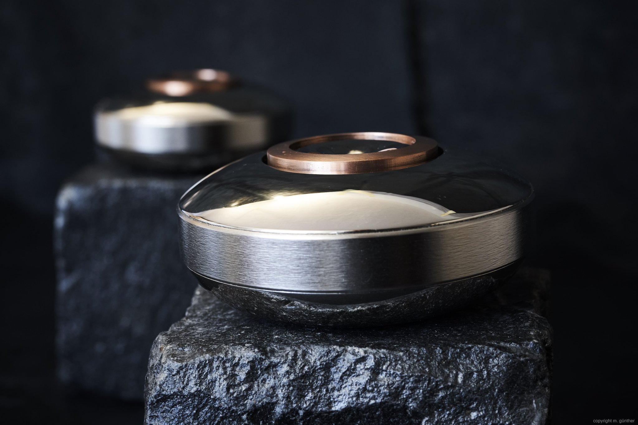

I hope I´m allowed to add an example from real life, built, tested and measured:
My own motors have custom made Pure Iron steel parts (these cost several hundred € alone) and a custom made N52 magnet. Poleplate and core (the core is the culprit...) are fully saturated at 2,18 T.
In the middle of the 40 mm x 10 mm airgap with a width of 1,3mm (a bit of which is occupied by a copper cap, the remaining width is needed for reliable centering) magnetic strength is reduced to 1,54 T due to the air in the airgap, this is what remains of the 2,18 T.
This has been measured.
Of course, the driver with a Qts of 0,13 is nearly unusable for bass (and that was never intended) and is a high speed and high resolution device, not a universal solution.
Please accept my apologies for the off-topic content. Back to Sonido. Would have loved to make an oval driver myself, but a round one was a lot easier...
All the best
Mattes
