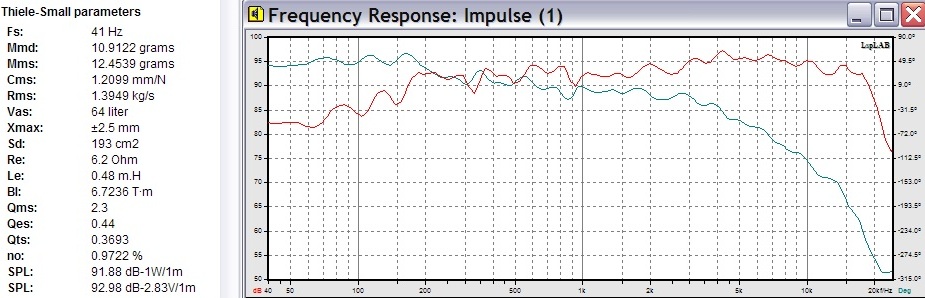

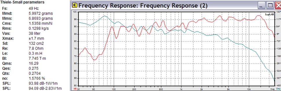

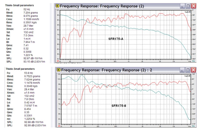

Hi to all,
herewith I post some technical data for Sonido drivers for guys, who looking for:
Some explanations:
A - for alnico, No A - ferrit, SFR -SuperFullRange for BLH, SWR - SuperWideRange for BR.
There are also SCW-midwoofers from dia 200, 300, 400 mm.
I already built 2 enclosures BR with SWR145A (12 Liter-box) and SWR200A (52 Liter box).
Now is building of BLH on driver SFR175-8 in progress.

Hi Sergii,
Really interesting!
Can you provide some detail on how you took the measurements? For example, I assume the drivers are mounted in the cabs, and the measurement took place indoors? If so, could you say more about the room dimensions, the speaker's proximity to the walls etc.?
Thank you in advance!
Hi Sergii,
Really interesting!
Hi, rjbond3rd,
all graphics I`ve got from the manufacturer Ishvan Varga (Sonido).
all measurements were done for dia:
145 in closed encl. 10 liter
175 -//- 16 liter
200 -//- 22 liter
on axis from distance 1 m.
Room dimensions - 30 m2 (5 x 6 m), relevant for LF till 300 Hz
Additional to my first post: the second FR is for SWR200A

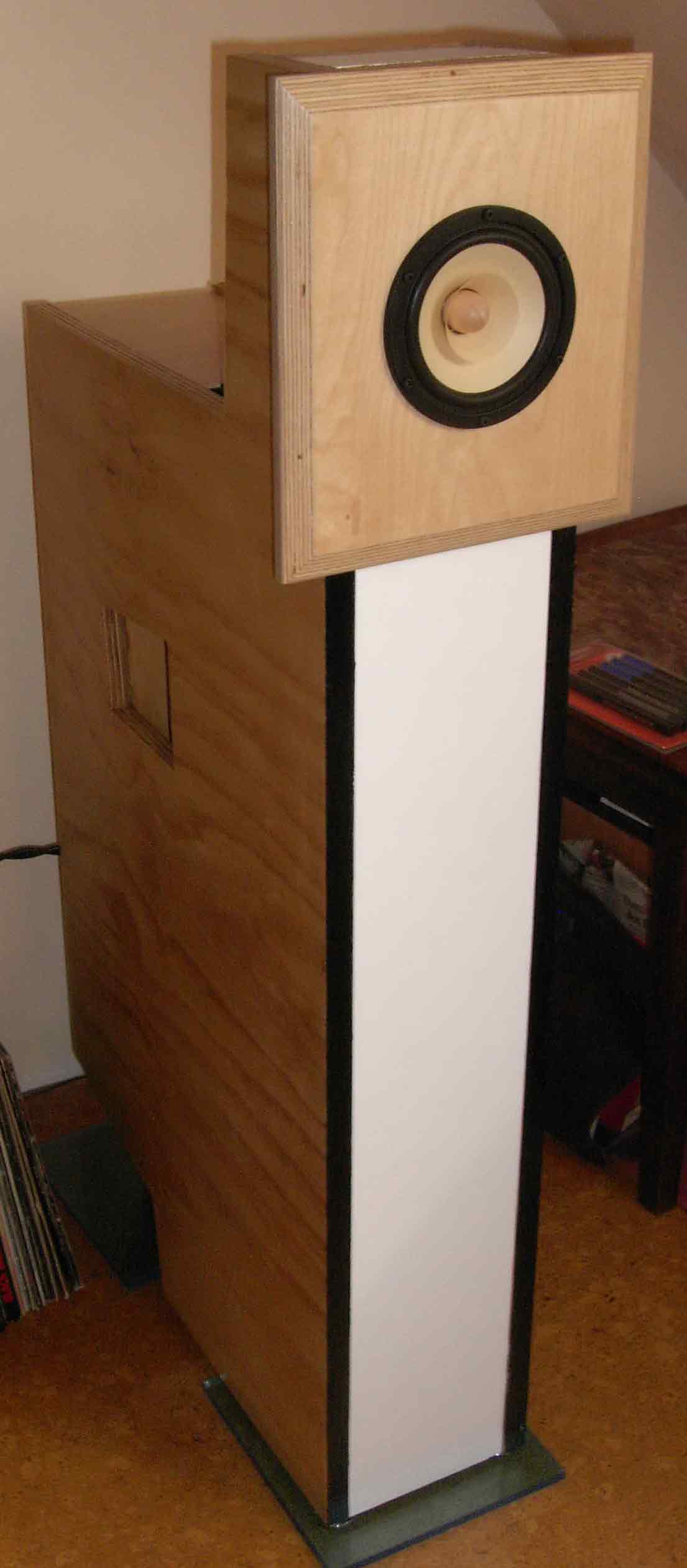

Hello,

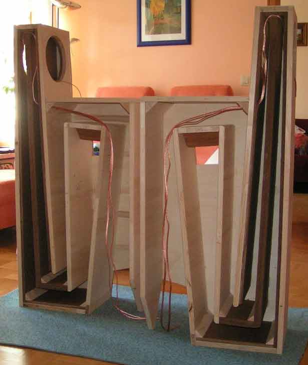

my KORNETT, POSAUNE is built with the 145 + Sph135 Monacor,
exellent feedback, goog..Translate helps.
kornett FB in the middle
in this case a 160 mm width inside
posauplan
for the 175 the Posaune
for the 200 Posaune with 280 mm width inside
and a bass, size up to 150% to the front driver
invers with +- change.
with feedback, measurements

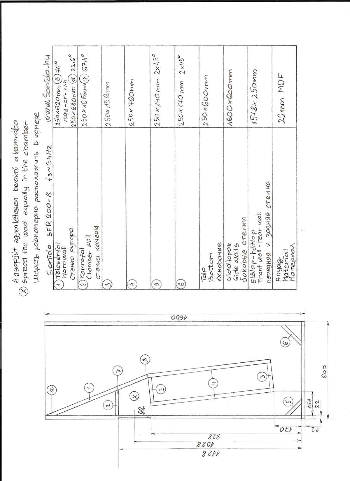

they're in box made by Sonido plans
pictures are here Sonido Proto Ayon - diyaudio.rs
it's pair made by my friend Igor (SuperFi)
there are some plans to make another one lsp with SWR200 AlNiCo on OB and either 12" or 15" Sonido in ML TQWT
we'll see when ......

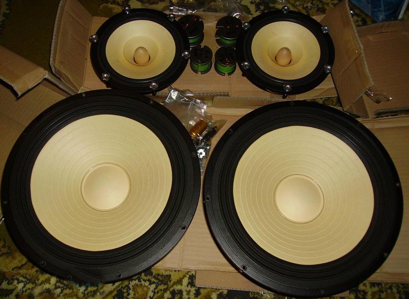

Sergii,
Do you own these? What enclosure are you going to use? How about a picture of the rear of the driver. I purchased the SFR200A and I am thrilled with them, a fine driver.
BDP
This picture sent me Ishtvan because I asked him. I only ordered a pair because I finished now BLH with an old SFR175-8 and would like to test these drivers in my new enclosure (take a look in photo galery here).
Ishtvan said the sound is the same but he test all driver in closed enclosure (SFR175 in 15 liter). For BLH I made a new simulation with a new driver in hornresp. So bass is deeper - 50Hz (- 0dB).
I think Sinido is very good driver with very natural sound.
Rear is always the same depends only on magnet type - alnico or ferrit. The alu-basket is very simple but stabil
