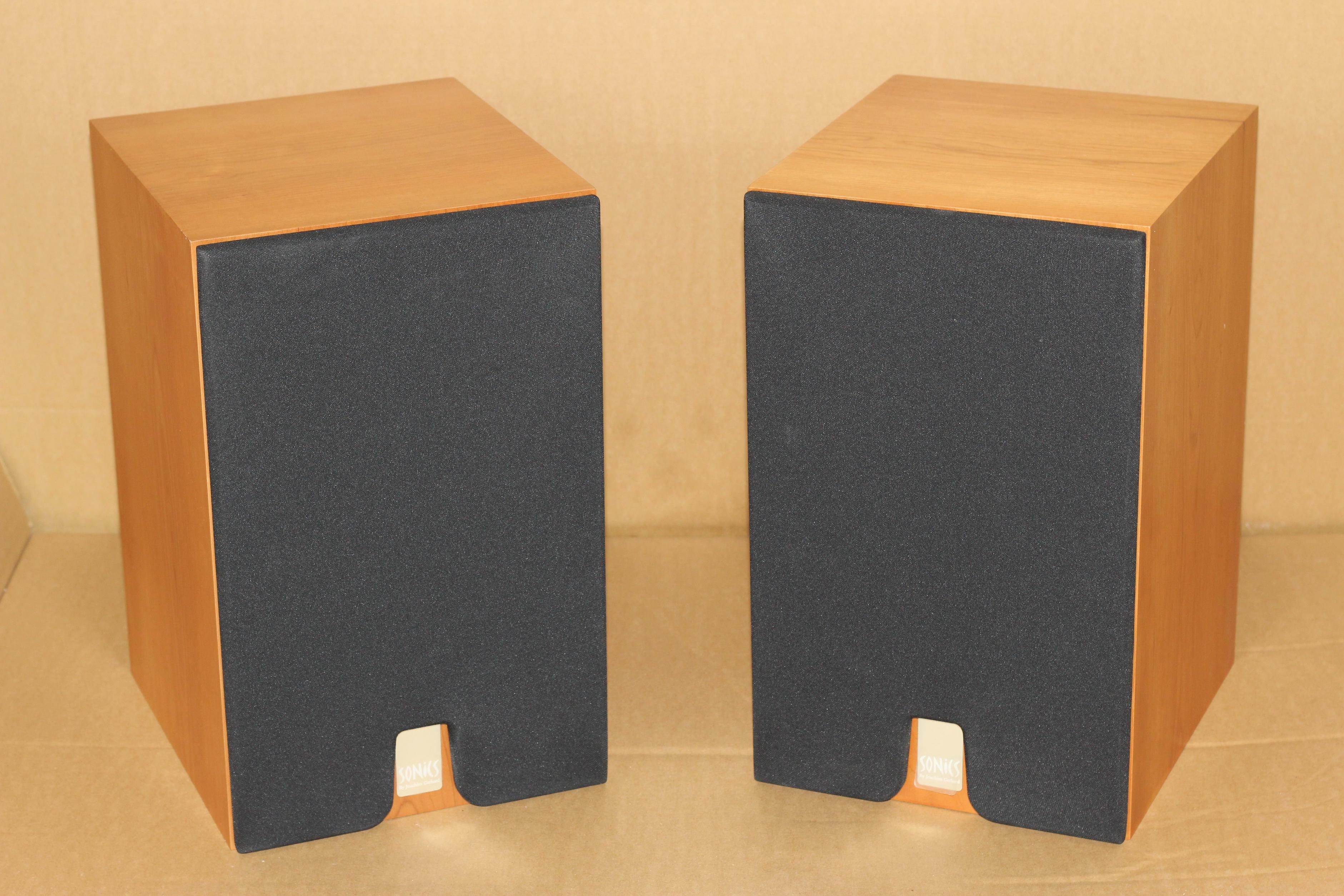

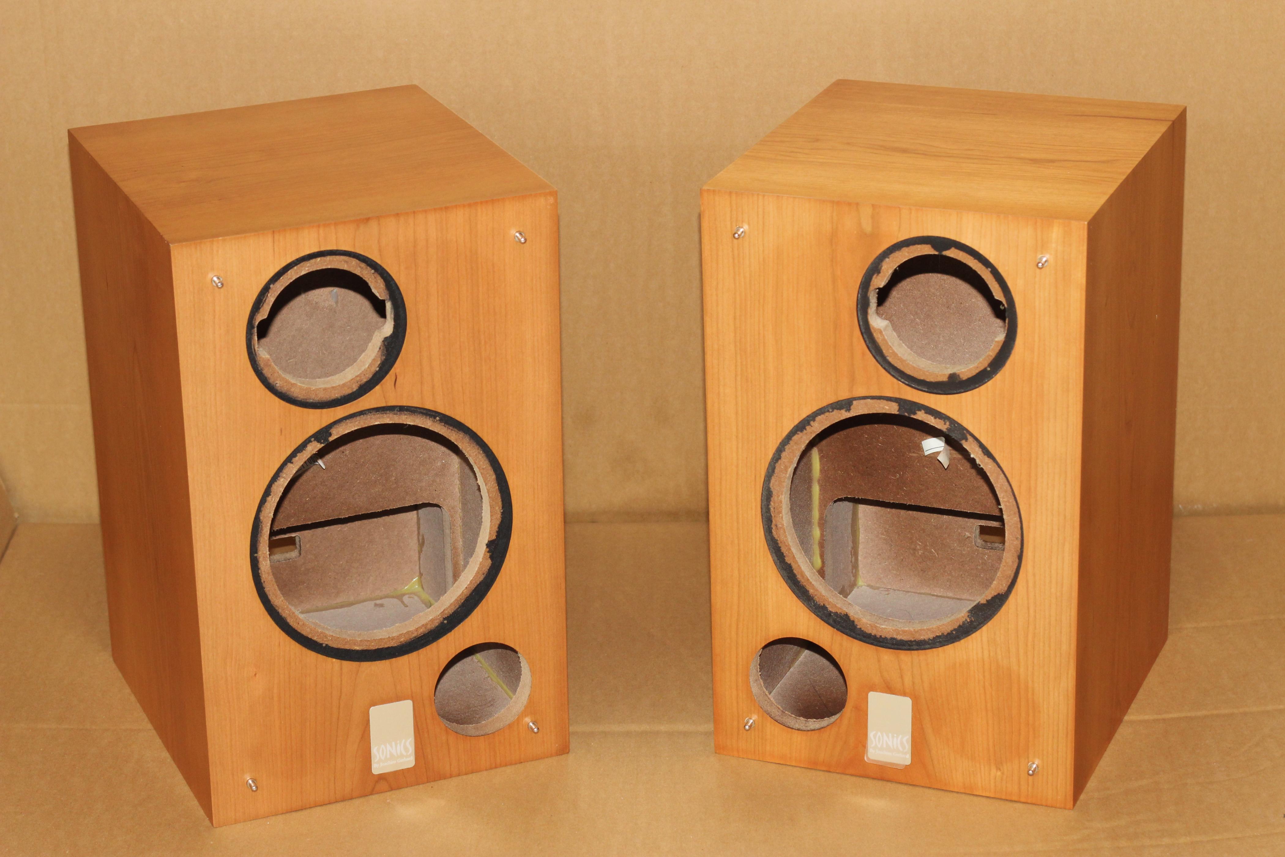

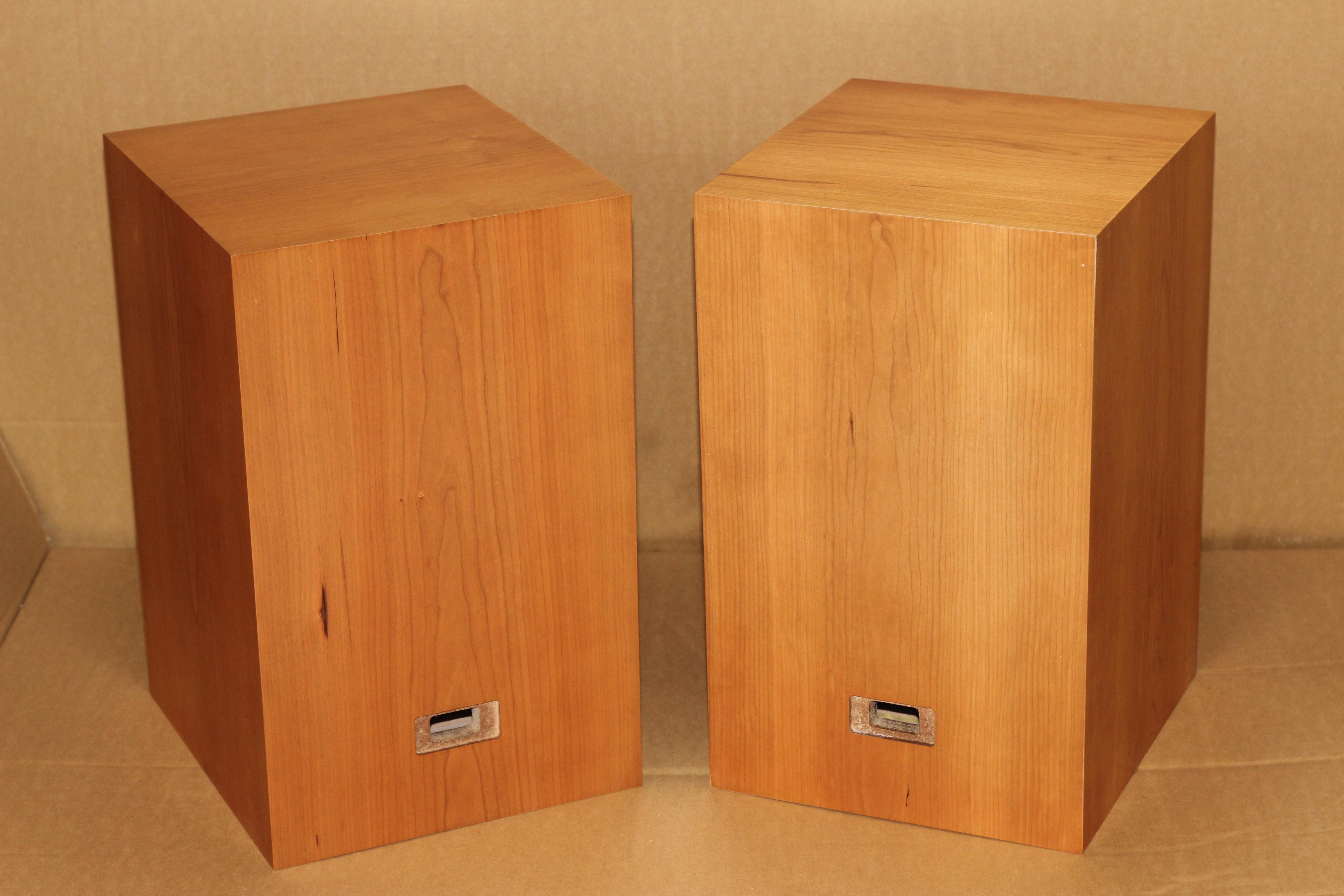

Today i offer you a wonderfull pair of Sonics Argenta cabinets in cherry for 400,-€.
This pair goes for 400,-€. You will get information how to build this speaker. Circuit diagram and what drivers to use.

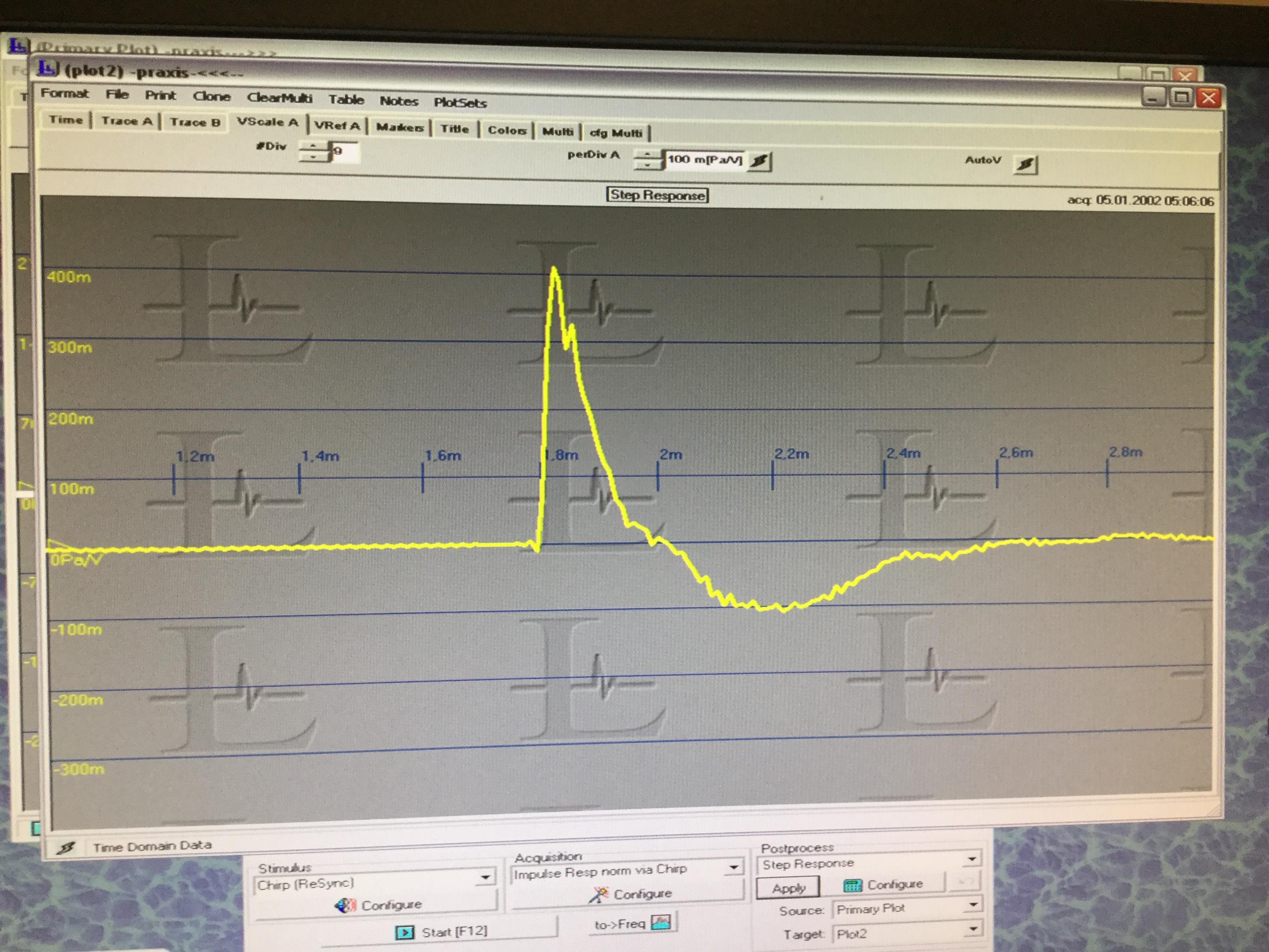

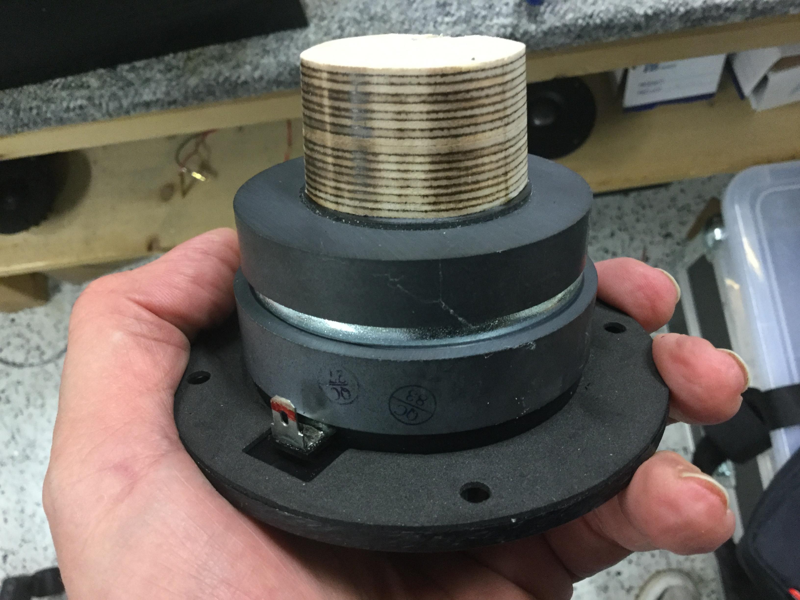

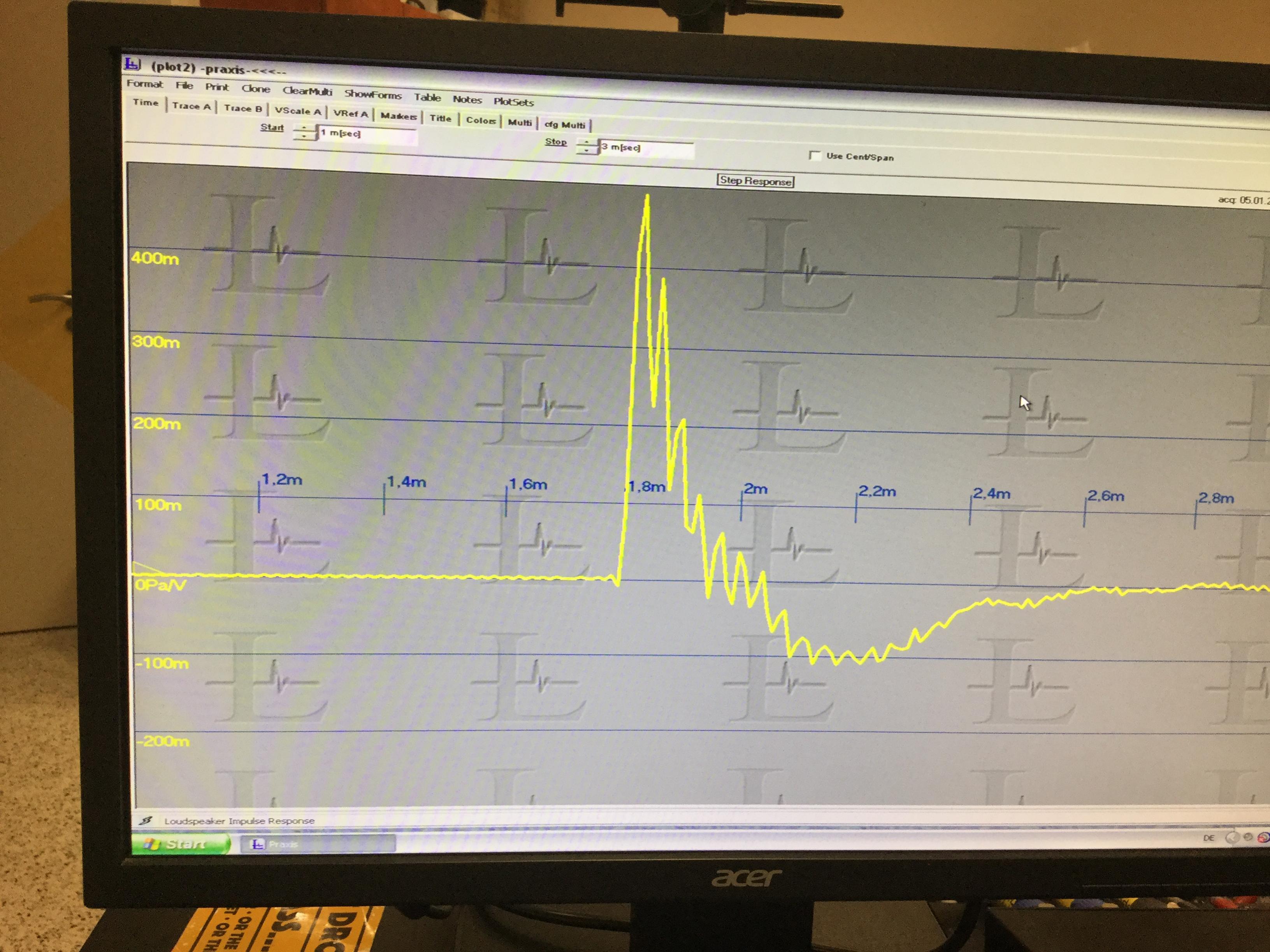

I modified the tweeter. It has a rather flimsy round paper thingy to close the volume in the back so I added some damping and stiffening in the form of multiplex wood.
The ca. 27kHz come brackup is controlled by a precision trap. This proved rather difficult.
I needed two days to find the optimum compromise.
The improvements show as lower intermodulation distortion and optimized Impuls response.

Here are pictures of the modified tweeter and the step response before and after using the trap.
This was recorded with a 96kHz sampling rate and 16Bit.
