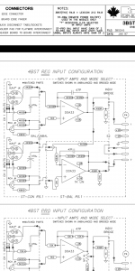

What you have is raw 3b modules
The coax are the single ended input (could use as is for stereo)
Id you want to bridge them mono one need to go through an inverter buffer.
Any question?
The oder wires in the connector are supply and ground.
+5v and +15 and -15

So I've done a bit of digging through some schematics and see where I need to get creative and make some stuff before just slapping a pair of RCAs on and based on some conversations and half memories I believe this is the circuit I need to replicate in order to interface with the connector in my previous post.
Although the circuit is listed as being for the 4b, all other amps seem to employ the same values in the circuit, so am assuming this would suffice.
