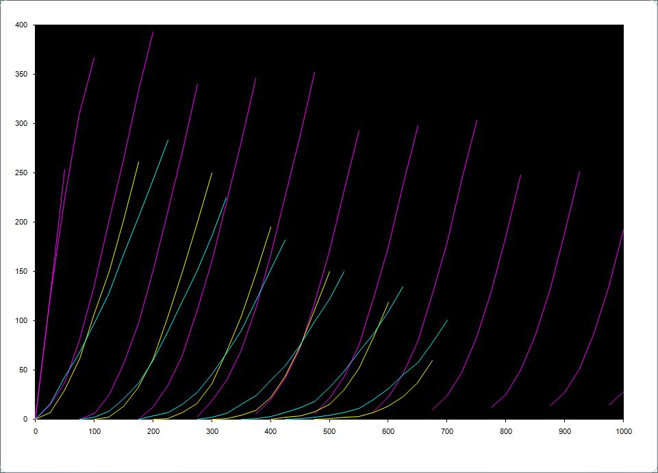

Why not Andy? KT88 is a great tube if you know how to use it! Attached is a picture comparing KT88 triode connected, 300B, and KT88 pentode connected with 20% of plate signal fed back to the grid. Mu of KT88 triode is 8(blue), KT88 with plate-grid feedback is 5(pink), and Mu of 300B is a little less than 4(yellow).

DHP, you mean right?;) I love screen grids, they let you do so much. If I ever make a big amp, it will use 813s.
2E22 looks like a lot of fun. To get similar power out as a KT88, you will need to put some power into the grid. My take on a design would be plate-to-grid feedback (turn those pentode curves into triode-like curves) with a follower inside the loop. Are you planning on opening a new thread on your new amp? I don't want to hijack the current thread, but would love to see your plans on driving the 2E22.

Here is an amp I built using this principle with KT88s.
Now, if you wanted to do it with a 2E22 or an 813, the feedback network would not be able to drive the grid positive. You would need to have something (a mosfet or tube) buffer the signal at the grid so that it could be driven positive. It really isn't worth that level of effort, in my opinion because tubes like KT88 and EL34 work so well and don't require any positive grid drive.
I don't have much experience with positive grid drive but when I was researching it I really only found that the 6L6GC is the only tube (out of all the common audio tubes) that has that sort of operation in the datasheets. I don't think they were designed for positive grid operation.
