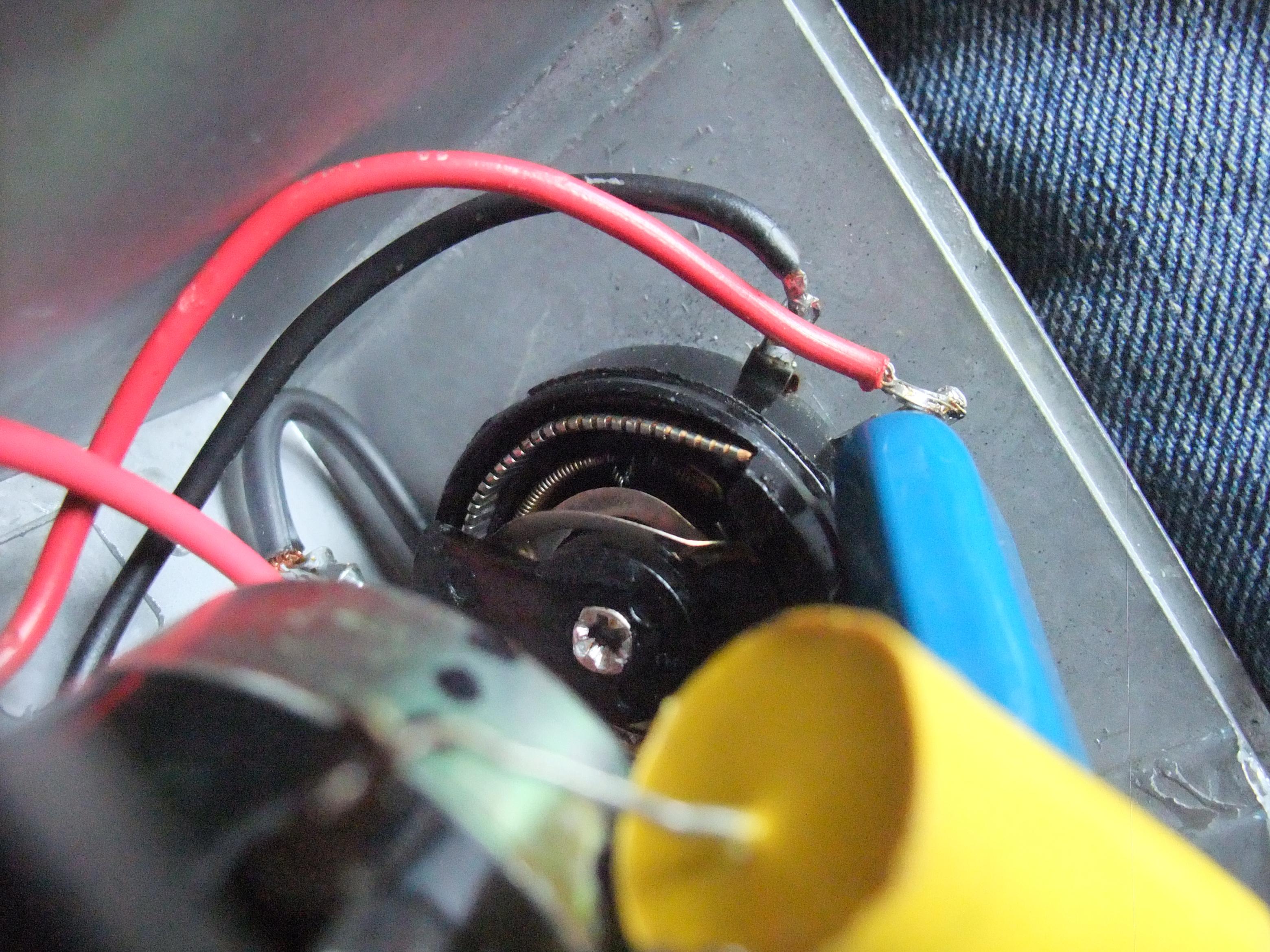

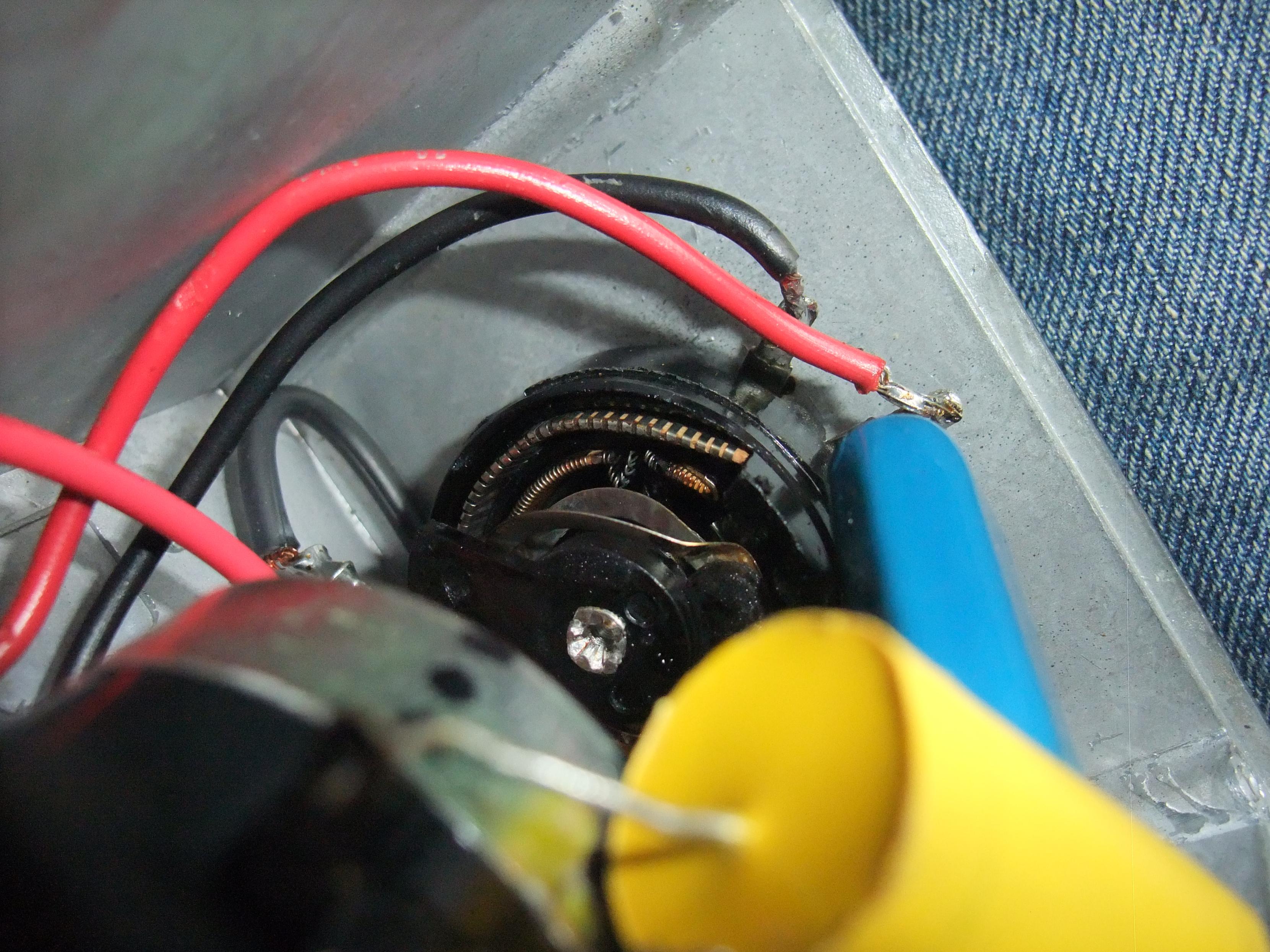

The usual part therefore in 8 ohms looks like this one under
MONACOR: AT-62H.
Disadvantage is, that this attenuator consists of turns of a special resistor wire - consequence is a lot of crackling and distortion after short using - initially only while turning.
I think this is due temporary overheating during dynamic effects - go to the attached files.
Are there versions on the marked with special kind of resistor wire without this disadvantage ?
I know the best are Caddock resistors - go to
http://www.caddock.com/Online_catalog/Mrktg_Lit/MP9000_Series.pdf
and coding plugs/bridges - go to
Connecting plug KS2-...3
but nevertheless I want to know a solution for stepless attenuation.
Maybe this parts are an alternative:
https://www.fostexinternational.com/docs/speaker_components/pdf/att.pdf
