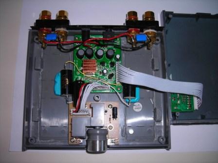

I am out of town right now, but when I get back next week, I can pop open the lid and snap a photo. Basically, I removed C3 and C4 and soldered some 0.5mm Mundorf Silver-Gold wire to the pads. The pads are extremely small and delicate, so you have to be very careful when removing the SMD caps without damaging the pads. You'll have to use small diameter wire (22AWG or higher) to cleanly solder it to the pads. Anything larger can make things rather awkward. Next, I planted a drop of solder on top of the pads and positioned the wire on top of the solder bead before heating it. Some hot melt melt adhesive on top of the pad and wire joint will help as a strain relief. Then I soldered the shortened Axon cap leads to the wires and used some Blue Tack adhesive to dampen and hold the caps down to the chassis. I wouldn't spend too much money on the input caps, so something like the Radio Shack Model No. 272-1055 metallized Polyester film caps (1.0uF/250V; you'll need 2 pcs/channel) or the Axon 2.2uF/250V metallized Polypropylene film caps are fine.
To keep everything within the confined chassis space, I had to cut out the molded-in battery compartment to make room for the speaker binding posts and the input caps. A good hobby knife and a lot of patience will work here. I also had to bend the leads of the Panasonic FM electrolytic cap (C10) to orient the cap horizontally since the cap is too tall to fit under the lid standing up.
It sounds like a lot of work, but if you plan things ahead of time, it really doesn't take much time. The hardest part was removing the molded-in battery compartments without damaging the enclosure. Aside from the Vampire binding posts on the outside, it still looks like a stock unit. Your reward will be deeper and better defined bass, smoother and more detailed midrange, lower noise floor and a larger soundstage. As others have said, there are better T-amps out there. However, like you I just liked the challenge of working with the confined space of the stock enclosure while significantly improving the sound.

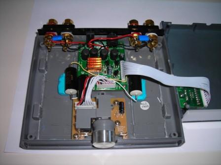

Rich, do you have any photos of the mods you've done to the gen 2? I'd like to see where you placed everything inside the stock case.
Here is one shot of the SI Gen 2 T-amp I modded using the stock case.

Here's another shot of my modded SI gen 2 T-amp.
