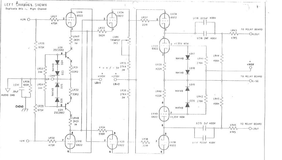

Here y'go! The guys over at PC are the best! Sometimes it takes a bit for them to get back to you, but they go above and beyond..Would you be so kind as to send me a message...I'd love to have a copy of the schematic for the SFL-2.
Thanks!

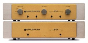

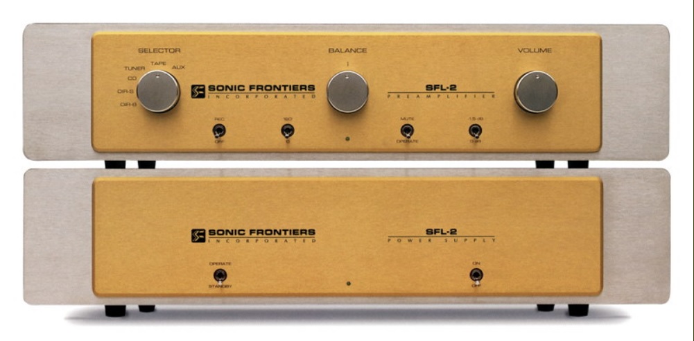

Thank you, much appreciated! I just picked up an SFL-2 today. 🙂Here y'go! The guys over at PC are the best! Sometimes it takes a bit for them to get back to you, but they go above and beyond..
I just got one as well.. After installing the correct coupling caps for my amp... It's as good as I've ever heard any system. I have the SF Power2 for the amp... the input for balanced was at 200k Ω so I first installed at .47µf V-Cap Odam, but I thought I could do better on the bass end, So I went up to a 1.0µf bypassed with a .015µf cap, and it's just gorgeous sounding now... good luck, and feel free to reach out if you'd like any of my takes on this pre and amp... MickeyThank you, much appreciated! I just picked up an SFL-2 today. 🙂
