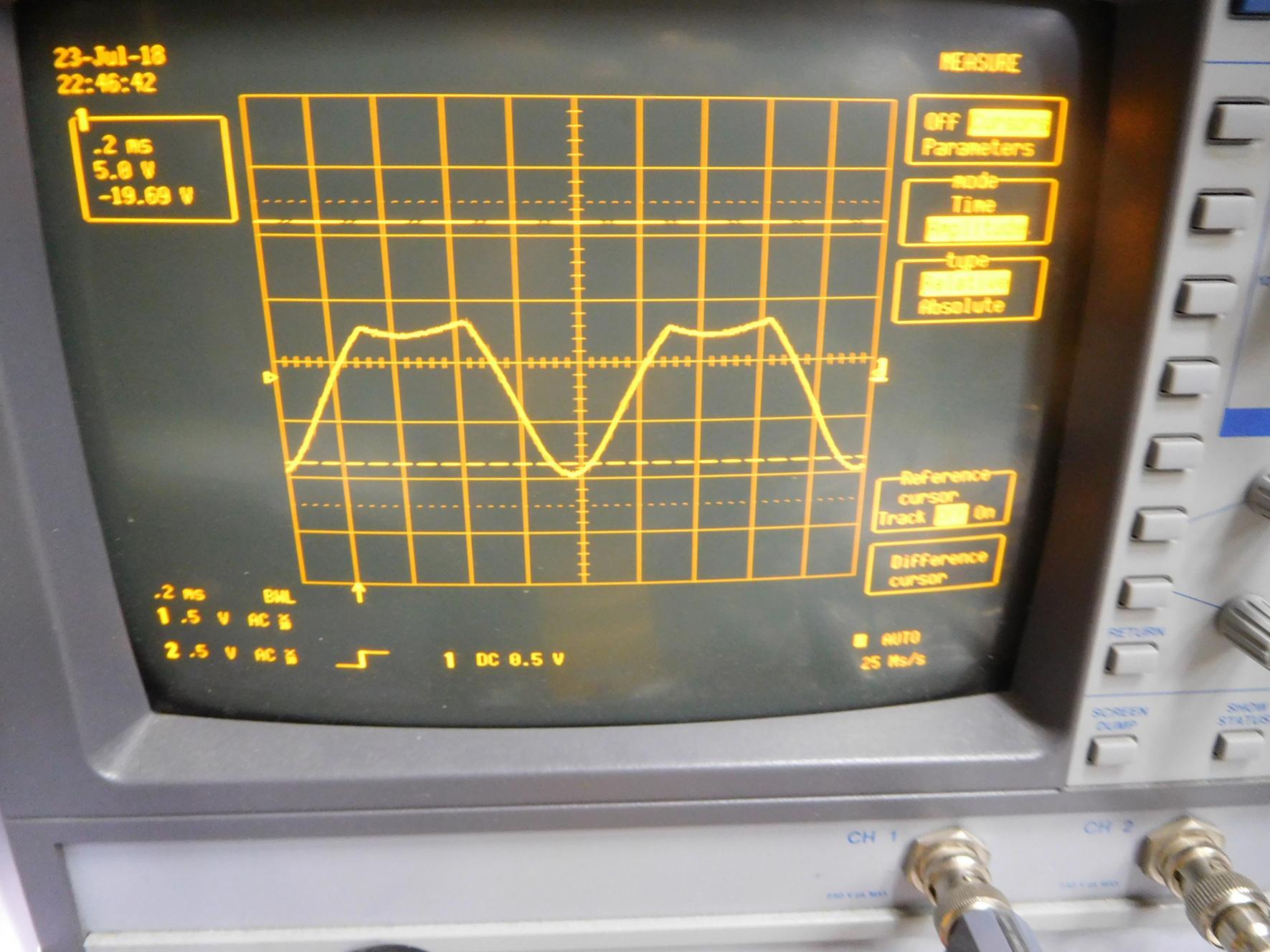

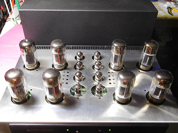

Hi my friends,

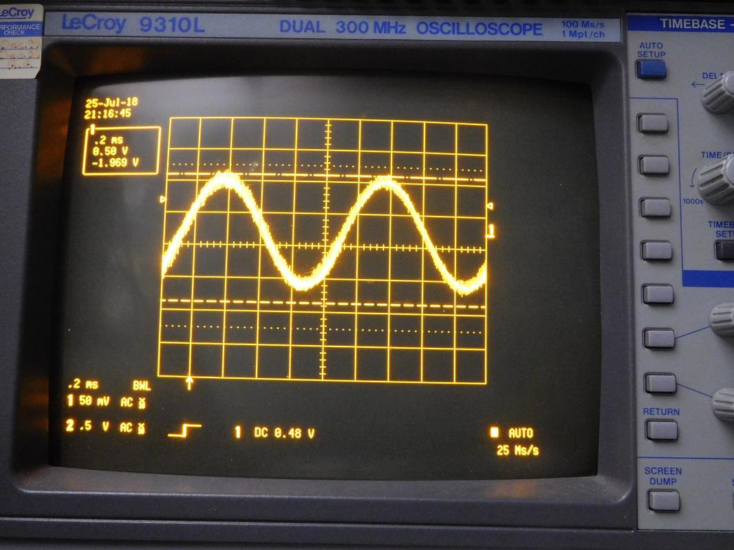

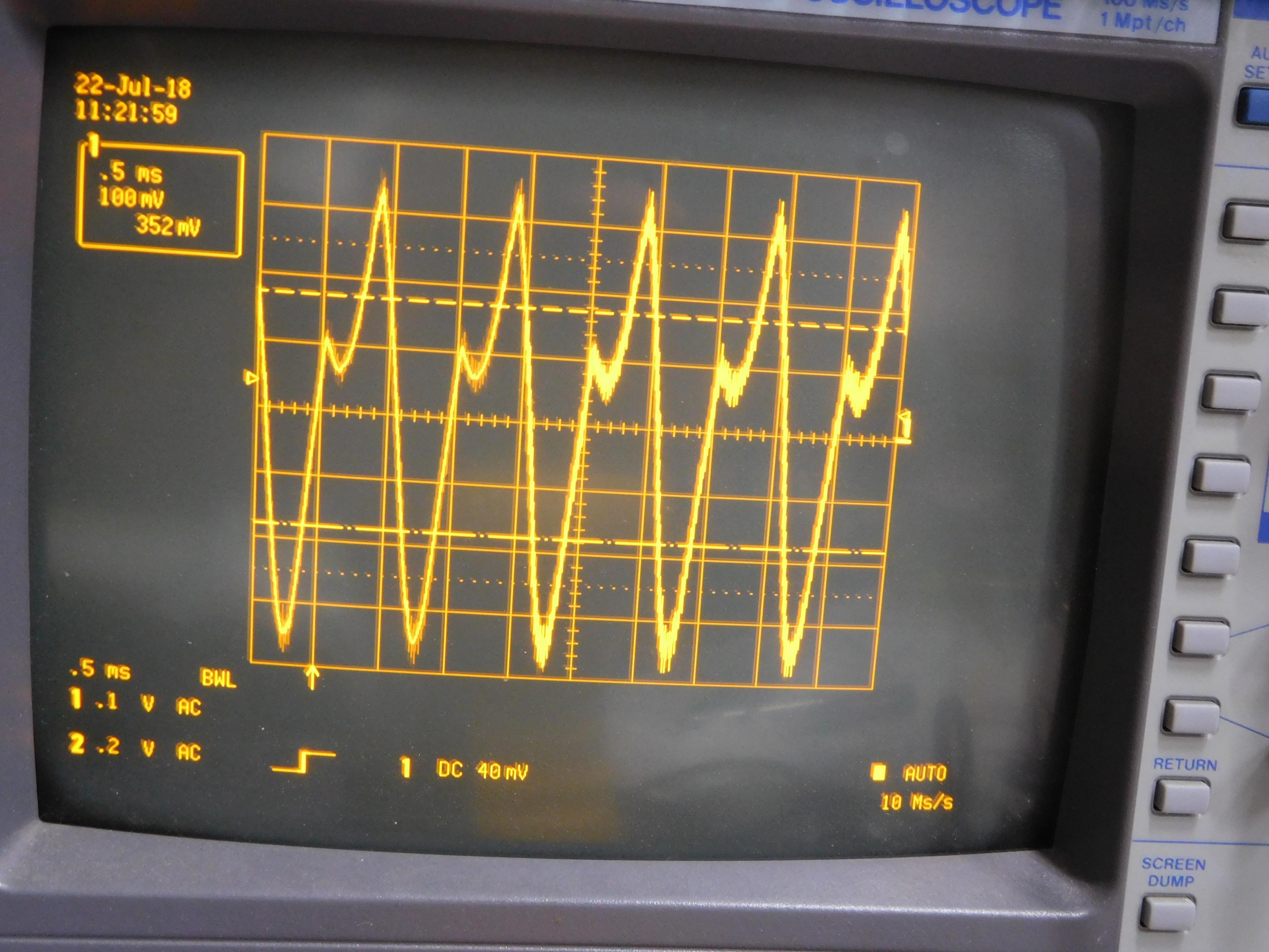

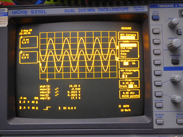

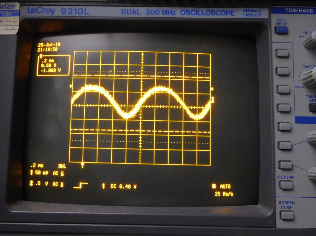

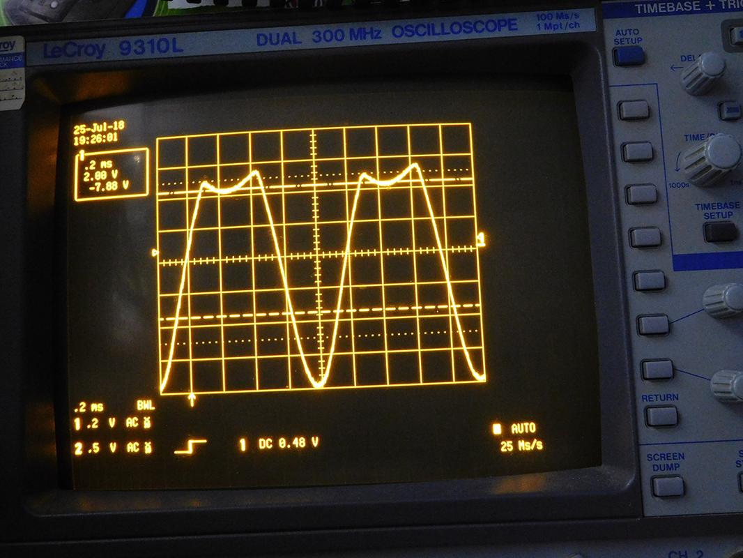

I have a Sonic Frontiers Power 2 on my table, the problem is a strange distortion on left channel. The fist interchange the tubes from left and right channel, the problem it the same.. on C28 with only R ch there is a normal sine wave without distortion, in the C29 there is a orrible wave, you can see on the picture, more and the signal is more high that other channel, but in a video there is another strange problem... when I put in signal in Right channel, the signal out in another channel ( left it's more low) but I put signal in a Left channel the signal go out also from the right .. more low this is a strange..

Have you try apply the input via the differential (BNC) input. Could be a grounding problem in the un-balanced RCA input connector.

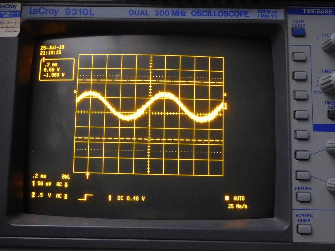

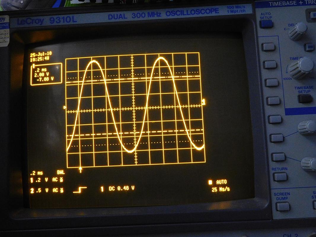

Hi, I tryed in balanced, and unbalanced, the same problem. Trying with only R channel I can see a normal sine wave on a pin 3 (grig) on V2 Tube 1 Volt amplitude, the same misure on the other channel, and on pin 7 (catode) on V2 Tube there are 4 Volt normal sine wave.
On pin 7 in the other channel ( fail channel ) I measure a distorted wave with a 15 Volt amplitude !!!
you can see the picture.

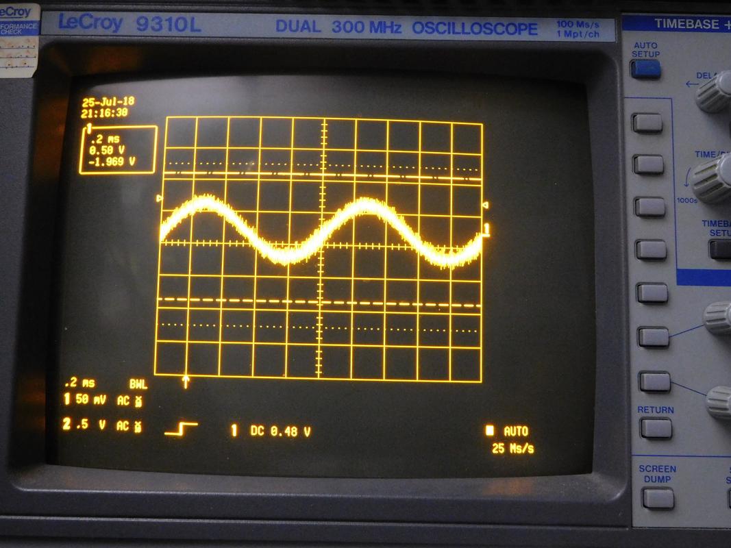

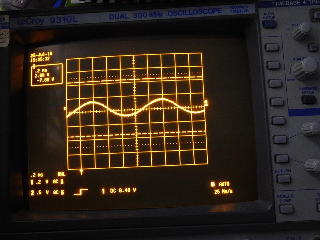

The correct measure are :
CHANNEL FAIL V3/1 pin 1 (plate) 134 V pin 2 (grid) 2.5 V pin 3 catode 5.7 V
pin 6 (plate) 127 V pin 7 (grid) 2.8 V pin 7 catode 5.5 V
CHANNEL OK V3/2 pin 1 (plate) 131 V pin 2 (grid) 2.7 V pin 3 catode 6 V
pin 6 (plate) 127 V pin 7 (grid) 3 V pin 7 catode 5.7 V
the scope measure on the plate, and catode with the same signal

on the board, fists 4 tube are: V1 V2 V3 V4... but in electric diagram there are V1 V3 V5 V7
my measure are the same of the electic diagram !!
the second thing is: on a socket of V2 there is soldered, a serie of capacitor an resistor (on the board) or V3 in electic diagram, but there isn't in a diagram ...

To my opinion the problem is around this tube...
I hope that I'm cleear in my explain. Thank you for your help !

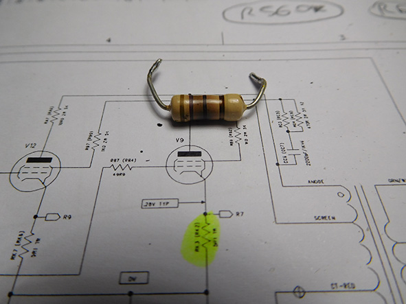

There is apparently a mod to the screen supply regulator, it‘s probably not your problem but thought I’d bring it up.
But the first 4 tube are triode, there isn't screen grid ! the problem is on second tube from input

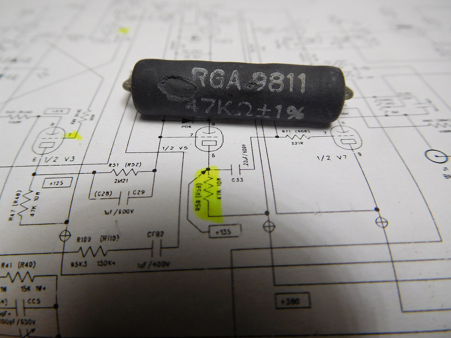

Yes I saw it, someone have repaired this amplifier before.. ans that resistor is wrong i measure it 47 ohm .. the correct value is 5 ohm, I go to replace it, but that channel it's ok che fail is the other..
Hi guys,
I found the problem, the main problem was R59 V5 plate resistor was broken, and in second into the other channel RA8 situated of V7 plate, it had been replaced before my reparation, with a wrong value, you can see the pitcure 10 ohm .. but it's more long of his value, with the multimeter I read 47 Ohm, but the correct value was 5.1 Ohm.
Replaced these component .. the output is perfect ...
