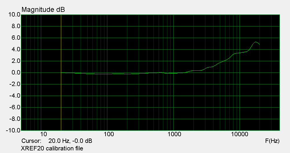

This is my XREF20 calibration file which is a bit different to TBTL's so it would seem that the claim for them to be individual is true. It works for me and I have compared measurements I took of a TC9 driver to many others posted and they all agree pretty well so I feel confident it is not too far out of cal.
I made my own 90 degree file following this method and it works well
How to make a 90 degree calibration file
You can apply the same method to create your own calibration from a known good mic as well. Simply take a measurement with each mic, keeping everything as equal as possible, normalize the amplitude around 0dB and subtract one from the other to generate a calibration. Recheck with both mics and you should find that they both produce surprisingly similar measurements.
So, after ten days of waiting and four e-mails sent to Sonarworks we can recognise case is closed. Support didn't respond.
When I was buying mic for measurements I wondered if Dayton can randomly generate correction files for their mics because it's big company and probably they need reduce cost of business. I thought Sonarworks is smaller so it's more trustworthy. But as you can see I was wrong. Calibration files from Sonarworks are useless and Dayton seems to be much more reliable company. Their calibration files "match to my ear experience" and I was surprised when measurements with mic pointed directly to speaker and with mic angled 90 degrees are almost identical when they are used with proper calibration file. Because of that I suspect they make real mic measurements.
If you buy cheapest Behringer ECM8000 without calibration and use it for speaker measurements then you get as reliable results as with XREF20 and attached calibration file. So it's not worth to pay extra money for XREF20.

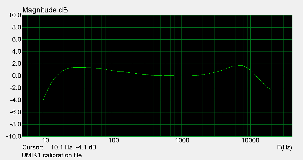

If you have opportunity to lend Dayton mic then you can very easy make your own calibration file with ARTA software to any microphone without calibration file like Behringer ECM8000. I did it for my XREF20 using UMIK-1.
Below are calibration files for UMIK1 and my XREF20.
Argh! When I was talking about Dayton I meant miniDSP. I don't know why I made mistake with UMIK-1 producer. Of course it's produced by MiniDSP. Sorry for my mistake.
But unfortunately UMIK-1 is USB mic and it cannot be used with ARTA in dual channel mode. For me it's good only as reference mic to make calibration file for classic XLR microphones.
That's exactly what I use the UMIK-1 for, but I do so with a calibration file from Cross-Spectrum (..based on the ACO 7052E).
(..I'll also use it as a sound meter at 1 kHz with it's own calibration file.)
If the graph on 1st graph is true and would repro when tested against another known microphone, then it could also be a matter how Sonarworks mounts the microphone when they calibrate it.
One would calibrate it against reference microphone... the correct way would be to
a) take a measurement with REF mic
b) remove REF mic
c) put the tested mic at precisely same location
But for speed and convenience one could also do it by
a) setting REF and tested mic side by side with tips almost touching
b) make the two measurements
The difference will be that in most part of the spectrum calibration would be correct, but somewhere >10kHz the response would probably rise inaccurately as now one had basically 2x 1/2'' diameter in the sound field instead of only 1mic diameter... and that will make a difference.
I have compared those two methods in past and this was about the difference to be expected.
