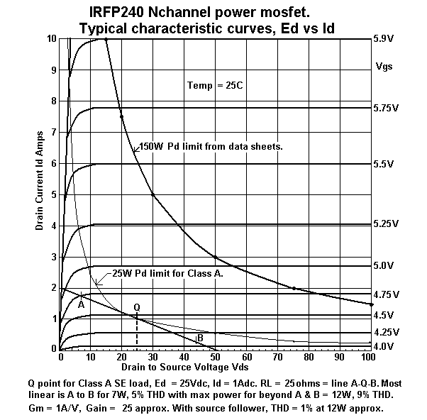

The main reason for posting in this thread is to find out if the SOZ is possible to build into my existing enclosure without burnig up, or sound to bad.
My enclosure is about the size of the 5U.

My enclosure is smaller, about same size as standard FW.
How much can the standard FW dissipate?

My F2 is a "sissy" version with only 20VDC and 2A Ids -> total 80w dissipation.
Can keep hands on for 1min.
Don`t have to much space for it in bench, so gets a little warm. 🙂
Zen: Trying to find "then a little back" without amp and house meltdown.. 🙂
Looking at F1 article, the F1 dissipates 100w each channel, total 200w.
Think your answer is about spot on 2pico.
If using Arcol resistors for the 8ohms in SOZ, is there a rule of thumb for power rating?
Is 100w power rating enough with mentioned enclosure and about 100w dissipation?
Think the Arcols can handle max temp of 200`C.

When looking for toroid only finding 2x9v 300VA, 2x12v 300VA and 2x12v 400VA.
2x12v will give almost ~16VDC.
Trying to calculate dissipation with 10ohms instead of 8ohms with my simple math knowledge.... 🙂
I already have 10ohm resistors. Will try calculate with 16VDC rail.
In article IRFP have about 20w dissipation, same as 8ohm resistor have about 20w dissipation.
Can then say 8ohm for IRFP.
If using 10ohm resistor IRFP will have a litle more than 8ohm.
Calculate R = 10ohm + 8ohm + 1ohm + 10ohm = 29ohm
Ids = U/R = 32v/29ohm = 1.1034A
Total Ids = 1.1034 x 4 = 4.414A
Total dissipation for the amp both sides:
P = U x I = 32v x 4.414A = 141W
Will probably be a littlebit less dissipation since IRFP will have a little more resistance.
Than add dissipation from rectifiers and toroid.
Is this correct or do I have to go elementary school once again...... 🙂
Found attached curve for IRFP240 after searching for a while.....
As its mentioned:
"For those wondering about IRF mosfets, here are some load lines I have re-drawn from the IRF data
sheets which are actually hopelessly inadequate for most people who wish to use the mosfets with low
drain supply voltages and high idle currents for class A."
solidstateamps5+tube-input
