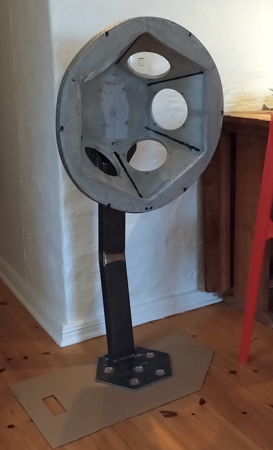

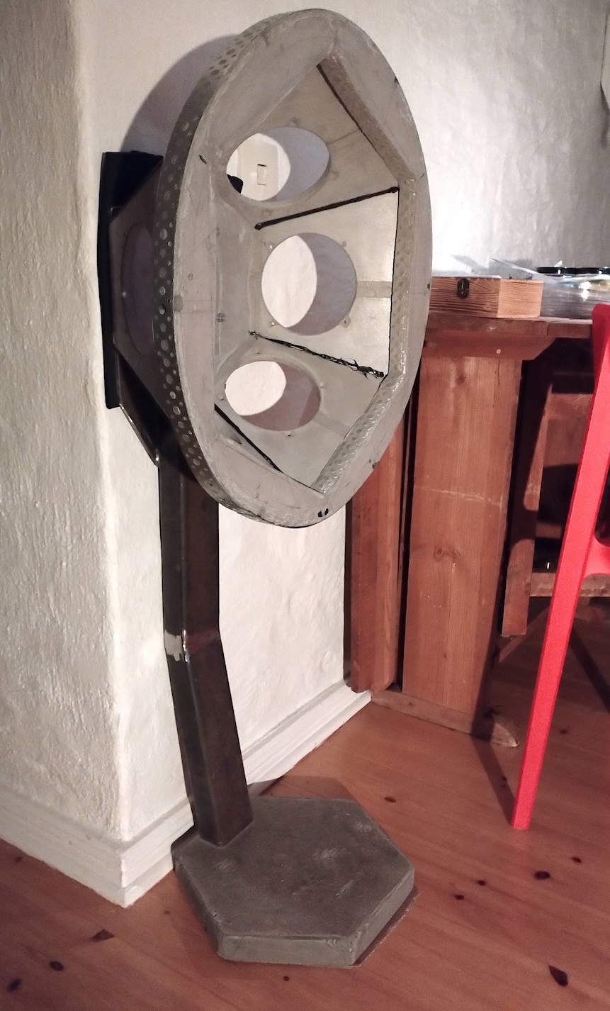

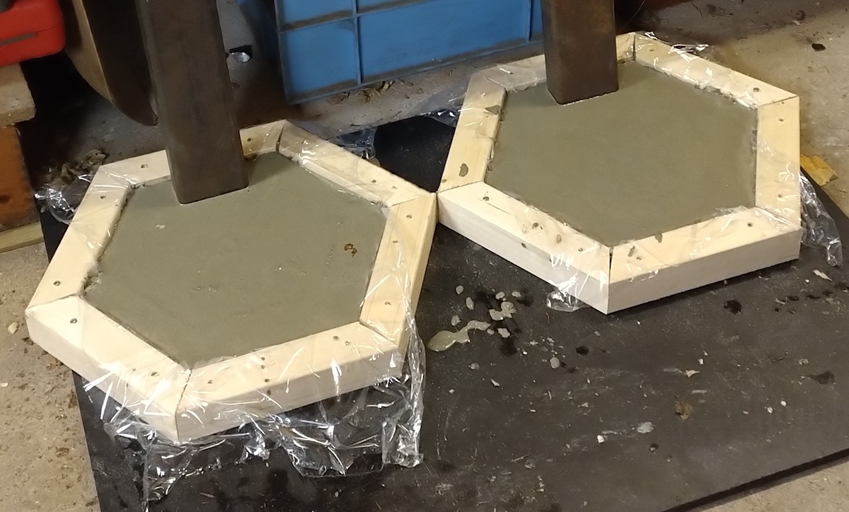

Received the stands. Not completely acc to supplied drawings byt it will be OK once I add the concrete to the foot. Its actually quite stable as mounted on the picture but there are big pieces missing of course... 😉

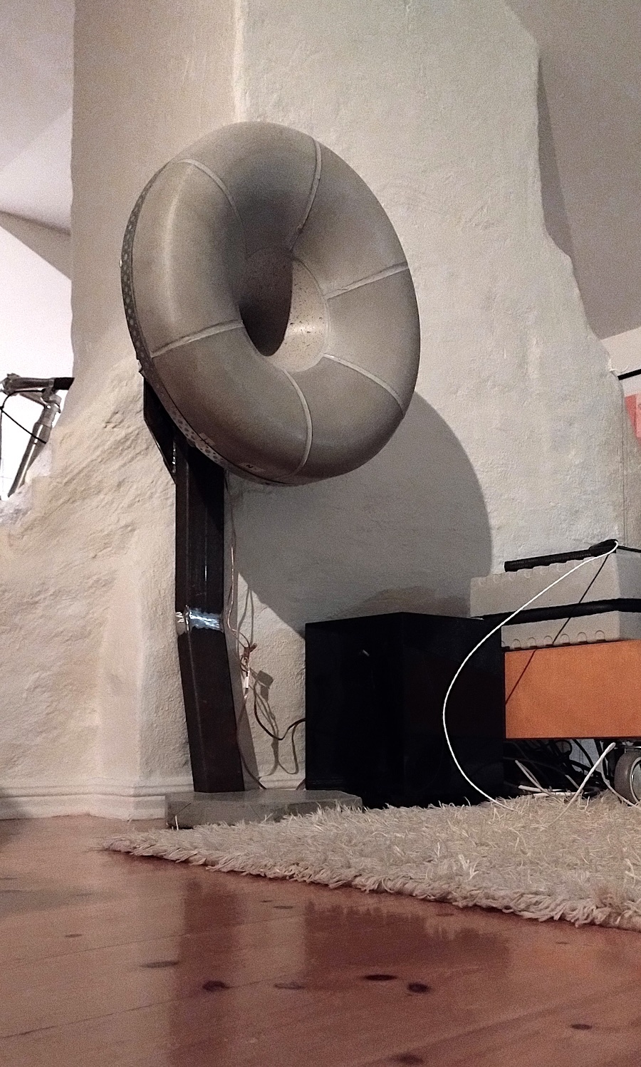

And while waiting to assemble the second bass basket I play them sitting on the floor with one of the old bass boxes. Sounds really nice and interesting - it's a thrill to hear old and new records. This is how it measures in the listening position. It was a much easier EQ than the old ones - promising.

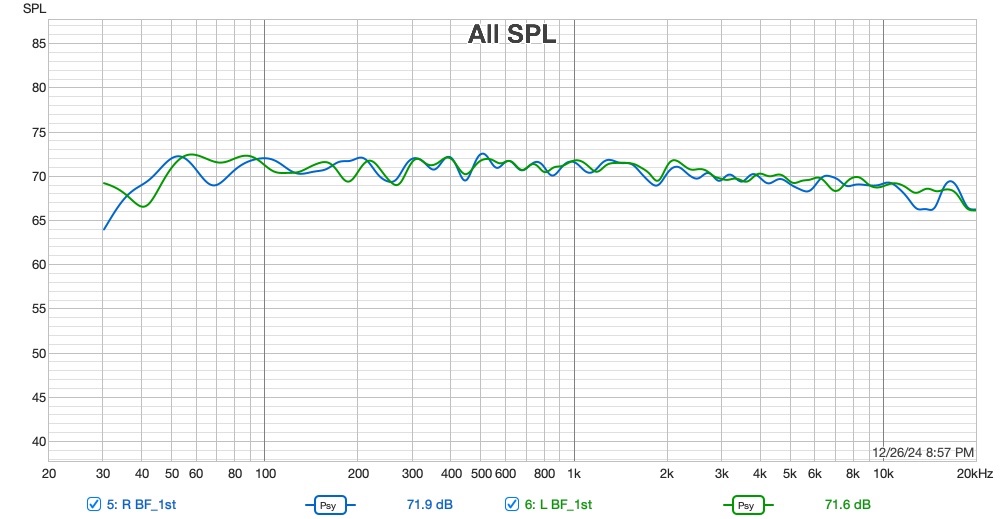

Un-EQ'd. L complete, R with old bass. Surprisingly similar still... I think XO was set to 1400 + old system gain settings... well... 🙂
Once the speaker is on its intended wall position, I hope/plan/think/know they will gain energy on both sides of the peak at 170Hz 🙂

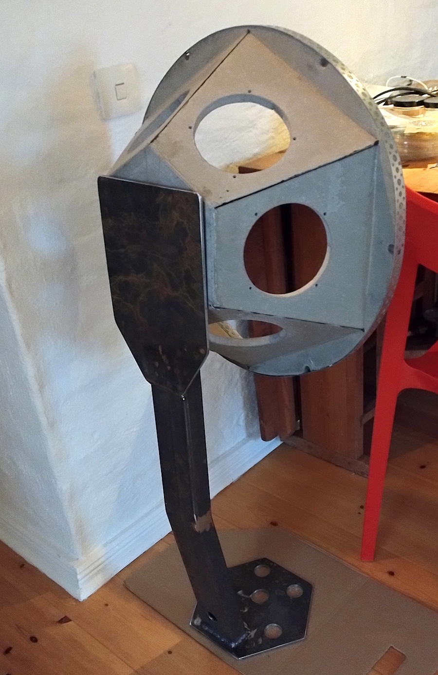

Stands pedicure... 20/80 prototype style..
Looks amazing. Gorgeous design. But those 4 bolts holding the heavy concrete flower on the stand... I think that might be a failure point in the future. Any way to affix a metal plate across those 4 bolts to distribute the stress?
Edit - ahh, never mind. Now I see from previous pics that you embedded plates in the concrete.
Foot. Now to assemble ch2. And a second person to aid mounting on the stands - I dont dare doing it by myself... even if I'm very tempted 🙂

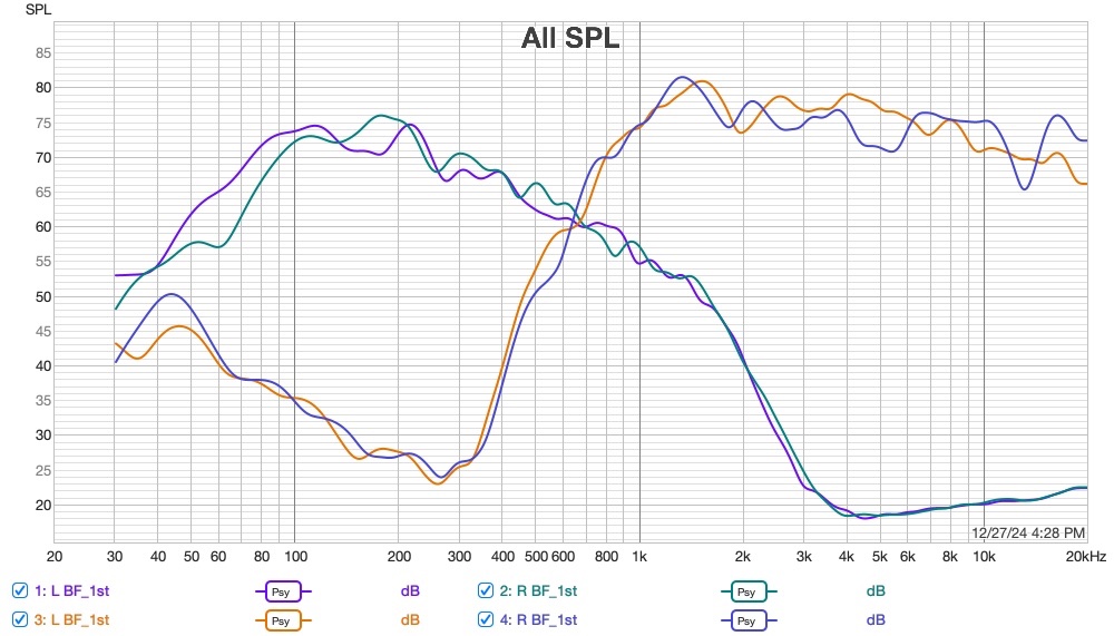

@TNT: I think I’m right in saying that your aim is to create a virtual point source by using DSP to delay the horn output. A listener who is on-axis with the horn will not get any on-axis radiation from the woofers - it will all be reflected radiation, albeit time corrected. I’m guessing you have already thought about this and I’m interested to know if you think this will have an impact on your point source objective? ( This is not a snide comment - I think this is a very cool project ! )
@Studley What you say above about "on axis radiation" of the woofers is not correct. Yes, they are not pointing at the listener, but any driver radiates sound like a monopole (e.g. outwards in all directions) at a low enough frequency and only transitions to directional behavior above some frequency related to the cone diameter. These relatively small drivers (6" I think) are not directive until around 1kHz (see https://www.audiosciencereview.com/...r-beaming-frequency-formula.23816/post-804690) and produce a direct, on-axis sound pressure that will not really be much different than at 45 or 90 degrees off axis. Also, the design of the woofer section is sort of horn like when the speaker is backed against the wall, so I would expect that even up to almost 1kHz the sound pressure directly in front of the speaker will be very usable. The question is really at what frequency does this behavior start to break down and can the horn+driver be crossed over that low.
Thanks for your interesting comments and questions - these are also on my mind. I will measure the individual sections by themselfs - EQ and unEQd - and at least one octave beyond its intended pass band. And of course also directivity for the mentions cases. It will be interesting.
I'm hoping for a point source behaviour which I think will need a delay of the horn/HF section to meet the LF. What I heard form the SOundflowers, it seem to integrate fairly well but I hope for an even better one as I can push the XO down here. 1K seems absolutely feasible from what I hear now albeit a bit experimental setup 🙂

Thanks for the explanation Charlie. I guess I was confusing direct radiation from the woofers (which in this case is blocked by the horn) with on axis SPL, which is what actually matters.
