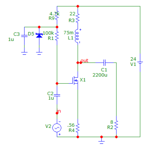

SOMOS. Sound of One MOSFET Headphone Amp
One MOSFET and One resistor ...
This amplifier is for you who have a headphone: 8, 16, 32, 60 or 64 Ohm impedance.
The trafo is 2x12VAC.
The MOSFET can be any TO-220 or TO-247.
For example IRFP240, IRFP140, IRFP044, IRF540. (IRF520 and IRF610 gives a little more distortion = more MOSFET sound)
The resistor should be 5 Watt.
If you have some MOSFET laying around, this project is for you.
You get good use of your MOSFET.
I have not built it. But the SPICE test shows it is a good, solid and fun design.
It works 🙂

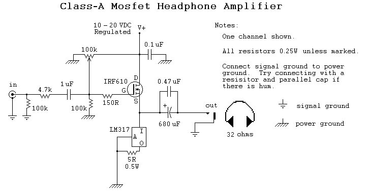

Reminds me moosefet circuits...
Reminds me a bit of the Szekeres amplifier circuit posted long ago on Headwize. I believe biasing was handled differently with that one, though. There were several alternate versions of that circuit explored in footnotes and addendums, including a DC coupled variant.
Edit: looks like someone posted one of the variants from Headwize above, so I'm late to the party.

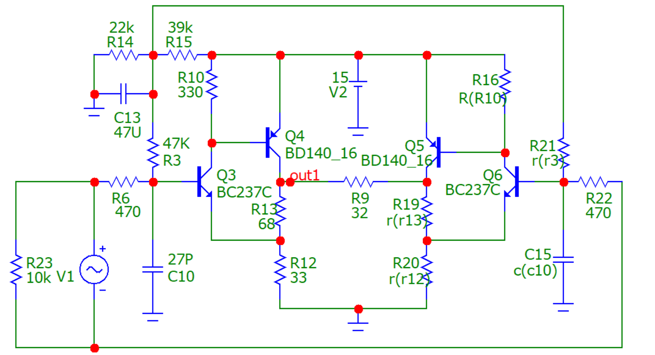

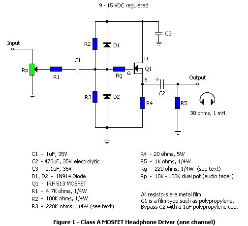

Hi All,
I started to look for something simple I can (re)start my DIY journey with, and found two intriguing "projects", looking very similar to each other...
Comparing this hybrid HP amp using a FET and a tube with the right side picture with a single FET from @adason 's post above, my question is, what is the advantage adding a pre-stage(?) like a tube, or another FET to the single component apmlifier already capable of driving a headphone?
What do they bring to the table?
Thanks!
Reactions: lineup and cumbb
Hi All,
Thanks!
One answer could be: A follower as shown (both pics: mosfet foll.). Simply: some sources are not loud enough to achieve the desired high levels with a follower.
The advantage of followers: they do not "distort" audibly relevant, compared to "amplifiers". The best, simplest followers sound very pure and almost magical. But an additional amplifying stage also has disadvantages: Adding signal modulation through parts characters due to material, shape, size, mass, diameters and more.
Reactions: habosmakos
With FET or Tube in front there will be an impact of the sound.
If it is for the better is questionable.
I say if you do not need some voltage gain, one MOSFET is enough.
For 8, 16, 32 or 60 Ohm headphones there is usually no need for Vgain.
Thank you very much indeed!
I might step up my headphone to higher Ohms so I will have an excuse to add parts for the gain...
