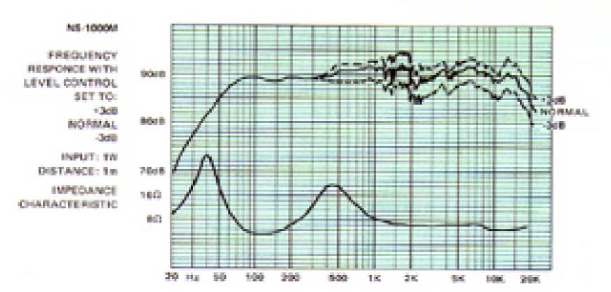

Given the fact that tube amps have smaller damping factors than SS amps, a quick look at the uploaded impedance curve suggests it might be prudent to treat those Yamaha speakers as being 6 Ω and derate them to 88 dB. sensitive. Good control of the woofer voice coil is quite important in avoiding "sloppy" bass.
Per Paul Joppa's 102 dB. rule of thumb, amps of 30 or so WPC will be suitable. Push/pull circuitry built around either the EL34/6CA7/KT77 group or 7591s yields the power necessary.

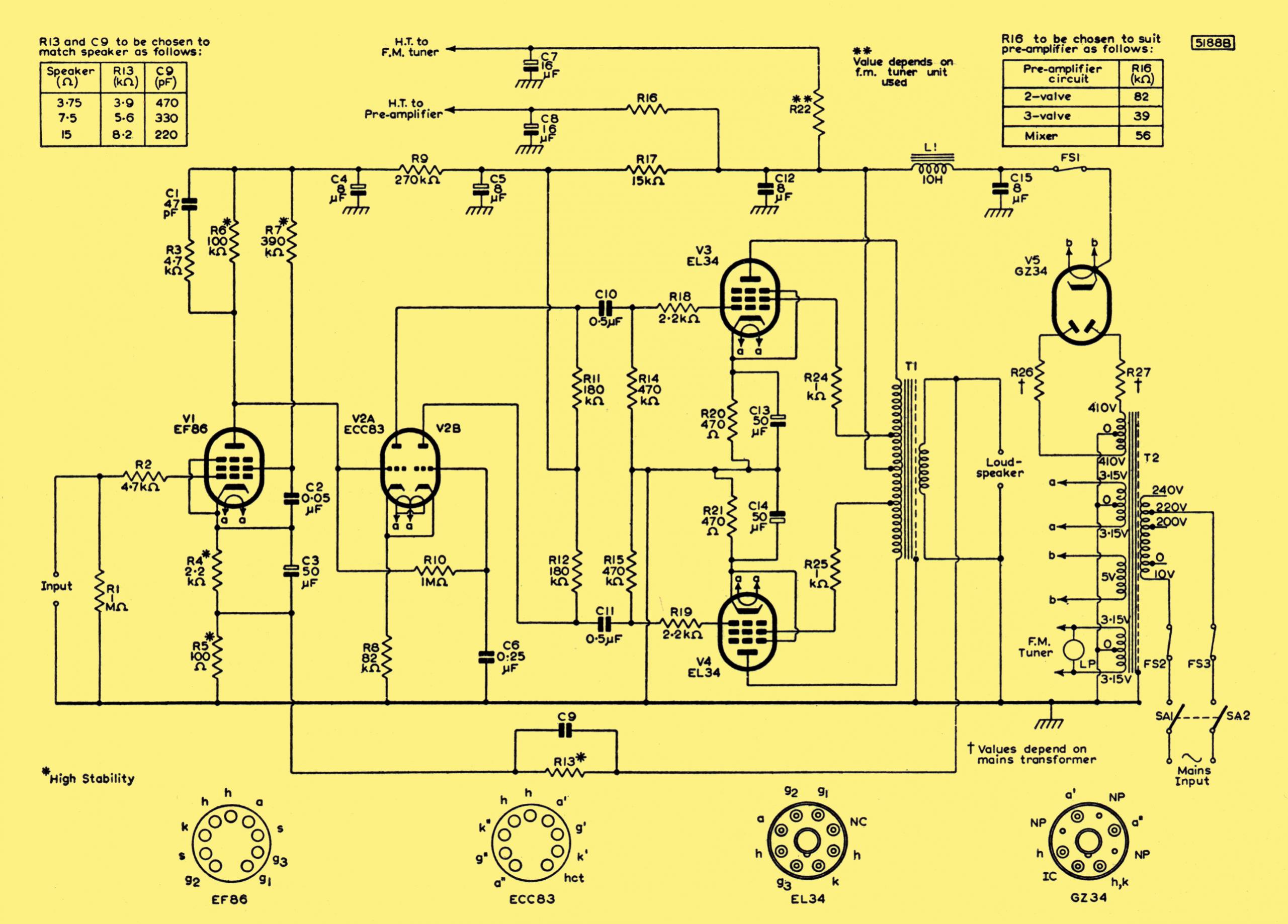

The very tried and true Mullard 5-20 topology, with some modernization, combined with 4 KOhm primary O/P "iron" and "fixed", as opposed to self, biased "finals" would also do nicely.

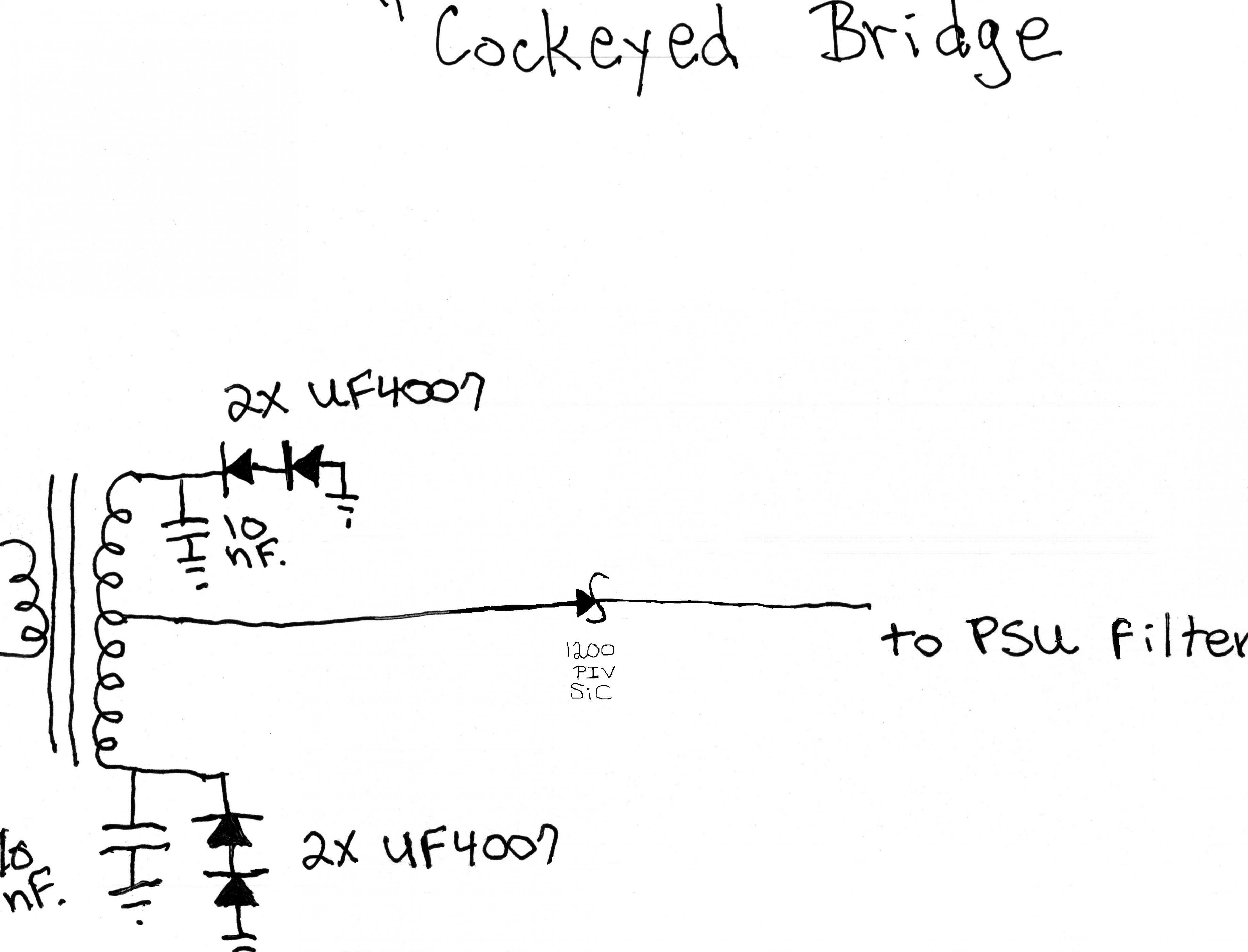

What I call a "Cockeyed Bridge" will be used for the B+ rectification scheme. It's an economical way to obtain the "zero" switching noise benefits of Schottky diodes. Actually, close examination will show the setup to be FWCT, with an "extra" diode. That "extra" diode (here a high PIV Schottky) keeps PN diode switching noise out of the PSU filter. 😉
Take a look at the 7591 data sheet to start getting a feel for operating conditions. Ultralinear mode push/pull pairs operating in Class "AB1" will be employed.
